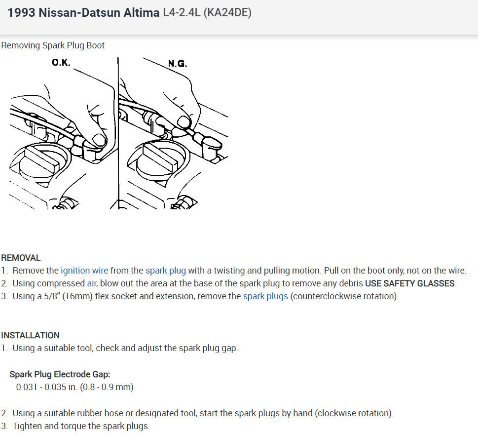

my car idles rough but not all the time,seems like mostly when my gas is low, but not sure. sometimes it will run for a week perfect then somtimes it misses out for 2 days straight, it dosnt die but it idles will rough but drives decent on highway.

Check the auxiliary air control valve this is the one that controls the idle speed.

I would replace the fuel filter, this can become clogged and cause this issue. Also, I would change out the spark plugs and plug wires and service the throttle body, this guide should help fix it.
https://www.2carpros.com/articles/repairing-engine-rough-idle-issues
For a 1993 Nissan Altima, the recommended spark plugs are NGK V-Power (BKR5E-11) or Denso (K16PR-U11)
Check out the images (below). Let us know what you find.
