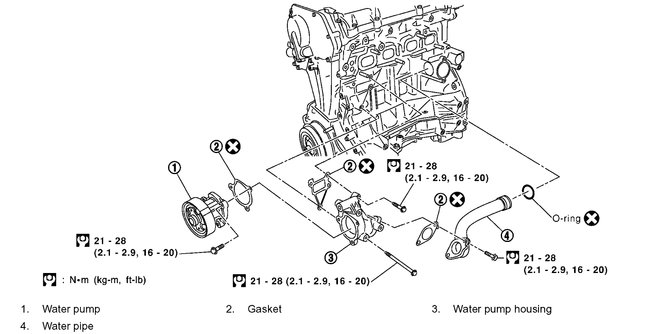

Hi
my car started overheating and i took it to a mechanic who took out the thermostat and replaced the radiator cap. A month later it started overheating again and replaced the water pump. After doing that and bleeding the coolant system the car is still over heating. The head is not blown. when i feel the radiator pipes the top pipe is extremely hot and the bottom one leading to where the thermostat was is ice cold and does not get hot. Even my car heater doesnt get hot anymore. they checked the entire system for blockages and they said they no blockage anywhere. Please can you perhaps tell me what the problem could be
Apr 24, 2010 at 1:38 AM
  • 55,423 POSTS
It sounds like the water pump impeller has fallen off the water pump, I would remove it to confirm the failure here are two guides to helps walk you through the repair and diagrams below to show you how the job is done on your car.
https://www.2carpros.com/articles/water-pump-replacement
and
https://www.2carpros.com/articles/engine-overheating-or-running-hot
Check out the diagrams (Below). Please let us know what you find. We are interested to see what it is.
