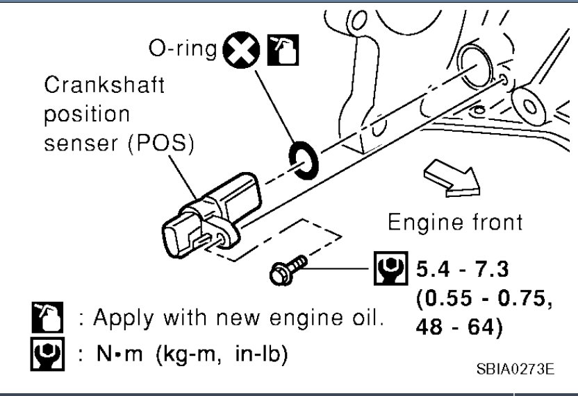

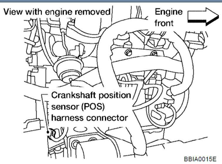

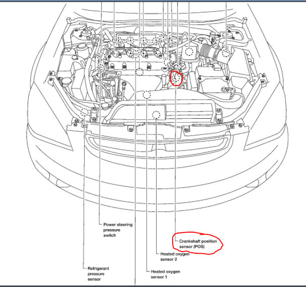

i have the car listed above it is a 2.5 liter. i cannot find the crankshaft position sensor. there are so many different plugs in there. do you have a picture of where it is?

Here is a tutorial showing how to replace a crankshaft position sensor:
I've attached pictures below showing the sensor location on your car and circled in red. Hope this helps and thanks for using 2CarPros.
