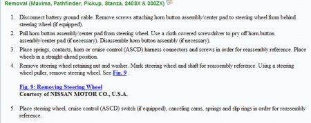

My car runs good but sometimes the stering whell locks yesterday I was on the highway and it locks I can not turn the stering wheel and a light come up the antilock, and after that before I use to just stop the car and restarted and yesterday that didn't work can you help me
Jan 23, 2008 at 1:35 AM
MERLIN2021
  • 17,250 POSTS

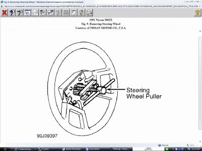

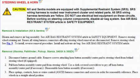

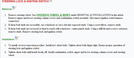

If the wheel locks, you most likley need to replace the Ingition lock...here's how...
https://images.2carpros.com/forum/automotive_pictures/62217_SteeringWheel_1.jpg
https://images.2carpros.com/forum/automotive_pictures/62217_Wheel_1.jpg
https://images.2carpros.com/forum/automotive_pictures/62217_Steering_1.jpg
https://images.2carpros.com/forum/automotive_pictures/62217_Wheel1_1.jpg
Tighten wheel nut to 22-29 ft lbs...
