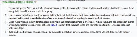

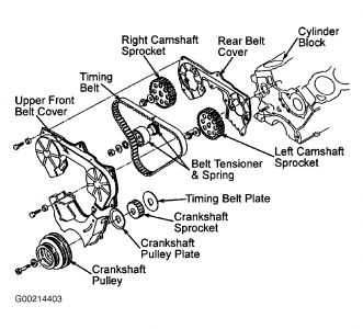

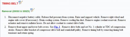

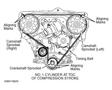

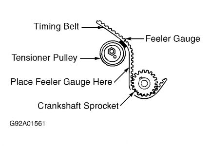

Do a compression test, this will tell you if anything was damaged, if the belt is off by a tooth or two...recheck the timing, your friend knows how to find number 1 TDC? If the crank or cam was rotated with the belt removed, engine was damaged, This is an interference engine.
