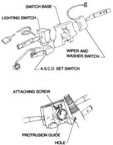

How do I remove the old switch ? Do I have to take the steering wheel offf , and if so how is that done ? Thanks

Steering wheel does NOT need removed. Below are replacement procedures.. REMOVAL/INSTALLATION: Remove the steering column cover. Unfasten the wiper switch electrical connector. Remove the wiper switch-to-combination switch retaining screws, then pull the wiper switch from the combination switch. To install, reverse the removal procedures.
