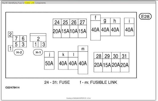

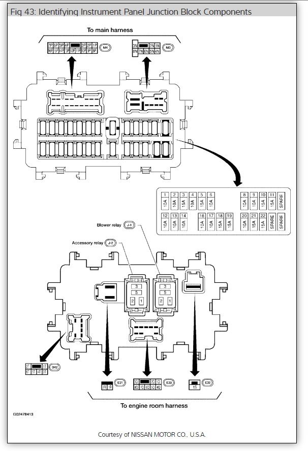

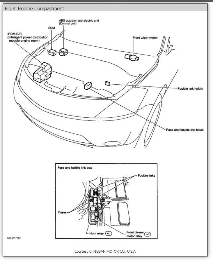

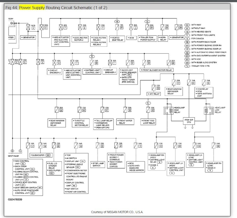

i have a 2005 micra which the rear wiper does not work is there a fuse somwhere as i have checked the fuse box and all fuses are ok but rear wiper is not listed there
Nov 25, 2006 at 2:17 AM
  • 55,423 POSTS
I have found some wiring and fuse box diagrams (BELOW) for you to do some testing, here is a guide that will help you out.
Please run some tests and get back to us so we can continue helping you.
