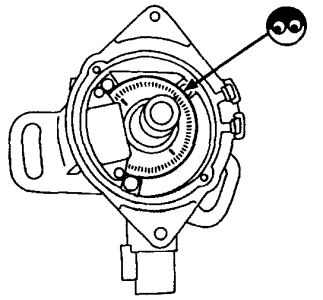

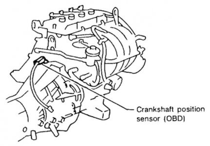

i just want to know how to change the camshaft position sensor on my car and also i would like to know where is the crankshaft position sensor on my car located? thanks
Apr 27, 2010 at 12:58 AM
  • 75,992 POSTS
CAMSHAFT POSITION SENSOR 1.Remove distributor from engine. (Camshaft position sensor harness connector should remain connected.) 2.Disconnect ignition wires. 3.Turn ignition switch "ON". 4.Rotate distributor shaft slowly by hand and check voltage between terminals "c", "d" and ground.

If NG, replace distributor assembly with camshaft position sensor.
https://images.2carpros.com/forum/automotive_pictures/12900_cs1_4.jpg
5.Visually check signal plate for damage or dust. Crankshaft position sensor location

i checked my crankshaft position sensor location,but i found that my car has a s13 tranny instead of a s14 which it doesnt have a cps on the s13, my question is will i have any problems passing smoke check because of not having the cps on my car?
May 1, 2010 at 10:56 PM
  • 75,992 POSTS
Try to get the emission test w/o the CPS and make sure the CEL comes on and goes off when it suppose to and see what happens.
