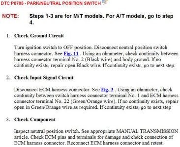

1996 Nissan 200SX TRANSMISSION RANGE SENSOR P0705
1996 NISSAN 200SX
202,000 MILES • 4 CYL • FWD • MANUAL
NISMO236
I DONT KNOW WHY THIS CODE CAME UP WHEN MY CAR IS A 5 SPEED I HAVE NO CLUE NEED HELP PLEASE
