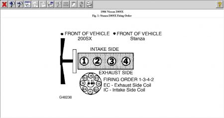

What is the firing order for a 1986 Nissan 200 sx? It is a four cylindar engine with 8 spark plugs/

https://images.2carpros.com/forum/automotive_pictures/12900_fo_73.jpg
