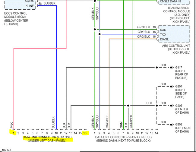

My OBD Port is not working.
Apr 17, 2022 at 10:51 AM
  • 110,244 POSTS

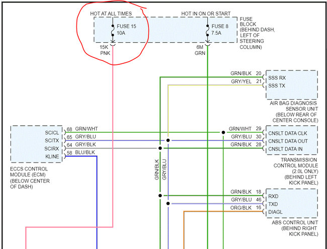

First, I need you to check fuse 15 in the interior fuse panel. If it is good, confirm it has power to and from it. Here is a link you may find helpful:

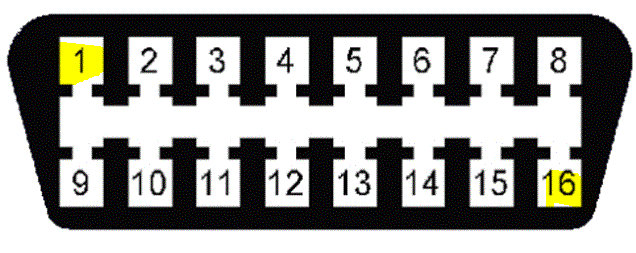

If it is good, I need you to go to the OBD port and check for 12v at pins 1 and 16. Additionally, confirm pins 12 and 13 have continuity to ground.
I attached a wiring schematic of the circuit below and a pic identifying each pin number.
Let me know what you find.
