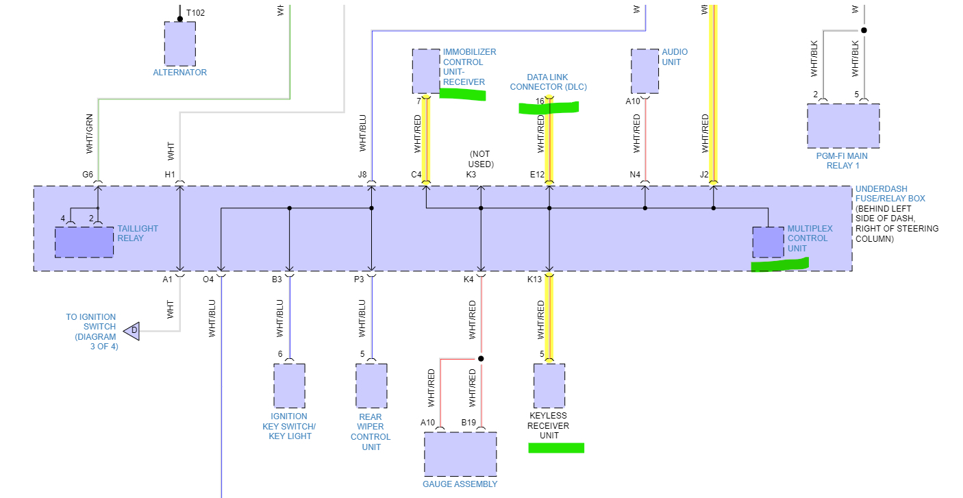

Hello, the green key flashing is the security system. The immobilizer is keeping the vehicle from starting. It will probably need to be reprogrammed. With this many problems it sounds like you may have a bulk connector in the wiring harness that may be corroded. I don't think you would have that many components fail at once. The immobilizer is linked with a lot of vehicle systems. You should probably start checking all the main bulk connectors as well as the ECM connector. The ECM on these is down under the passenger side of the dash. When you get communications back, you may still get the Intake manifold runner codes. Unfortunately, because the intake on these is plastic and so is the IMRC, it tends to warp the intake manifold. The intake is usually replaced with the valve assembly.

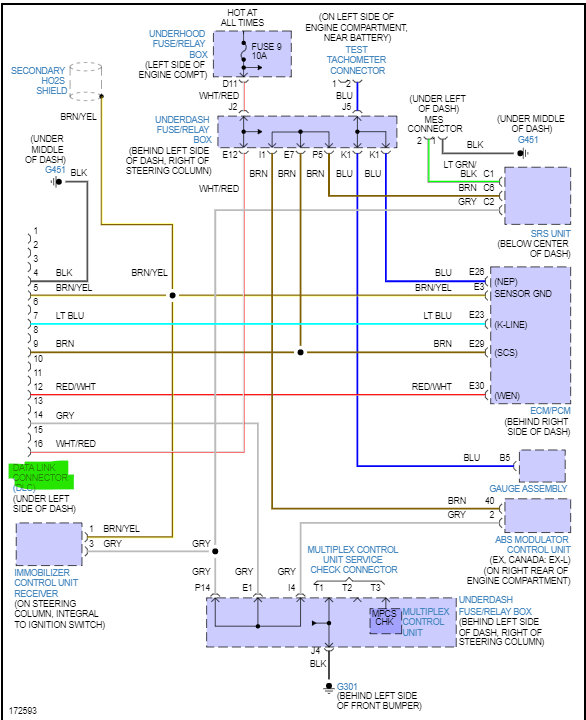

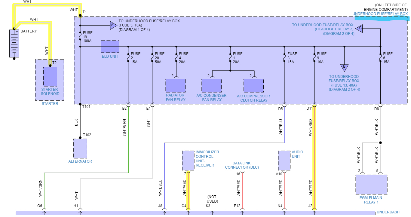

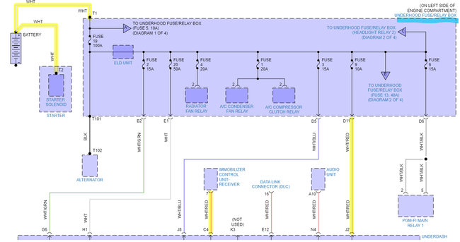

But as for the security system, it may be losing its keep alive memory, on the diagram below you'll notice the Immobilizer, Keyless Receiver, Multiplex Control, are all on the same constant power feed.
From the battery to the under-hood fuse box, to the under-dash fuse box. It's all linked together. You may be losing power on the feed causing the security system to lose its memory or not get powered up. The multiplex control unit on these go bad too, causing issues with the keyless entry.

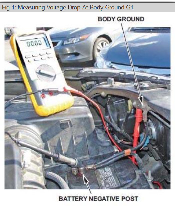

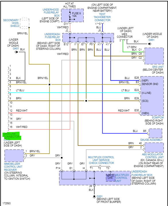

But checking that this circuit is staying powered up would be a first check, you'll also notice that power for the Data Link Connector (DLC) is on this feed as well, that would explain the no communication issue too. Pin #16 of the DLC should have 12volts. Pin #4 is the Chassis Ground and Pin#5 is ECM and sensor Ground.

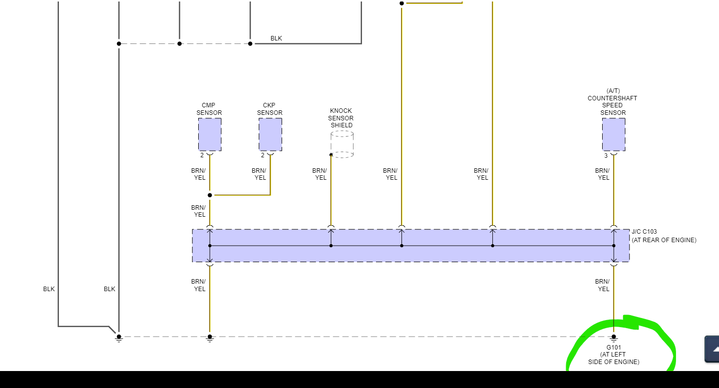

So, if you can track the power feed from the battery along this circuit, you may find a corroded connection or some other issue along the way. The third diagram is the data link connector pins.

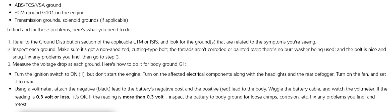

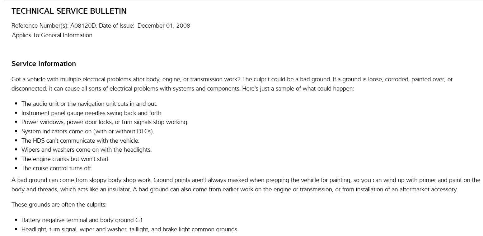

The Ground G101 has a Technical Service Bulletin on it to for causing all kinds of electrical issues after repairs.
