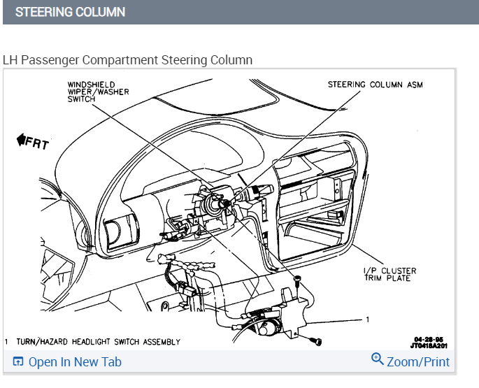

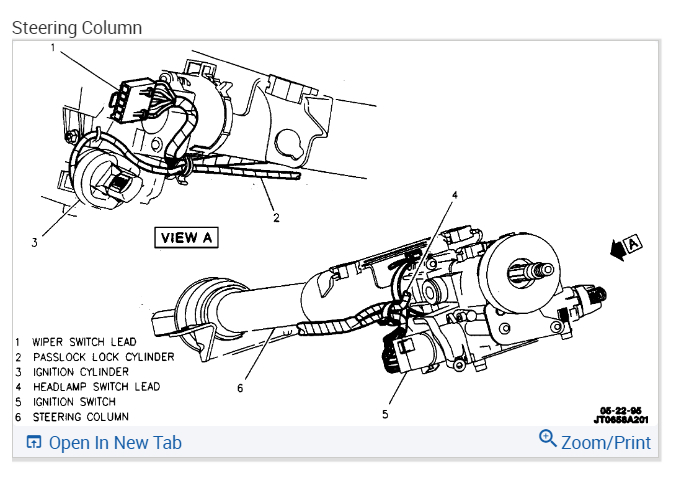

I need to change out the steering column of my car listed above, what would be the good age range that's interchangeable for that part?
Aug 28, 2023 at 3:16 PM
  • 55,399 POSTS
For a 1996 Chevy Cavalier, the closest model years to consider for interchangeability might include:
1995 Cavalier
1997 Cavalier

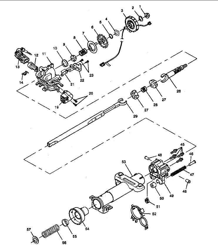

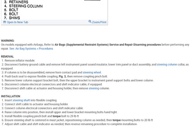

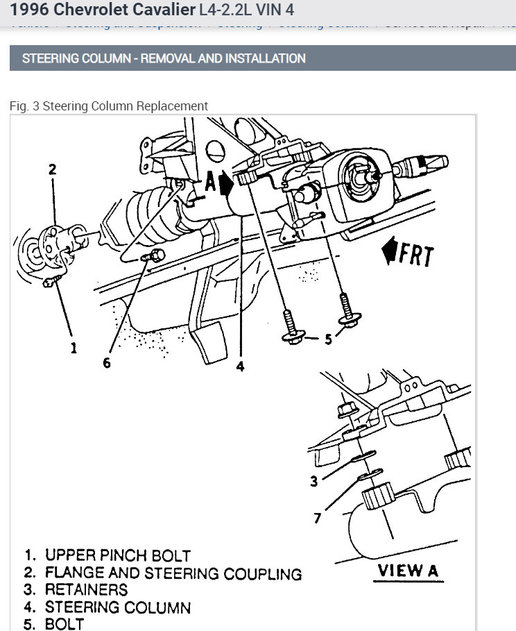

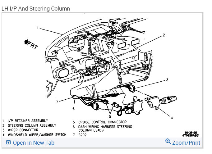

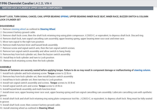

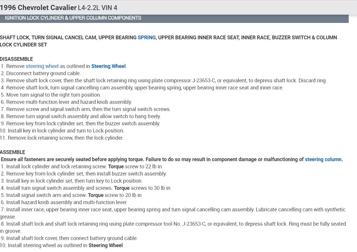

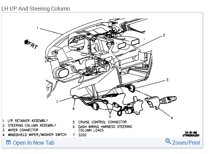

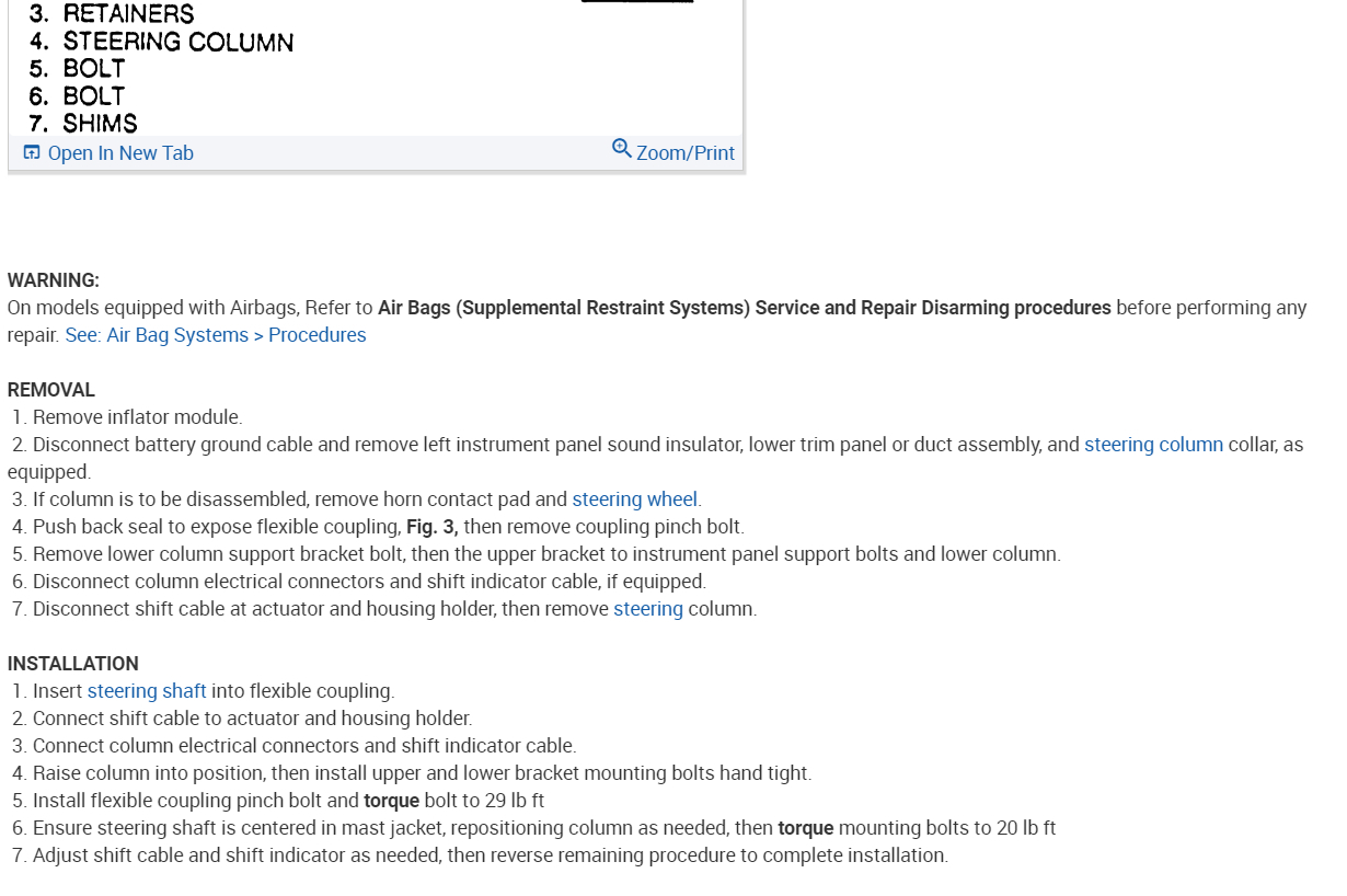

Here is how to change the steering column out in case you need it. Check out the images (below). Please let us know if you need anything else to get the problem fixed.
