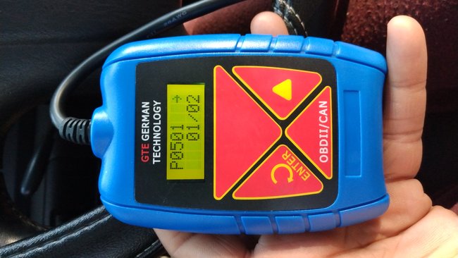

Well, one day back and the CEL is back on. I happened to be by the shop and ran in to tell the owner. He said to bring it in first thing in the morning. Back home I used my scanner and see attached.

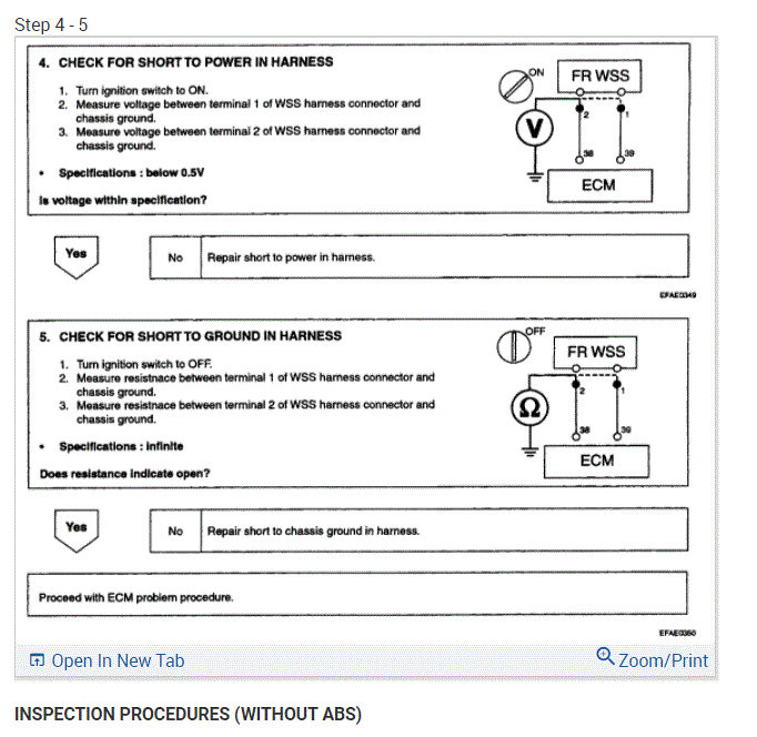

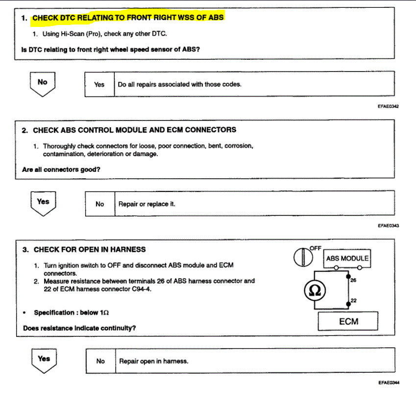

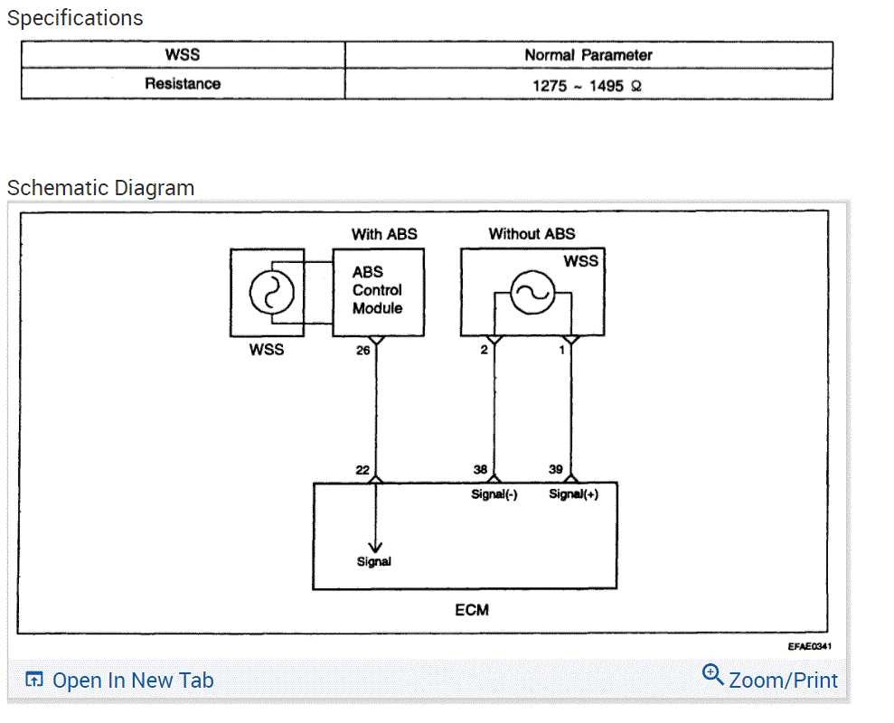

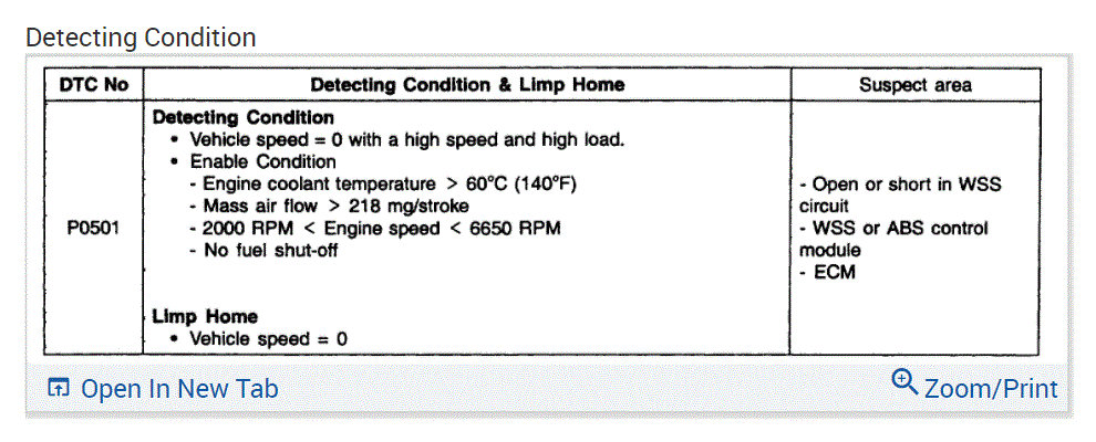

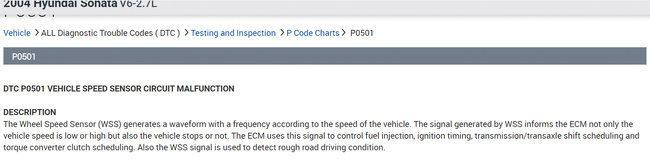

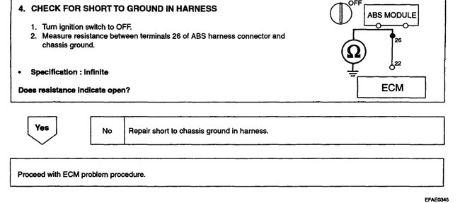

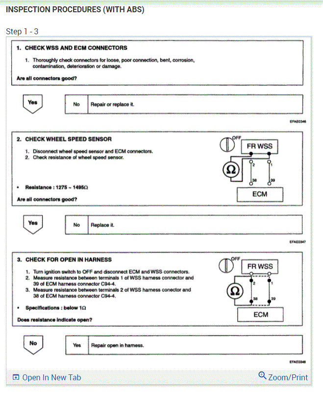

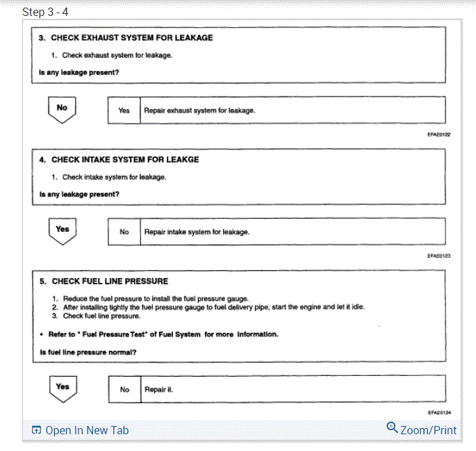

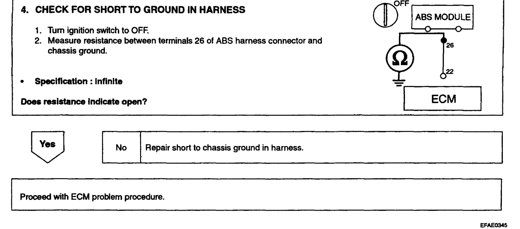

That code is specific to the right front wheel speed sensor (WSS). If you look below at the attachment, it explains everything that the sensor is responsible for. One would think just speed, but it's a lot more.
I included the diagnostics related to the P0501 as well. That is what needs to be done to determine the cause.

From what I'm reading, the WSS can be causing several different issues. The ECM uses it for several different controls. Let me know what you find. I'm interested in knowing.

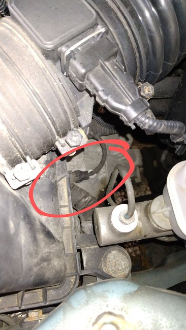

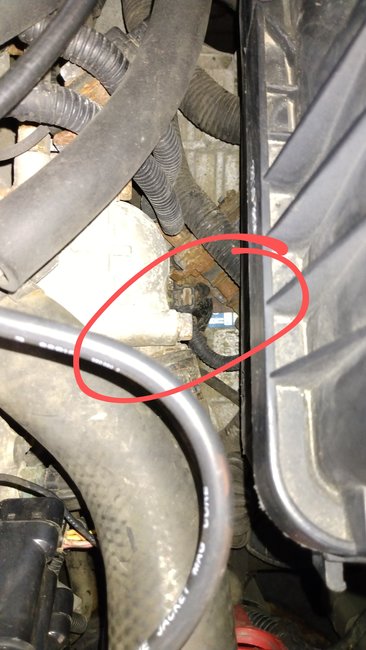

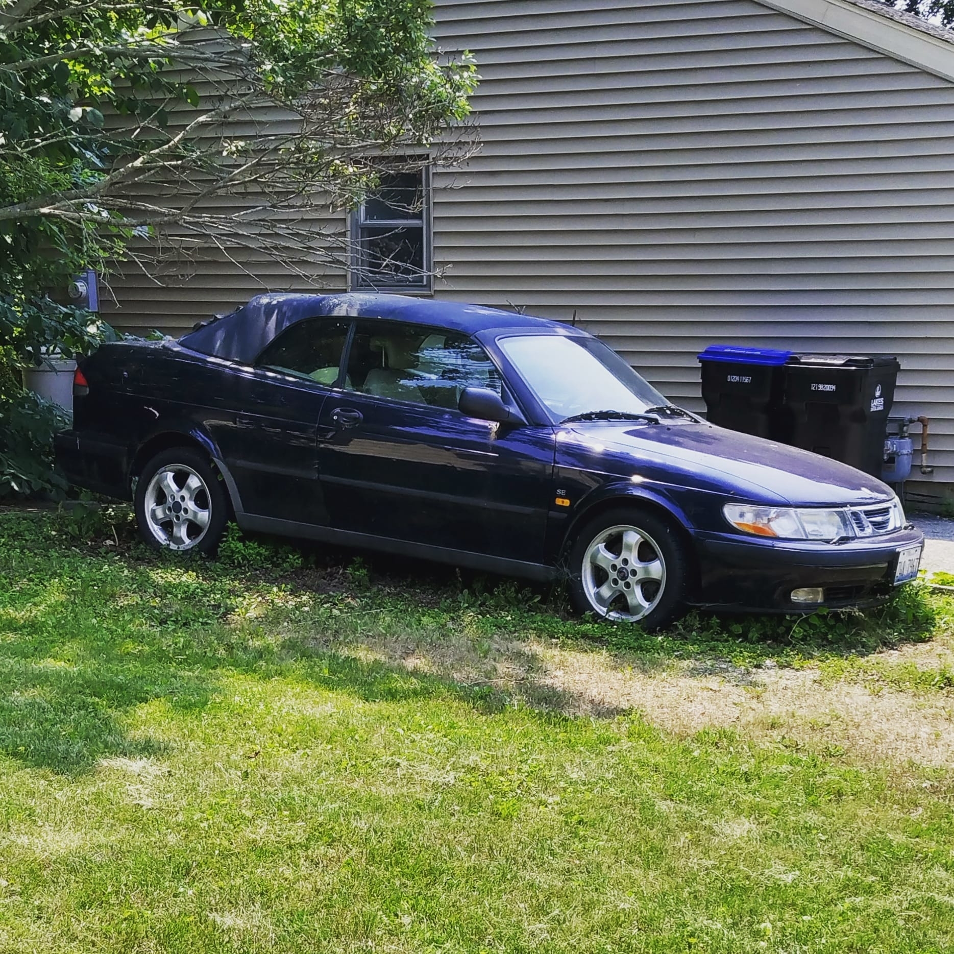

Hey Joe. It's been awhile. I'm adding the attached convertible to my car collection in August. Before I dive into that I'm continuing on with the speed sensor code P0501. I was under the hood today locating the sensors. I watched a YouTube video after reviewing the attachments you provided me. I want to make sure they are the two that I circled in red in attached pics. Todd
Tuesday, July 20th, 2021 AT 8:22 PM
  • 109,867 POSTS
The Saab looks great! Nice car.

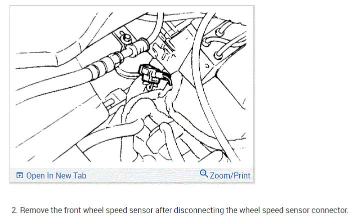

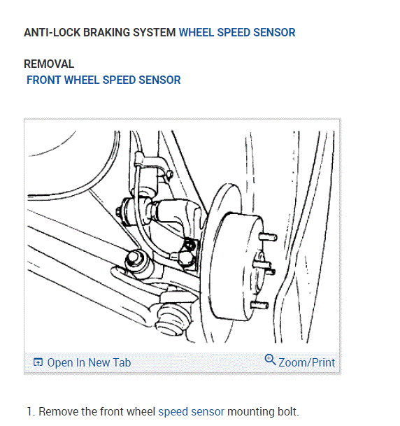

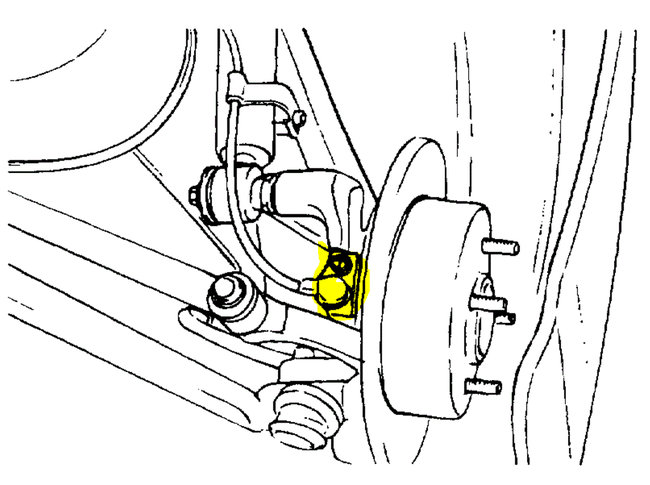

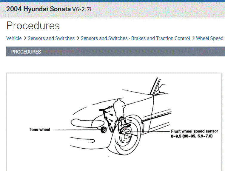

As far as the wheel speed sensor (P0501), it is mounted on the steering knuckle. I'm not sure what you circled, but that isn't a WSS.
Take a look at pic 1 below. I highlighted where to look. Also, the code is specific to the right side front (passenger side).

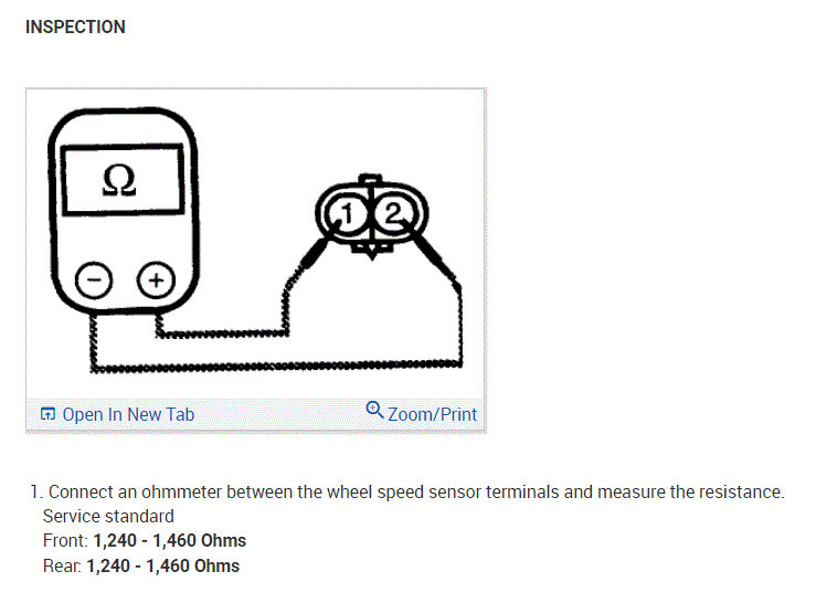

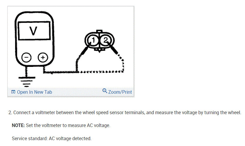

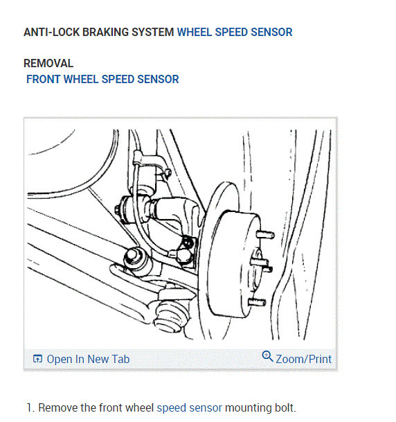

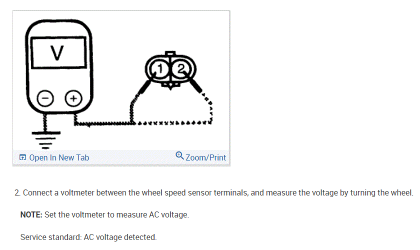

The remaining pics are the directions for the removal and replacement of the sensor. It's only one bolt that holds it in place. Also, the last two pics are for testing it.
Let me know if this helps.

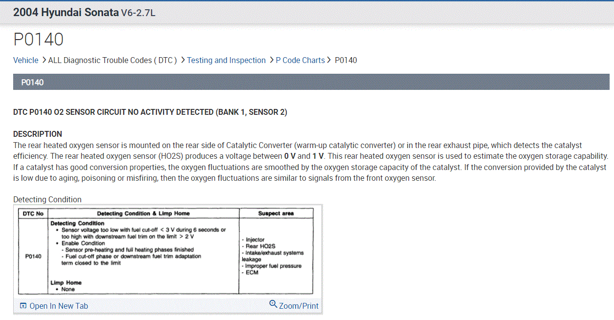

I did a voltage check and 1 out of 3 connectors work. The car was running hot in movement. The previous wss code has erased. I saw that no fuse was in the ABS slot. When I put one there the CEL went out. Also, ABS light went off. Now I’m running a P0140 code. I have attached a video for the sound I mentioned.
Oh, and I bought the Saab. 1999 9-3 SE with 130,000 for $800.00.
Tuesday, August 3rd, 2021 AT 1:26 PM
  • 109,867 POSTS

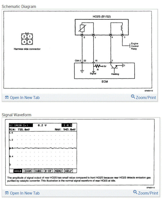

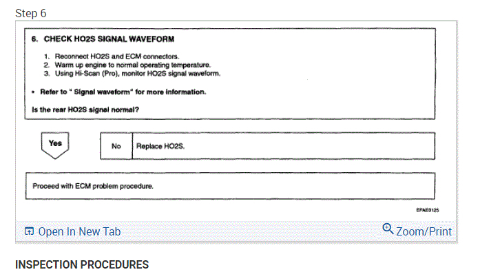

First, the code is related to the o2 sensor. It has nothing to do with the ABS or fan.
I listened to the video. That sounds like a mechanical problem and not electric. Is everything tight on the wheel, brake caliper/mount, CV axle, and so on? If you pull the ABS fuse, does the sound stop?

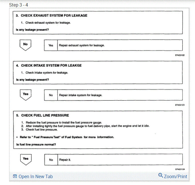

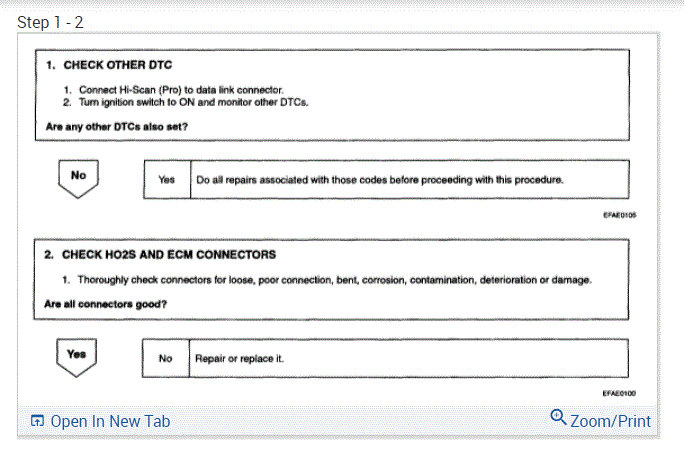

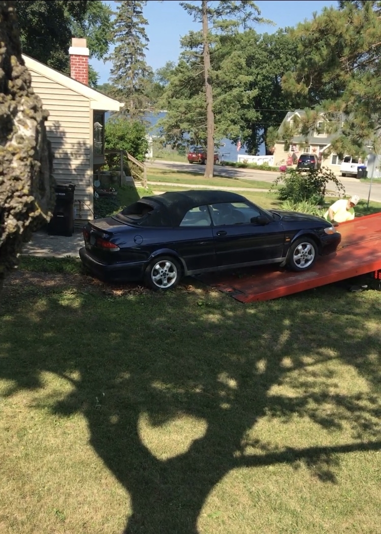

I attached the diagnostics for the P0140. I hope they help. I like the car. What scares me is it's being pulled onto a flatbed. Ugh!
Tuesday, August 3rd, 2021 AT 7:00 PM
TEEOHDOUBLED
  • 60 POSTS
I thought flatbed was preferred over the hook. This is all becoming too much for me. Thanks for the attachments. I was going to consider having two cars but this excess maintenance would take me over the edge. I guess I'll sell the Hyundai. I see more problems with it, and the Saab is so quirky that I'm just not sure.
