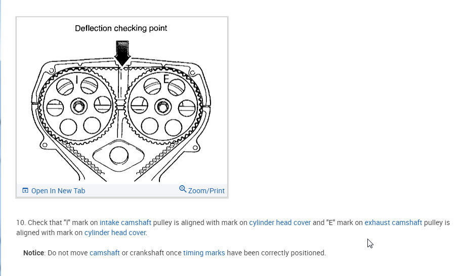

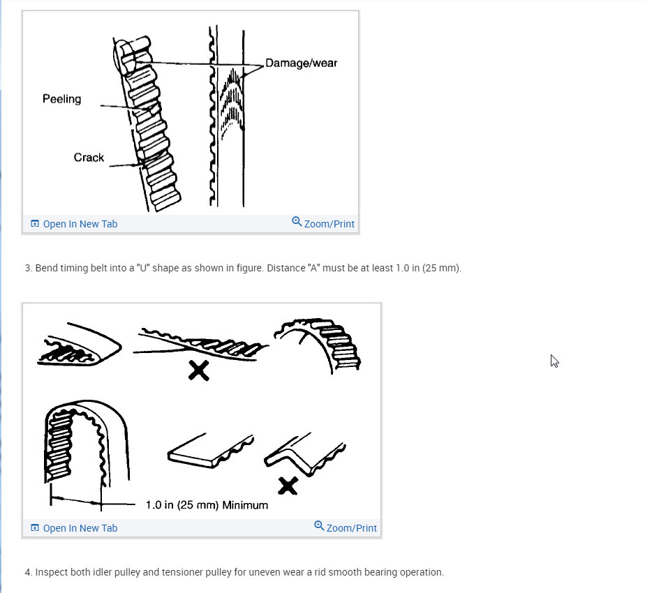

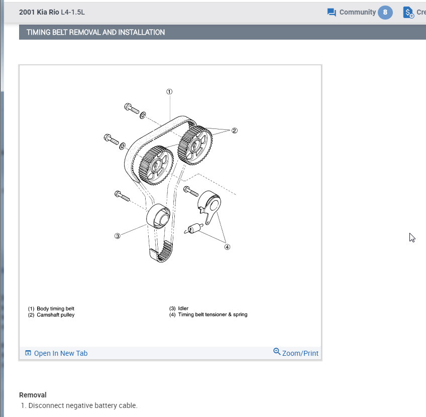

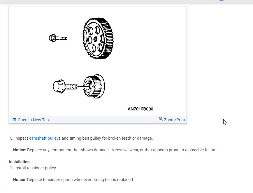

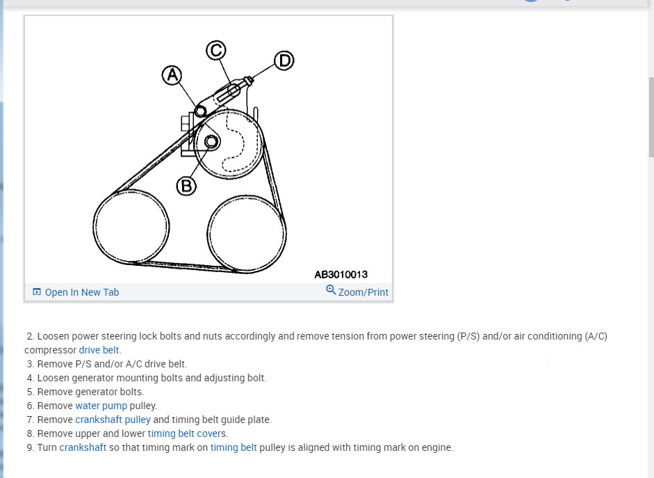

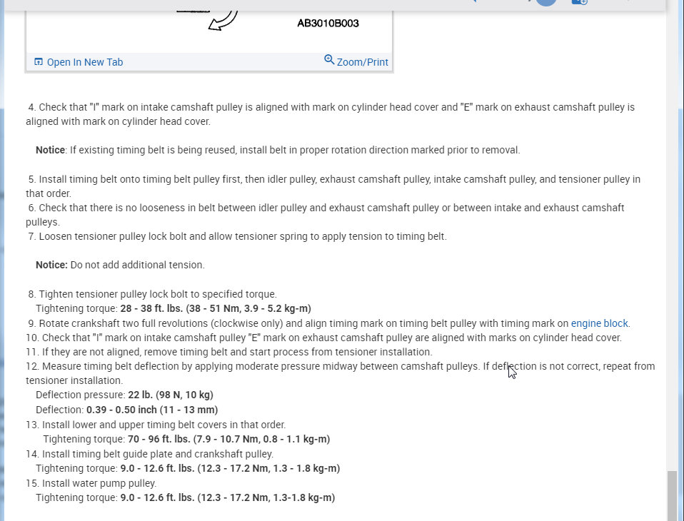

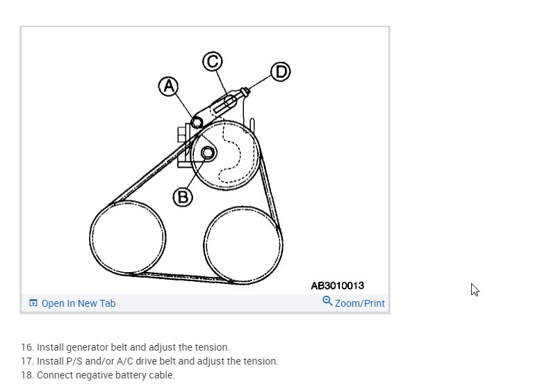

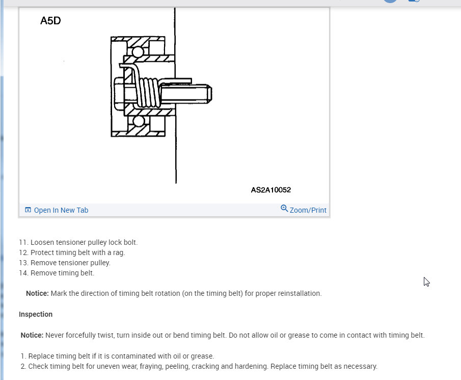

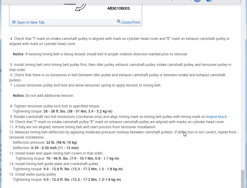

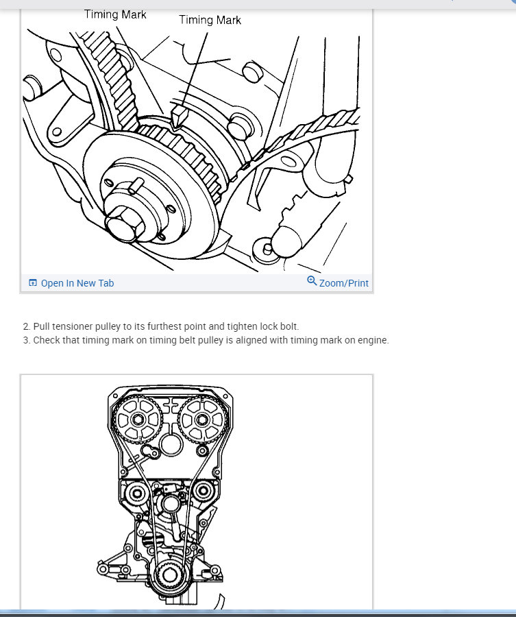

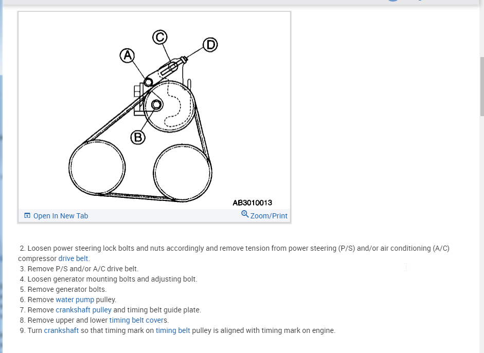

I put new water pump in now it cranks wont start. What tool do I need or how will I get to get it on timing again and start?
Aug 26, 2020 at 5:23 PM
Unfortunately we don't have a manual on this vehicle as it was not offered in the USA in 1991. However, I attached the process for the 2001 Rio with the 1.5L on how to reinstall the timing belt which covers the timing marks.
Let us know what questions you have and we can go from there. Thanks
