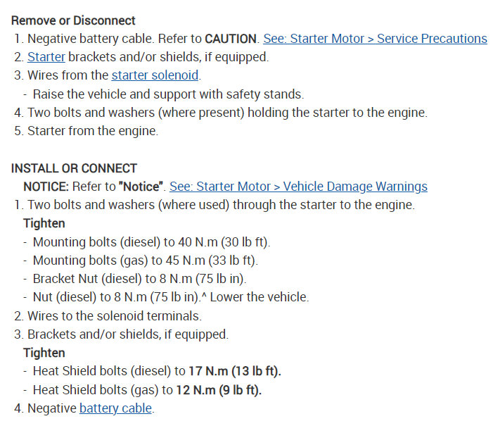

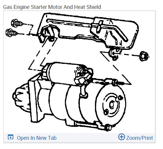

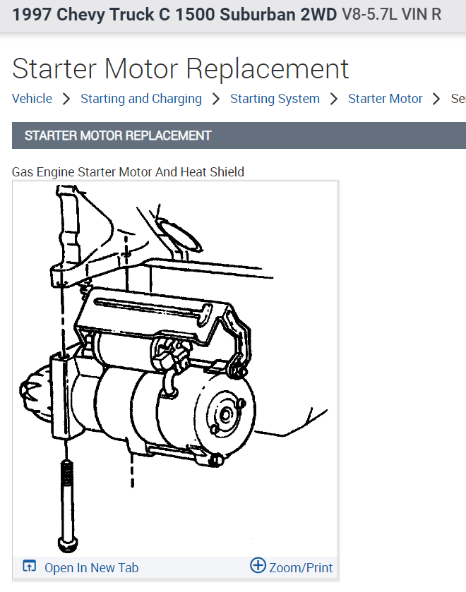

Yep, the starter motor is no good, can I ask where you are getting the starter from? I would use an AC Delco unit. Thanks for the video.
Here is how to change the starter out:

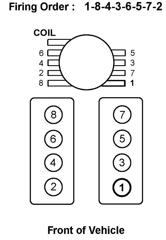

Okay, did that, same thing, but check this out; if I disconnect the distributor, it cranks fine no problem. Soon as I plug in the distributor it goes back to that same sound.
Jan 30, 2024 at 2:06 AM
  • 55,432 POSTS
I would double check the firing order, here is a diagram to help you. Also, it could be the distributor cap or rotor, I would replace them if they show signs of wear. Check out the images (below). Please let us know what happens.
