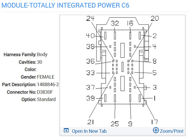

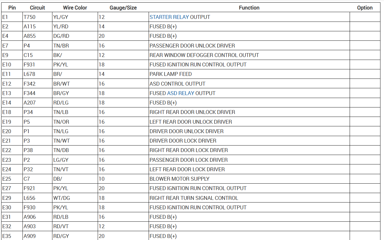

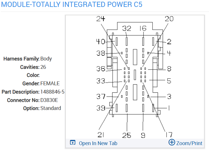

New TIPM install need the C-1 thru C-7 Tyco connector pinouts?
114,000 MILES • 4.7L • 4WD • AUTOMATIC
ROYLEE2004

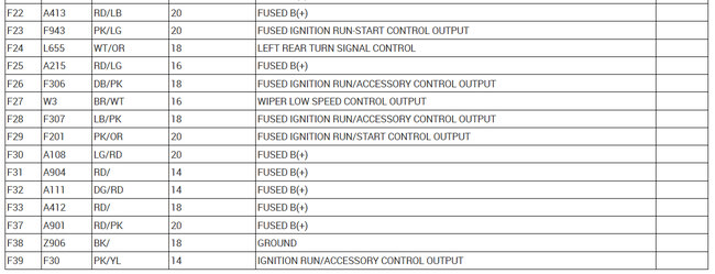

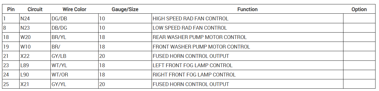

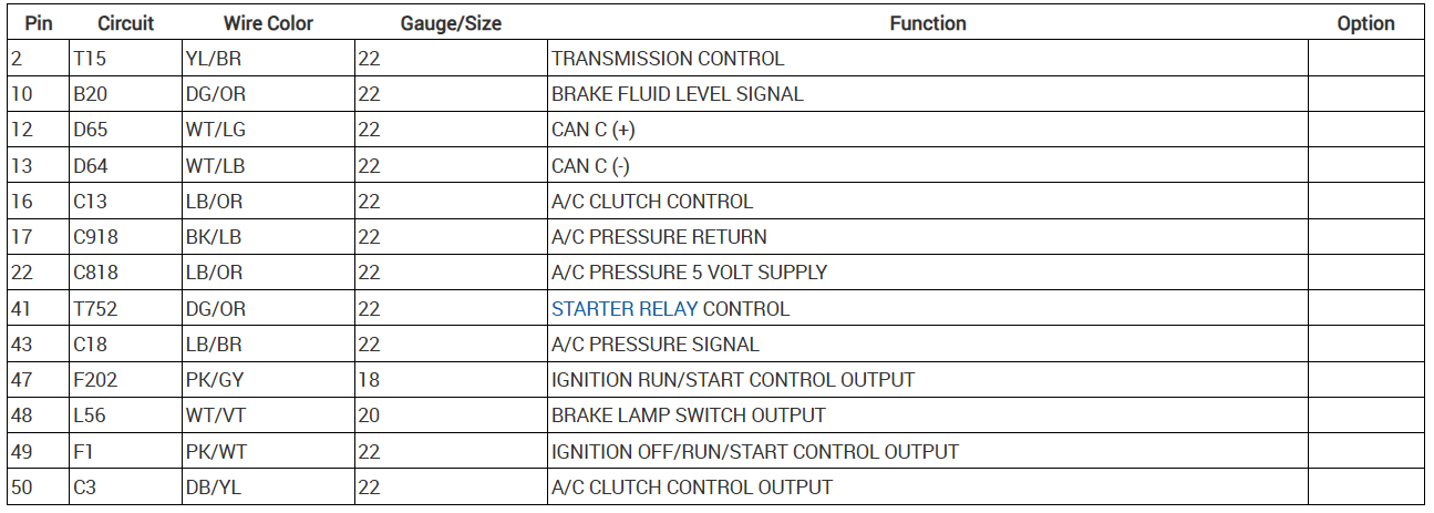

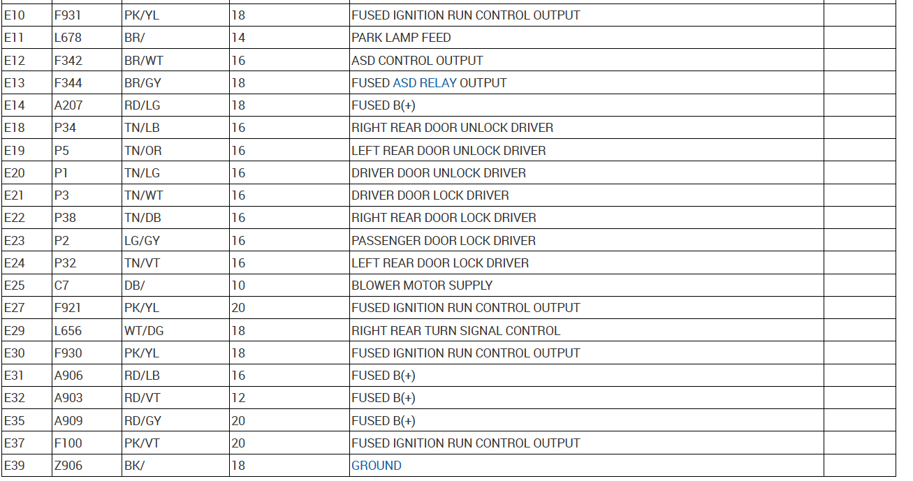

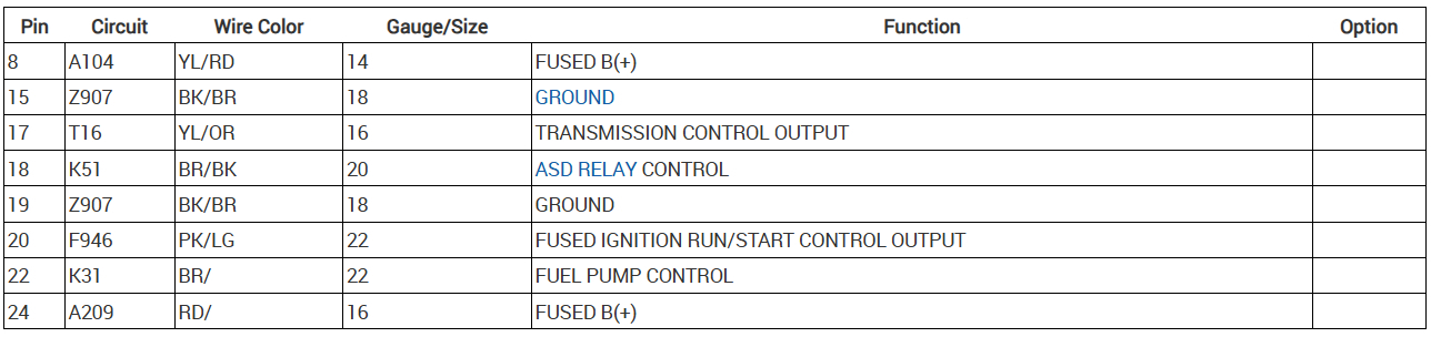

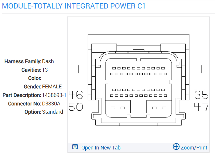

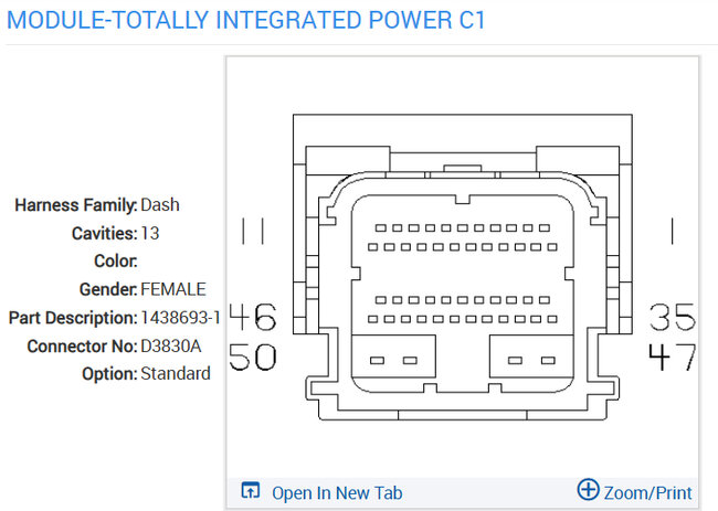

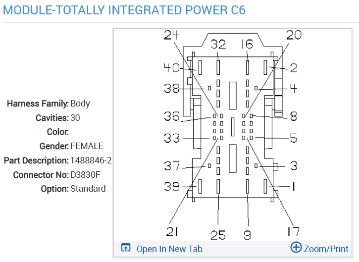

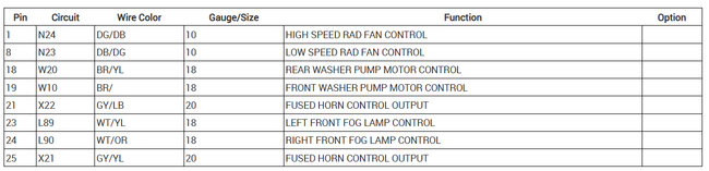

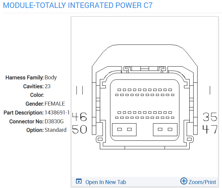

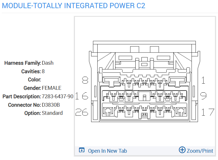

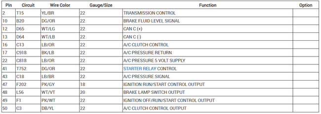

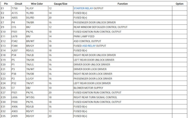

TIPM and C-2 (Blue) connector was damaged in a direct short circuit inside the C-2 connector resulting in melted plastic. Acquired another TIPM and C-2 connector using VIN number from O'Reilly's. Rebuilt and reinstalled the parts, allowed the TIPM's 3 minute "Initialization" without starting engine, removed key for 10 minutes then attempted "Initialization" 2 more times without starting engine while removing the key for 10 minutes in between, tried to start engine with "No Joy"! Fuel pump even failed to prime engine. Desperately need the C-1 thru C-7 Tyco connector pinouts for my 2010 Ram 4x4 so I can scour the connector's wiring for errors. So far AI has given me several sites to obtain one however, none of the pinouts I have obtained resemble my truck's system!
May 23, 2026 at 3:27 PM
  • 55,857 POSTS

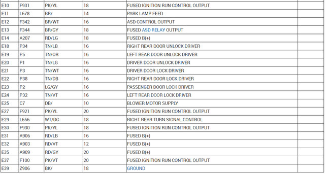

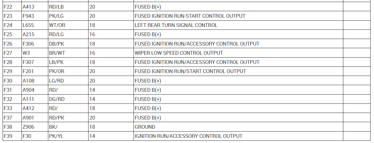

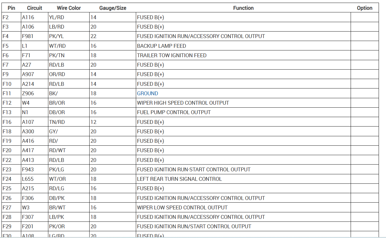

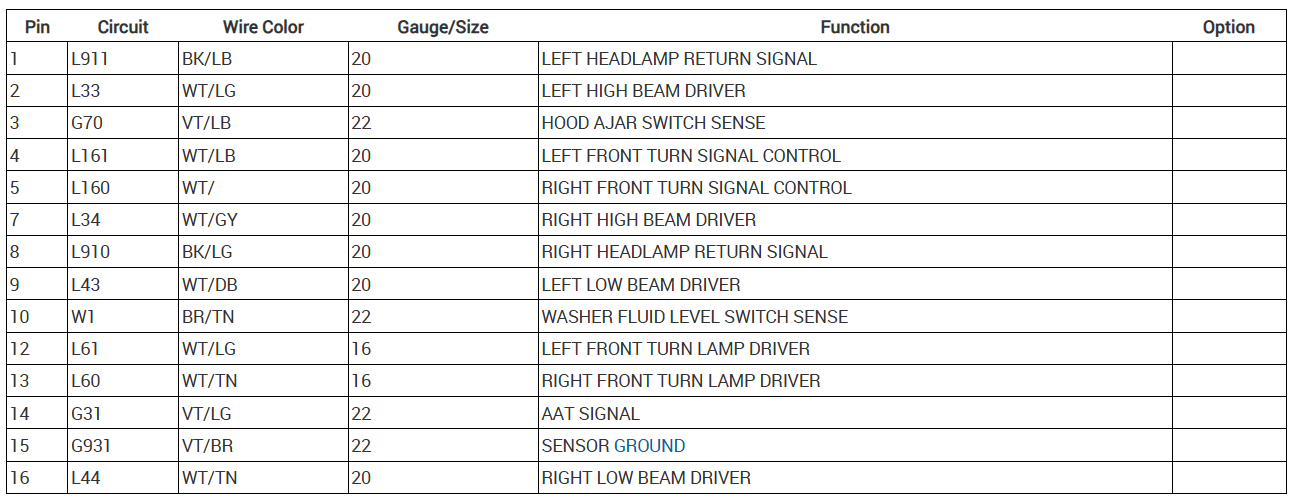

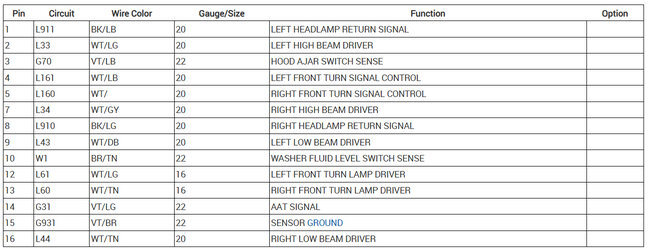

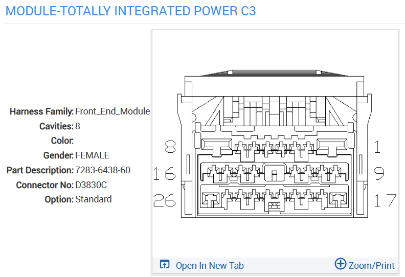

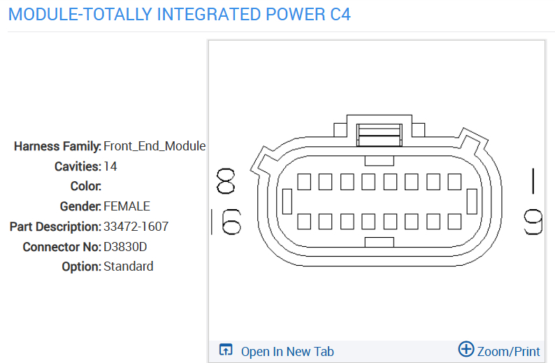

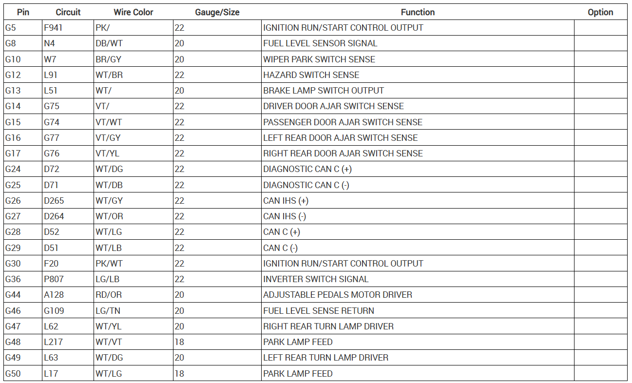

Yep, you need the connector views for the TIPM, Please let me know what happens. Check out the images (below). Let me know if you need anything else.
