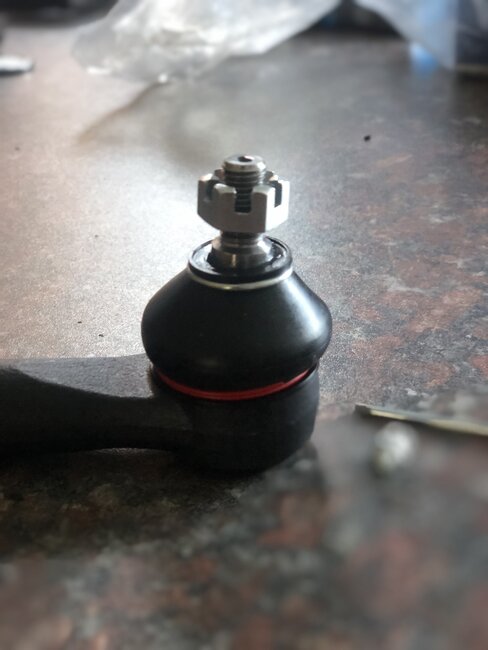

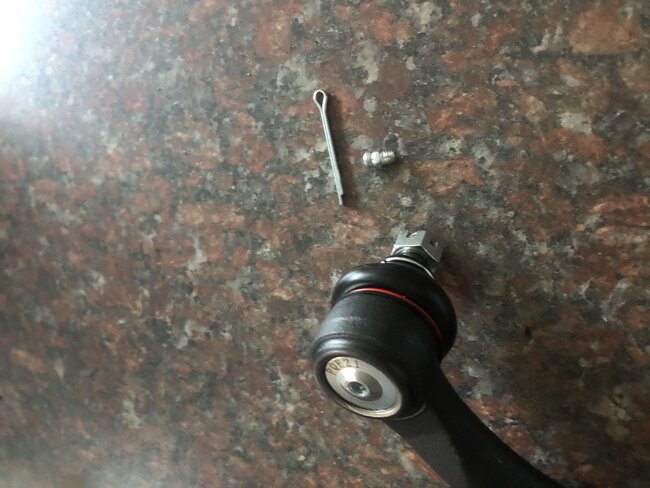

The issue is the new Tie Rod ends seem to need servicing… As can be seen from images below, the new Rod End has a service hole with a nipple included in the packaging. So, it is obvious that I need to install the nipple, even if just to avoid the grease leaking out. My challenge and first question is, do I need to grease it again as well?

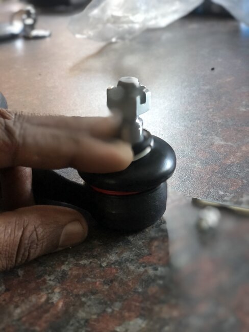

Secondly: The ring on the top near the nut isn’t exactly tight either, and as can be seen from the image’s below, I can pull the boot down using my hands. The current Rod Ends on the car though, I can’t just pull the boot down with my hands, old as it is…
So, second question is, would I need to tighten the ring as well - and if so how, or can I just install and tighten the nipple, then install the new Tie Rod end as is? Note that there is no slot around the ball shaft itself where the ring would slot into!

So, the Zirk fitting goes into the bottom of the tie rod end and filled with grease once it is installed, this will keep the boot in place as well, once you see the boot is full stop adding grease. As far as the noise goes, I would look at the CV axles which is what it sounds like is causing the noise. You will need to remove the axle to check it out and please go over this guide to help:

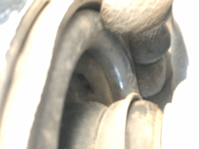

Got everything out, but then saw this (video), and I can’t help but ask: is the CV supposed to be able to move in and out like this? It appears it is still connected inside the boot, but I’m not certain…
Also, the lower ball joint is easily moved around by hand, and so is the steering tie rod end ball joint as well as the ball joints on the Stabilizer link (video2).
So, going to replace all bushings and ball joint, new Tie Rod end as well as new ball joints on the Stabilizer link, though that last one if I can’t find ball joints for it, I’ll replace the entire thing…
Let me know what you think about the CV joint.

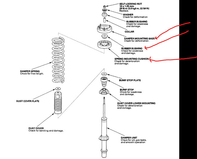

Yep, thanks for the videos, the first video has the noise which is strange I would say the strut mount is what is causing the noise. This is where the strut pivots and holds the weight of the car. The other two videos are normal. Check out the images (below). Please let us know what you find. We are interested to see what it is.
Jan 5, 2023 at 4:55 AM

Okay, glad to hear that about the CV video.

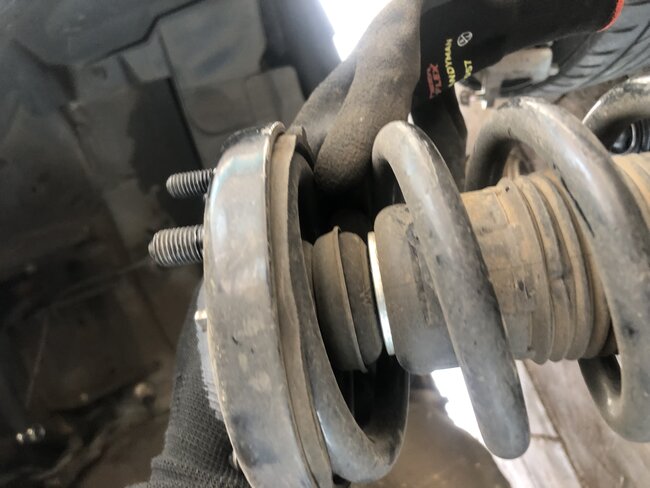

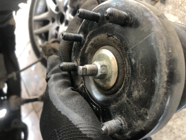

Hi Ken, attached are some pics.
So, I removed the shock and spring assembly, but did not disassemble as that is one task, I never look forward to doing. I checked the assembly nonetheless, and there is nothing I can see that would indicate any wear or damage as proposed. So, I reinstalled and torqued down as before.
Then, I proceeded with the rest of the suspension work (lower control arm bushes, ball joint, steering tie rod ends, Stabilizer links), and after some other engine work (valve clearances), it seems that the sound is gone!
I took the car up on all the usual ramps that made that noise, so far none… There seems to be a new but much quieter rattle in the front though when going over speed bumps, but that I’ll investigate when time is available again.

But you might have been on to something though: whilst the knock is gone when climbing a ramp, now there is a much softer clunking or rattling noise when going over bumps… It’s softer, and when going straight.
I’ll have a look to see if perhaps I failed to tighten something properly, or maybe the shock mounts are going out slowly (though they both are less than a year old).
