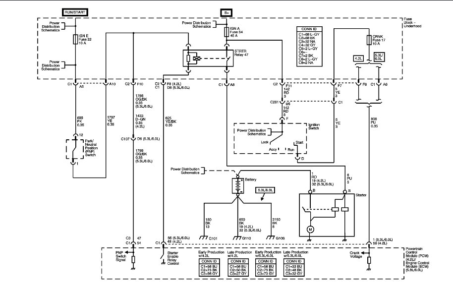

I am getting power. I thought it was the ignition switch, so we replaced that and the starter relay, the starter and a new battery. I still cannot get it to start! Please help, stranded two hours from home with my children!
Dec 9, 2018 at 12:39 PM
Good morning,
When you turn the key on, does the theft or security light come on and then go off after about ten seconds?
Do you have anything to test for voltage?
Can you check the fuses? Please check the Ignition A and the ignition E fuse for power on both sides.
