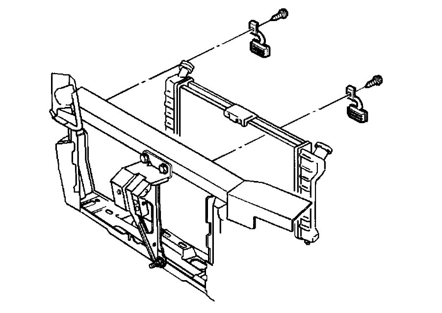

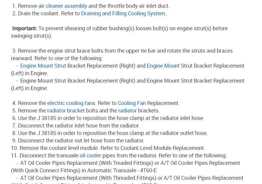

I was just asking how I would put in a new radiator?
Aug 7, 2019 at 8:08 AM
SCGRANTURISMO
  • 4,897 POSTS

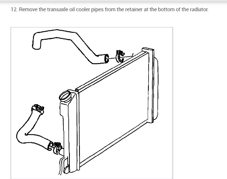

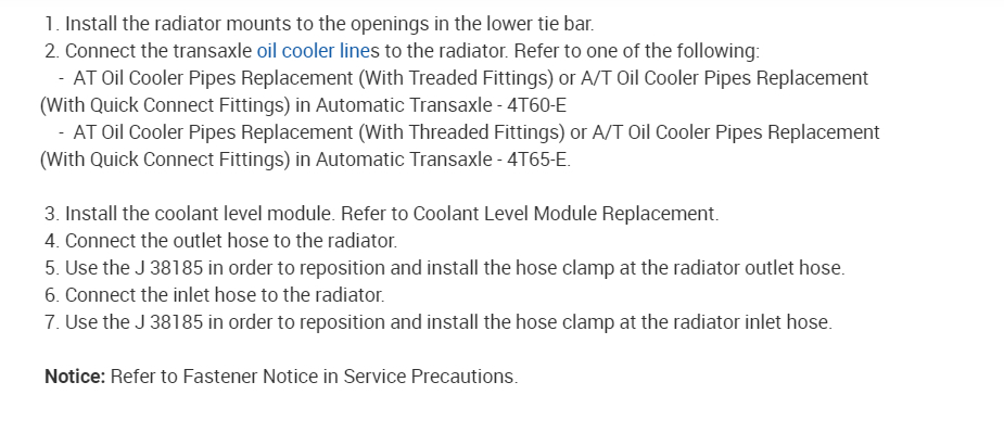

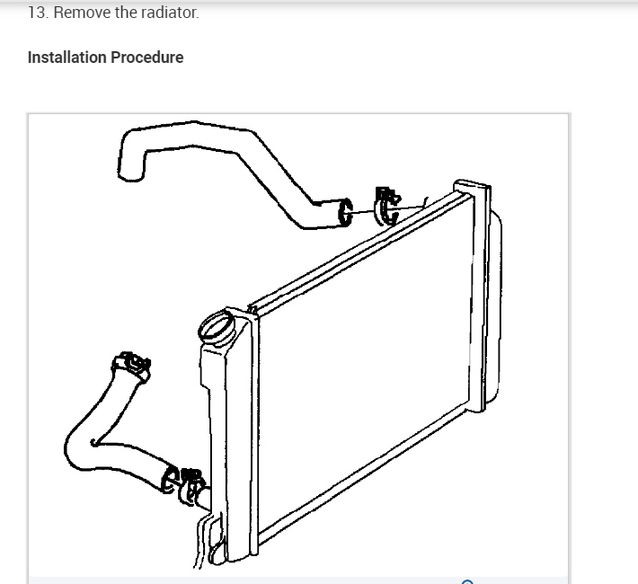

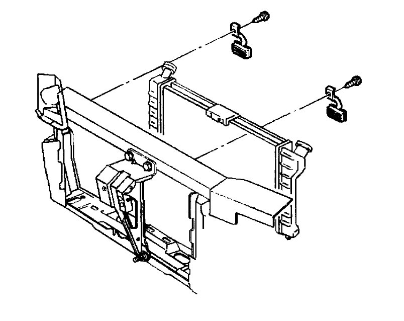

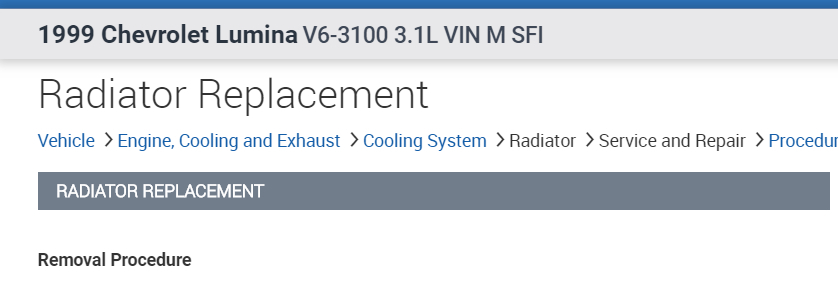

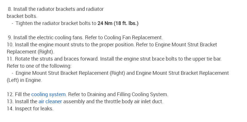

I have included the information that you requested in the diagrams down below. Please go through the information that is the diagrams below, which is the factory guide to the removal and installation of your vehicle's radiator, and get to us with how everything turns out or you have an additional vehicle related question.

Are you referring to the diagrams?
This guide will walk you through the repair as well:
https://www.2carpros.com/articles/how-to-replace-a-car-radiator
