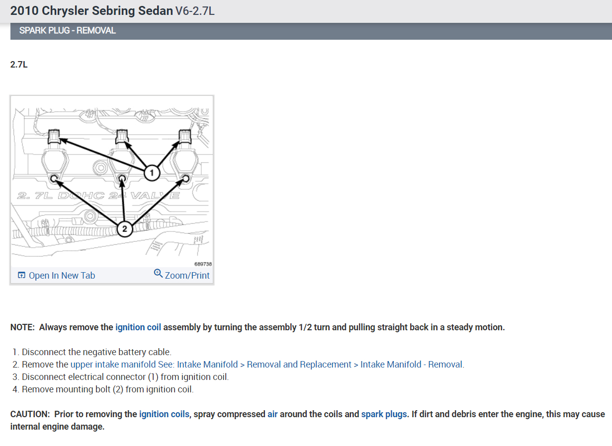

I need to replace the spark plugs?
2010 CHRYSLER SEBRING
50,000 MILES
DOC2695
gap and type of spark plug would be great. Can I get instructions please?
Apr 21, 2013 at 1:03 PM
  • 55,399 POSTS
Here is the spark plug gap and torque along with a guide to help you step by step with instructions in the diagrams below to show you how on your car.
1.27 mm (0.050 in)
20 Nm (15 lb-ft)
https://www.2carpros.com/articles/how-to-change-spark-plugs
