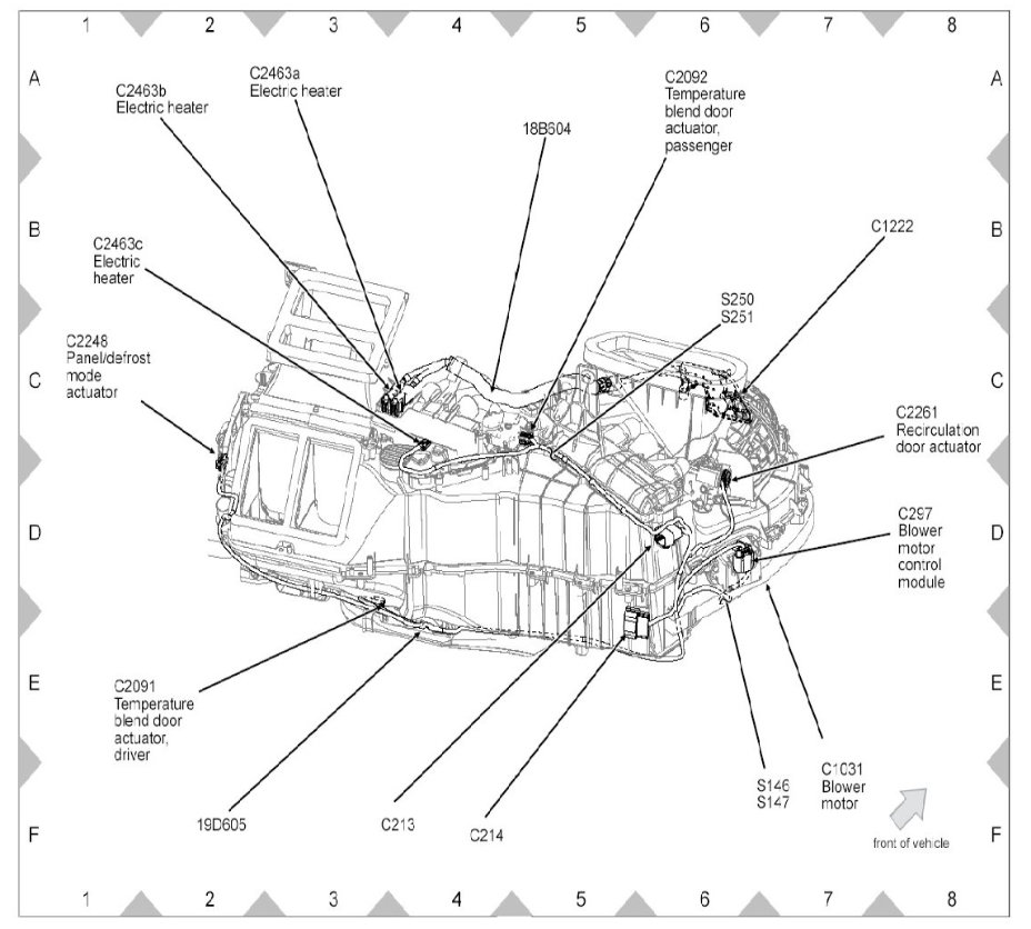

I replaced my passenger blend door actuator behind the airbag and still have no heat. Any suggestions to get it going would be great.

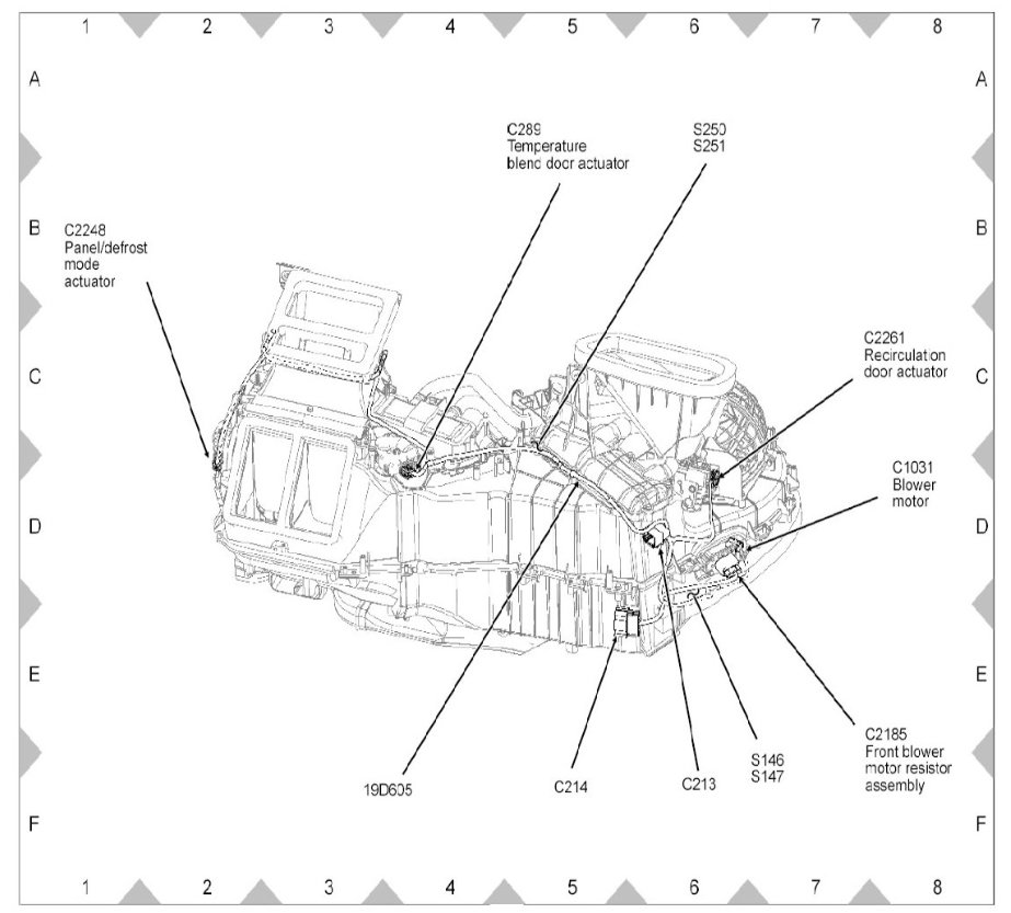

Lets confirm that we replaced the correct blend door actuator. here are location diagrams in the images below. does the system seem to work okay besides the passenger side heat?
This guide can help:
Check out the diagrams (below). Please let us know what you find.

Yes I replaced the correct one. It probably helps to let you know that I have the dual zone version. I will say it was extremely difficult to see where to drop in the actuator into the blend door shaft, that maybe where my error is. It seemed to fit good so I bolted it down but the shaft from the actuator may not be inserted into the actual blend door place where it’s supposed to go. Hopefully this all makes sense.
