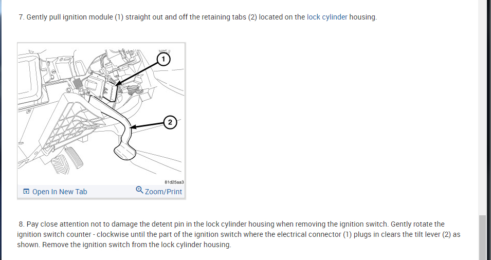

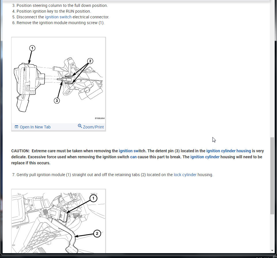

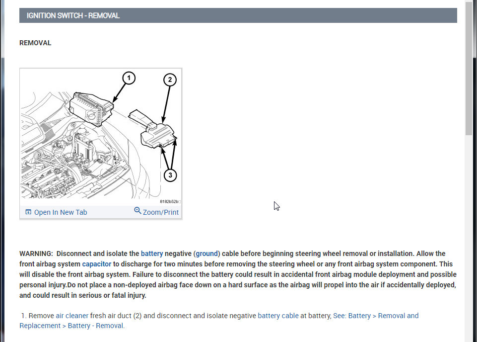

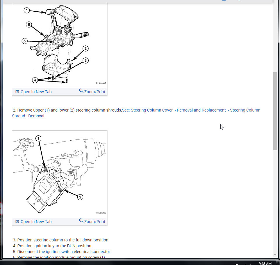

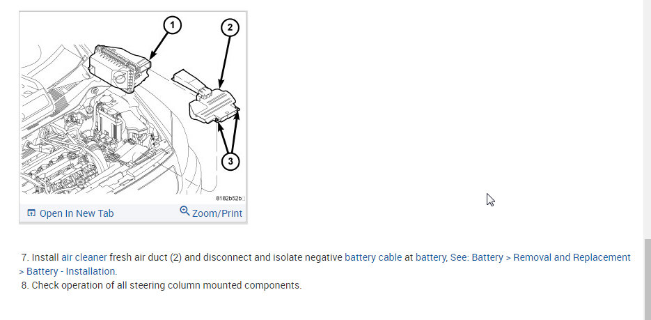

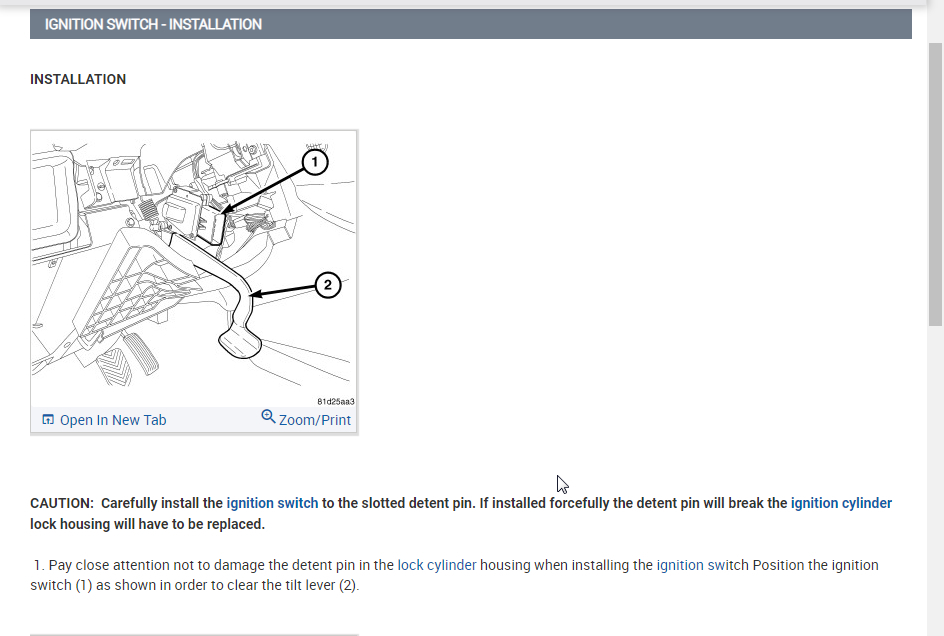

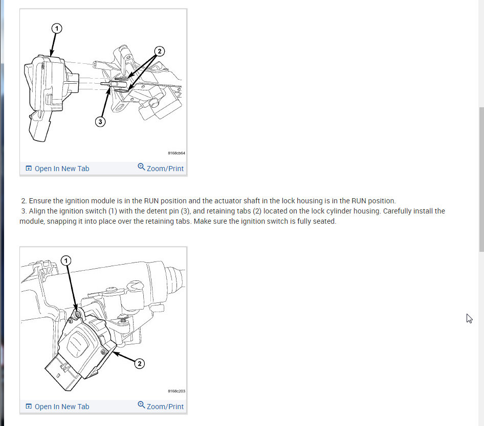

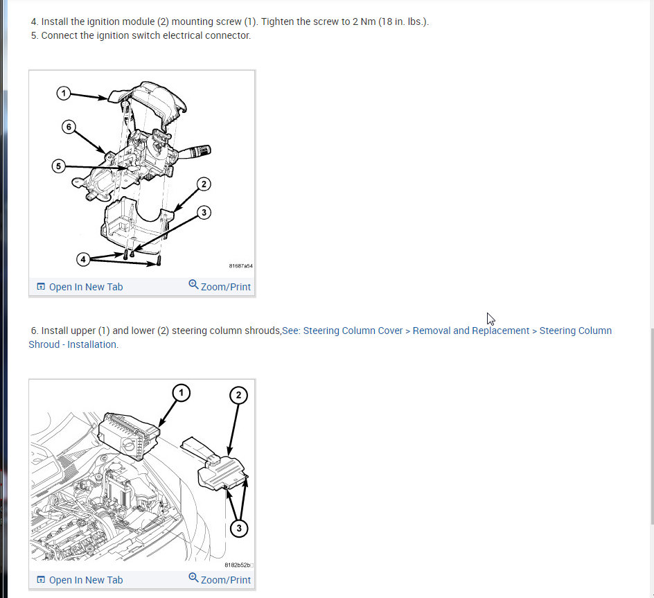

I need to replace the ignition switch and kep can you please give me instructions?
May 11, 2019 at 5:37 AM
Experienced Mechanic
18,907 POSTS
I am attaching the info below. However, here is a guide that will help with a stuck ignition if that is the issue you are having:
https://www.2carpros.com/articles/ignition-switch-wont-turn-stuck
Please run through this below material and let us know if you need any other information. Thanks
Images (Click to enlarge)
