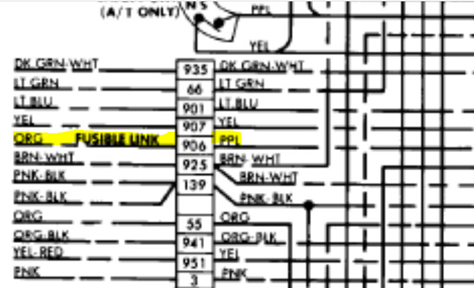

Bear with me. For some reason, I have no wiring schematic for this model and year. I have older and newer ones, but not this one.
On many of the older ones, there were multiple fusible links that ran between the battery and the bulkhead connector at the fire wall.
Update:
I was able to find a very basic schematic. On the engine side of the firewall, there should be an orange fusible link. On the interior, that wire connects to a purple wire which is the trigger wire for the starter motor. See if you can locate the orange wire first. If you can, check to make sure it has power where it goes into the bulkhead.
Let me know what you find and exactly what is happening.

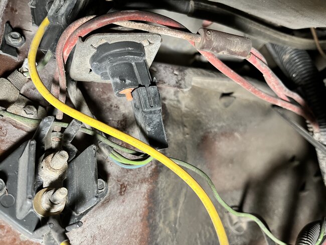

See pic below.

This one in the picture?

The orange wire in pic 1 appears to be it. Is there power on both ends? It looks like it may have overheated at some point.
