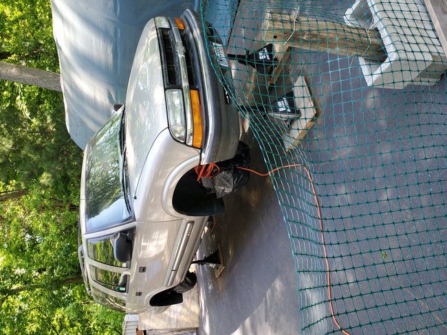

The vehicle listed above is a 4-door, original owner. spent five months getting rid of rust on frame and drive line, replace leaking fuel lines, tank, pump good now. went further with front end upper arms, all ball joints and new hubs. all back together engine good running now. I shifted the transmission into gear and up and down the driveway six times, then nothing? just stopped, engine still runs fine but will not move. You can feel the engine reduce slightly when you shift manually p, r, n,3,2,1, (putting it back in park, it grinds) but shifting with buttons on dash 2,4hi, 4lo does nothing. now i am at a loss. Help?

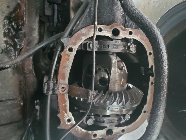

It looks like a rare occurrence with one tooth of a spider gear broken off/failed and damaged the other. So much that they weren't meshing with axle gears! I guess I really messed up. I have taken axles out before, Olds and other Chevrolets, doing this on my back with jack stands. well, at 78 I just can't do anything right anymore. It stinks getting old. Frank

Frank, thanks for the update. I'm sorry to hear what happened. Listen, at 58, I'm the same way anymore. At least it feels that way. LOL However, if you only installed the axle, I'm not confident that is what caused a spider gear to fail.
Do you plan to replace the spiders yourself? Let me know. If you do, I'll get you as much info as I can to help.
Let me know and don't blame yourself. If it broke that easily, it was ready to break regardless of what you did.
