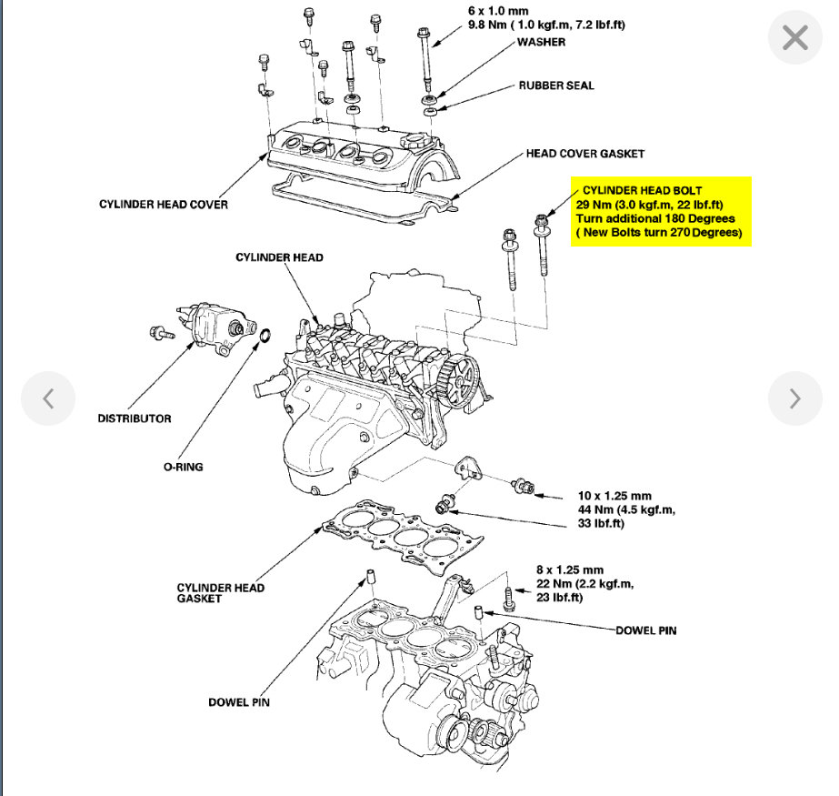

Need to find the torque specs for new head bolts on my car listed above 2.3 vtec.
Sep 4, 2019 at 11:18 AM
Please see the attachment. It shows the head bolts and others in case you need them. Please let me know if you need more and I will be happy to look them up. Thanks
Please note the spec and then the additional turning that needs to be done if it is a new bolt. Thanks
