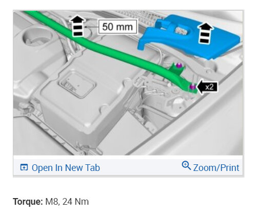

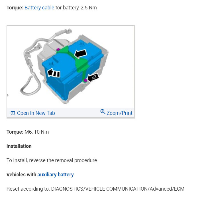

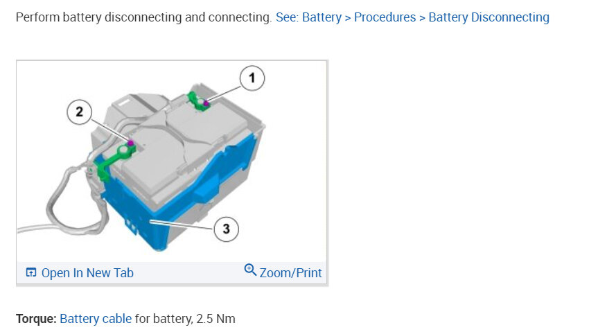

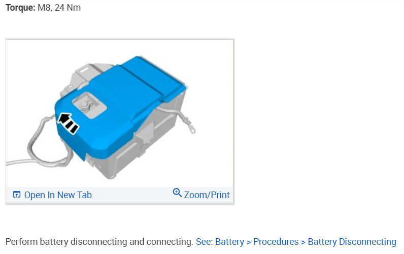

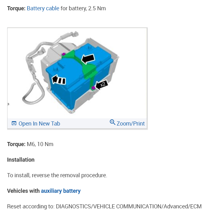

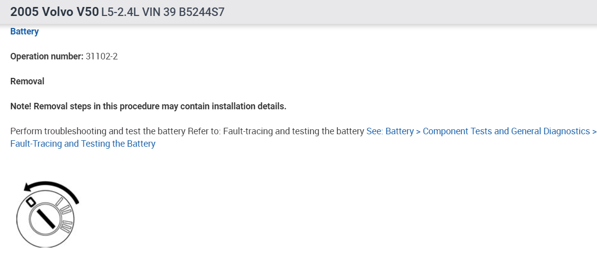

I would replace the battery first, a battery that drained can remove operational voltage from the system which can cause the problem you are describing. Here is a generic guide to help you step by step with instructions in the diagrams below to show you how on your car:
https://www.2carpros.com/articles/how-to-replace-a-car-battery
Check out the images (below). Please let us know how it goes. I can get you any wiring diagrams needed which ones do you want?
