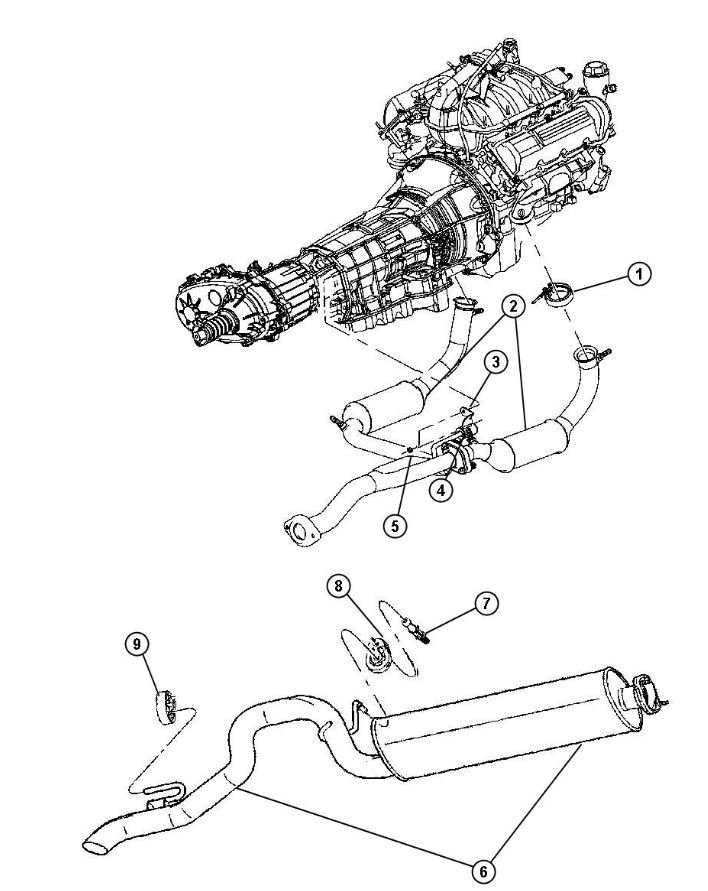

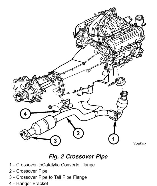

Okay, so when I purchased this used there were zero catalytic converters on this. Someone had just ran flex pipe and it's all full of holes and leaking throwing 02 codes etc. I bought it in PA I'm from NY with mandatory emissions at inspection. I've purchased left and right converters y pipe muffler tailpipe . I can't seem to find any diagrams or YouTube videos on this. I'm going crazy trying to figure out what clamps I need and how many. I also believe there is a small exhaust pipe to the muffler I'm overlooking. I believe I need a few V clamps springs and bolts 2 u bolt clamps and a gasket. I have 2 new downstream sensors as one is welded to the flex pipe on there so I just ordered 2 new ones just in case. I'm just trying to make sure I have all the parts needed before I start this job I'm pretty sure I can get someone to help. I'm tired of buying used vehicles every so often so I'm just going to put the money into this and hopefully keep it for 3 to 5 years without starting over on another used vehicle. Parts for this are very expensive I have found out! Any diagrams or input on a complete exhaust replacement from converters to tailpipe would be appreciated and definitely help. I probably could have just used a universal cat replacement but I believe in just doing it the right way as long as I have the extra money right now. Lord knows this vehicle is breaking the bank. Lol

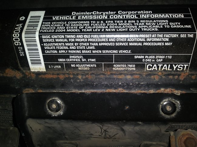

Would you look on the sticker on the header panel or under the hood and see if it says the Libby has either Federal or California emissions? The converters use one V clamp on each to attach them to the exhaust manifolds. Then the right one will use a flange gasket to attach to the Y pipe. Now at the flange on the Y pipe you attach the undercar converter, this goes in front of the muffler. Then to attach the muffler it depends on which one you have, The OE fit versions from Walker use a donut seal and a direct bolt flange and two spring loaded bolts to hold things together. They also have a version that uses a short adapter pipe that bolts to the flange and then the muffler clamps to that. If that is the style muffler you have and because you want to keep the Libby a while you may want to use band style clamps instead of the common U bolt type. When the pipes rust off the band type are much easier to deal with and they seal better. Behind the muffler you have a clamp as well that holds the tail pipe to the muffler. I attached images of the right cat, two styles of the left one, one is OE style the other is a split version, the split style tends to leak but are easier to install. Then the OE style flanged muffler and the actual Mopar item. If you bought a muffler without the direct bolt flange you will need the adapter pictured next to go into the front of the muffler so it can bolt to the converter. Then the muffler and tailpipe.

It's a shame they removed the OE parts, the factory exhaust was much better quality than any of the aftermarket stuff. If it's in good shape other than the rockers I would suggest giving it a real good bath and having it coated with either Krown or Fluid Film. Both will get into the body seams and stop rust. If you can fabricate steel you can make a much better rocker out of large straight exhaust tubing. Also as an upgrade, if it still has the stock capped lug nuts go on amazon and order some McGard tuff nuts to fit it. The OE capped ones are soft and the salt destroys them in a short time. The tuff nuts are solid steel and plated and tend to last.

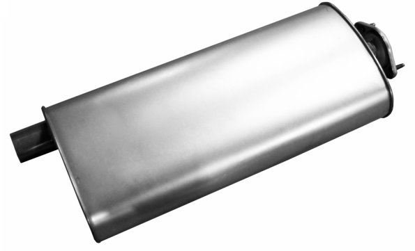

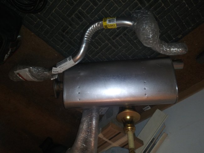

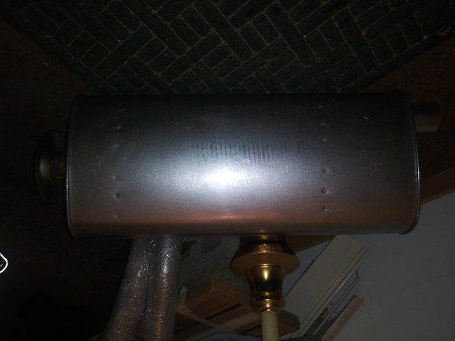

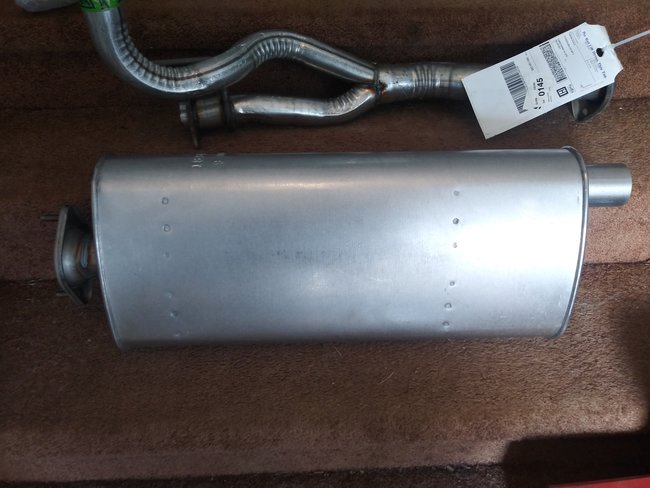

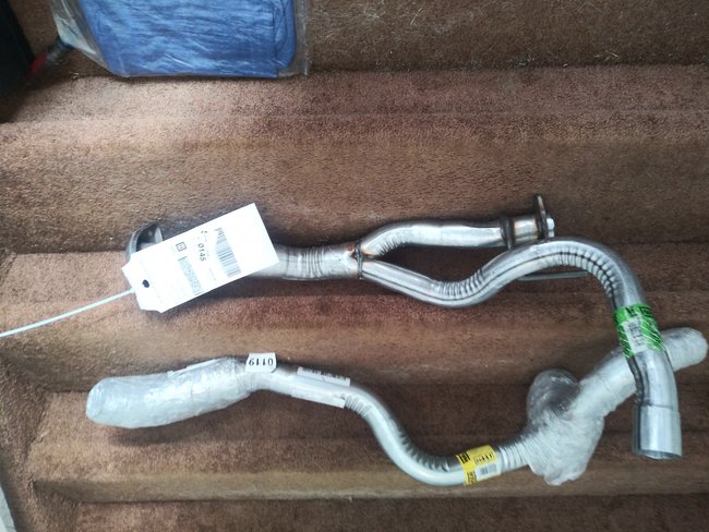

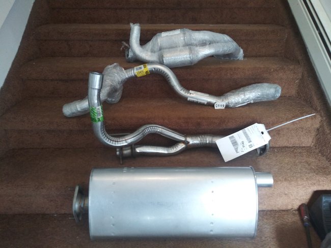

Well, I have pics of the new exhaust parts I can leave a few pics for you. A few look upside down. I put in over 70 hours at my job this week so I feel a little upside down. myself haha If you could tell by looking at them if maybe that one part is welded to the muffler already or is that something different? I believe there is a flange on the end of one side of the converters. I just need to figure it all out although you have already told me the clamps and how many I need. So instead of the U bolt clamps do you mean the band sleeve coupler-like clamps? I'm not good with the correct terminology lol I do believe I DID buy all Walker parts. I forgot to look under the hood. I'll check that with a flashlight the next time I take my dog out. Thanks so much...

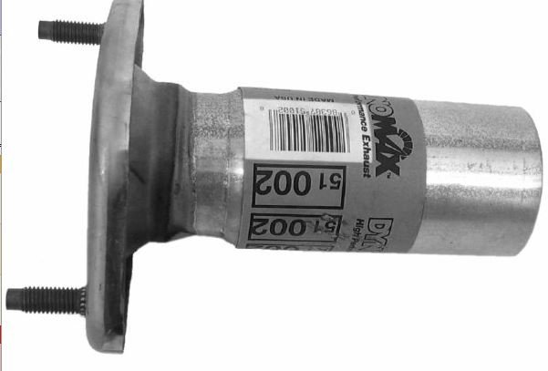

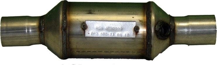

would this be the correct part I need for the exhaust if it is not on the muffler?

I took a pic of the sticker on the inside under the child not dare if you can see it it's dark but I believe vin says all US and Cali.

Okay, it looks like you still need the middle converter for it to be legal. The muffler you have doesn't need the adapter, it's one of the better ones that is a direct bolt on as it has the front flange. Yep, that is a California version so it has three converters under it. Stupid really as the front two are monitored but the rear is just along for the ride, but that's the Feds for you. The easy way to get the rusted V clamps off is a cut off wheel through the bolt. I would check that the tires are the exact same diameter, the 4 wheel system won't like it if they are different.
Apr 30, 2021 at 5:01 PM

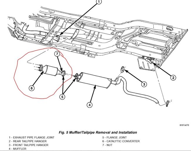

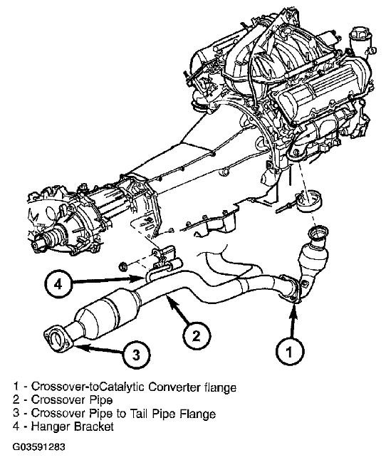

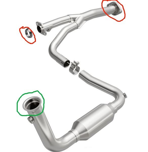

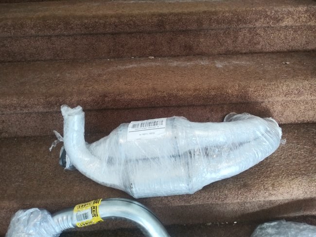

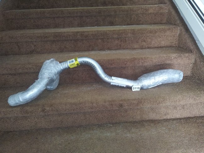

would this be the part? Is it possible that there is a universal one of these or is this going to cost me another few hundred? I might have to put this exhaust up for collateral and take a loan out on it ,LOL.
May 1, 2021 at 12:20 AM
STEVE W.
  • 15,409 POSTS
You might not need it on an 04, I know my 02 had it but it wasn't monitored so no sensors. One parts list shows it but another doesn't and both are OE files for the 04.
The rear unit isn't monitored on them unless it's the 4 cylinder as that is the only unit they have so legally if it isn't used it doesn't really need to be there. I would lay out the parts you have and see how it fits under the jeep. The two front units will have a total of 4 O2 sensors which do all the work.

Okay. I'm getting a bit confused. so far 2 V clamps for cats, a spring and bolt kit for the right side cat 2 coupler band clamps 2.25 one for tailpipe and one for y pipe and do I still need one more band clamp and that gasket ..I hope. I'm trying to order them now. I put a pic of those coupler band clamps I should use instead of the U bolt clamps not sure if I have them right. To me, a clamp is a clamp. yikes
May 1, 2021 at 12:39 PM
STEVE W.
  • 15,409 POSTS

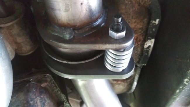

One V clamp and donut gasket for each cat to manifold joint. Then a clamp for the left cat to the Y pipe. Bolt and springs with donut for the right cat to Y pipe. That gets the Y pipe to engine side. Then donut gasket and springs and nuts for the muffler to Y pipe, and a clamp for the muffler to tail pipe. Those are the good clamps. The nice thing with them is they don't crush the pipes and cause issues if you need to take things apart in the future, and you can just snug them up as you put the system together until you get all the pieces into the hangers and position. I normally do the engine side first, then hang the tailpipe and slide the muffler into it with a snug clamp. Then couple the muffler to the front pipes.
Adjust it all to get things into position and start snugging the clamps up, then once it's all in, torque the clamps down good. If there is any doubt that a joint could leak you can apply a bit of the exhaust paste they sell as a sealer.
May 1, 2021 at 1:38 PM

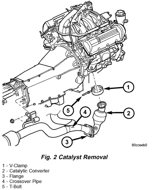

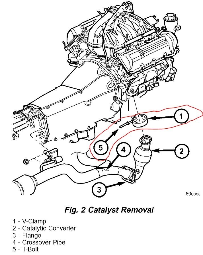

Okay, I have not started this yet. The weather has not been the greatest rain rain and more rain. We actually have a freeze warning tonight too. I was looking at the diagrams maybe I'm looking at are wrong one but I noticed one had a T Bolt Clamp. Do I need this clamp also. I do not want to start this and I need something. Maybe that was the split converter you said one of the diagrams were. I have Friday off and weather permitting if I do not hear back from my friend I'm going to jump in and just try this myself. Thanks
May 10, 2021 at 4:03 PM
STEVE W.
  • 15,409 POSTS

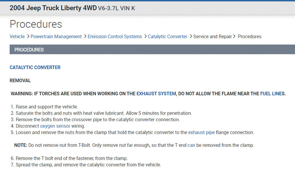

The T bolts are on the V clamps. The clamps wrap around the two flanges with the donut in the middle and use a bolt to tighten down. The OE ones use a T bolt, aftermarket ones use T bolts or have welded on bolts. Both work.

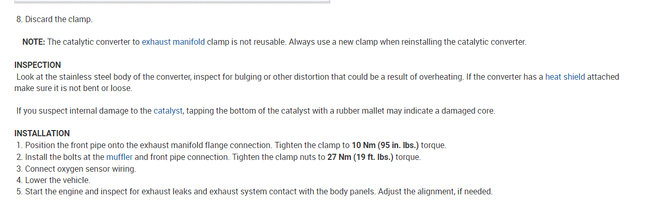

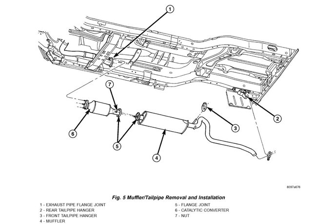

Thanks and I definitely will. I need to get all those parts out of my entryway anyways so I'm thinking of possibly doing it myself soon. I have an 02 sensor removal tool I have the sensors cuz that one is welded to flex pipe. I have all the clamps and all brand new parts even if it takes me half a day it can't be that hard. I know I can do it I remember changing a muffler on a Renault Alliance I had back in the day! Thanks for being patient with me!!! NY trip went good! Next trip I hope I have an inspection and emissions appointment.
May 12, 2021 at 2:28 PM
  • 110,248 POSTS
I'm glad to hear everything went well. I'm sure you're happy to be home. LOL

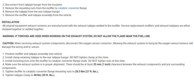

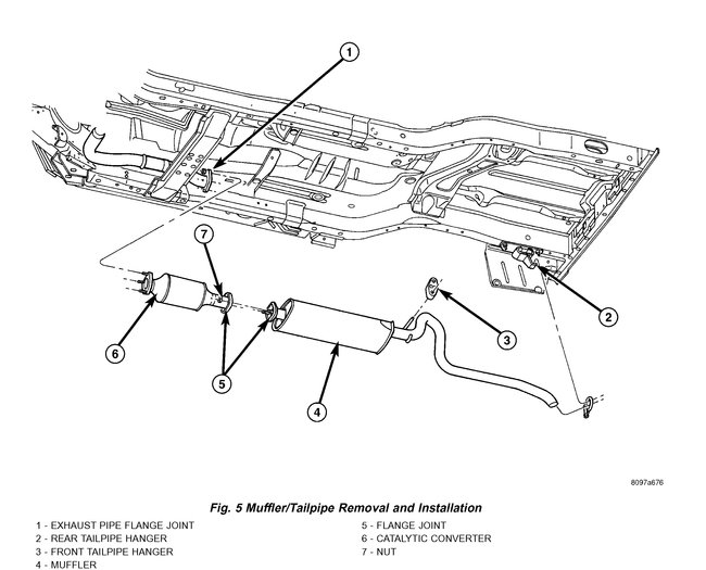

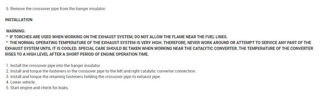

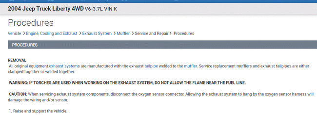

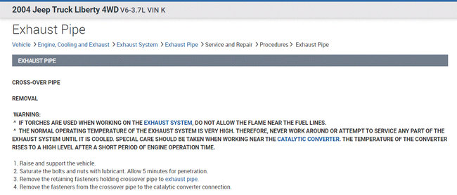

I don't know if you need them, but I attached directions below for different parts of the exhaust system. I hope they help.
Take care and let me know if you have other questions.
May 14, 2021 at 1:15 PM

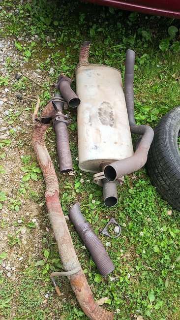

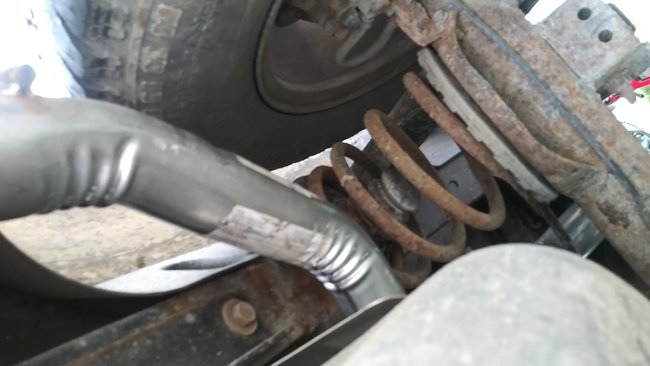

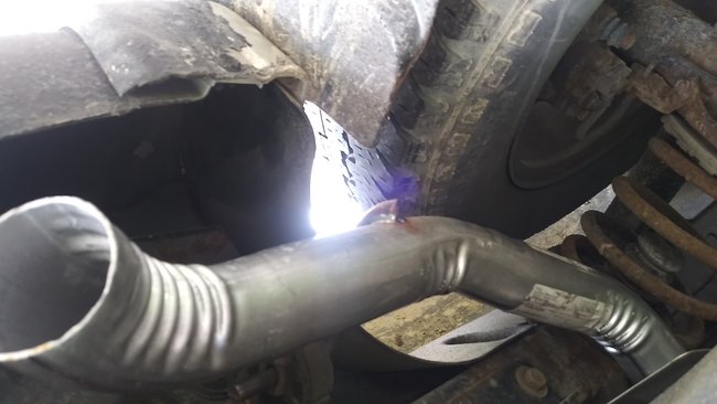

Hello, well the hard part is over I think! What a mess. Plus jack stands and blocks of wood really can't take the place of a lift and air tools. 4 hours non-stop and tomorrow the new will go on... I just wanted to show you the mess I was working with. I'm assuming that was the hard part. I hope it was, lol.
Jun 8, 2021 at 8:23 AM
  • 110,248 POSTS
It doesn't look like it was in very good condition. LOL. That is the worst part because of the rusted parts and bolts. The new parts will be much easier to install.

Looks typical of a NY exhaust system after a few years.

Thank you. Yes, I jacked it up and put pieces of wood under the front tires and jack stands on both sides underneath and then I let the jack down. You can never be too careful. Yeah I knew it was a mess. I was able to save the upstream O2 sensors. The other two welded to the pipes are getting tossed with the pipe.The guy I bought it from buys and flips cars. There's still a right way to do wrong. I know they sell different size flex pipe so i don't know why he even put it on because even with the clamps he had on there was about 1/2 in gap so it wasn't sealed anyways. Oh yeah I knew it was a mess that's why I dreaded starting it. The original V clamps were still on there. My reciprocating saw sure helped, lol.Thank you as always and I'll post more tomorrow afternoon. Have a good night!

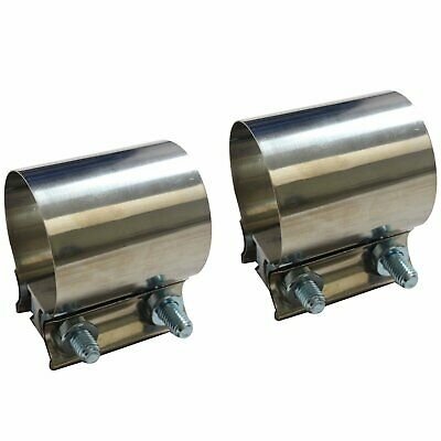

KLHUDOCK64
  • 91 POSTS

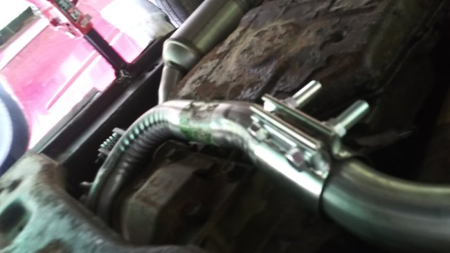

Oh boy. So I ordered one smaller butt clamp. I can't remember which part but it's behind the catalytic converters and y oioe but the clamp just won't tighten down any further. The pipe isn't going out it's in there but the clamp just slides around a bit do instead if a 2.25 in I have a 2.0 coming.I'm going back up to my friends garage even though I'm doing it outside of the garage. There's more light outside. I'm going to have her help me hang it. It just seems there's no room under there at all now. I'm wondering if those old parts were even the right year or vehicle. This exhaust takes up every inch of length under there..I tried to hang the back before I left last night but I was tired hungry and a little frustrated over my tire going flat. Tried putting air in it the valve stem is bad so Im going to have to take it off and take it to the repair place. I worked a midnight to noon ran up there until I had to go back to work from 6pm to 9pm ran up and it was just too dark to see how in the heck I can hang the back. It's been a learning experience for sure but it looks so nice. I'll post pics when I get up there after noon I'm still at my midnight to noon shift. Maybe so shouldn't have tightened everything up so well before I tried hanging it. Thanks again..

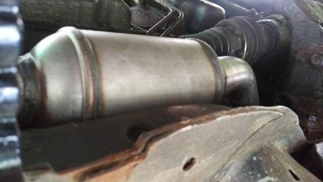

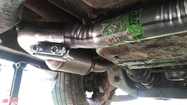

KLHUDOCK64
  • 91 POSTS

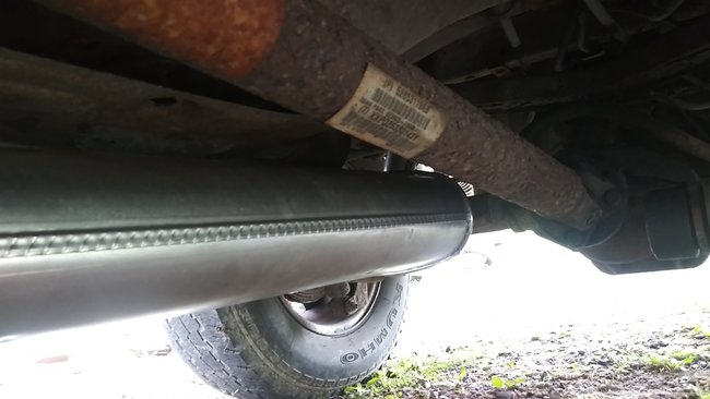

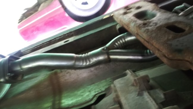

Done. Except for the one smaller diameter clamp I got under there and couldn't see or feel any leaks except drivers converter to y pipe..That new pipe smell though. I'll drive it fir swhile then get under there in a werk see if I csn tighten it down. It's very pretty and shiny under there. I will post pics in a few hrs omw to work.

They aren't the greatest, but here they are:
Jun 10, 2021 at 11:48 AM
  • 110,248 POSTS
It looks great! Good job. As far as the smell, there are stickers and oil on several of the components to identify part numbers and prevent rust. That smell should go away.
Now for the clamp, I'm not sure how you got a 2" one on in place of a 2.25". Usually, they won't fit around the pipe. As far as tightening, just make sure nothing can move. Torque is done using a special tool called a torque wrench. Most people don't own one.

I'm not sure I can get that 2.0 clamp on when it gets here either. The 2.25 band clamp aka butt clamp aka coupler clamp just seems big and it's sliding around. The pipes are together real good but when I started the vehicle and crawled back under it that was the only place I could feel air coming out of and I'm pretty sure it was a 2 25 like the other. It just will not tighten down enough so it doesn't move around. Maybe the manufacturer sent the wrong size? I'm not sure I have a 2.0 coming maybe I should have ordered a different 2.25. Thanks. It was not as hard as it seemed. Your written step by step instructions worked better than anything. The pics helped with the placement of the exhaust gaskets/donuts. Thank you so much I could not have done it without your guidance. Thanks again have a great night. I have a few more projects I'll start new threads. Take care.
