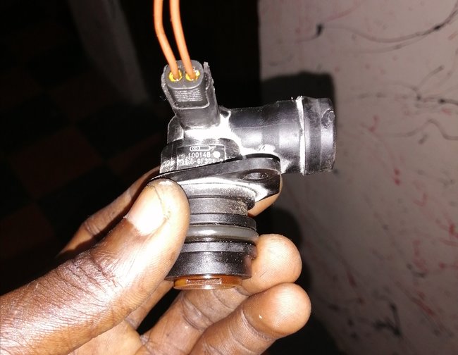

I changed the engine and once it put into the car it started and stop. When i checked the where no injection pluse and no spark then i scan the car and it gave error code p0335 which is crankshaft sensor. I changed the sensor with about four others sensors and even one brought out of a working vehicle still the same. I reset the ECU from the dashboard and then got spark but it still won't start and still giving error code p0335. I have checked for shot to ground and got nothing.

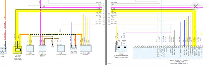

Yes, it is for the sensor system. According to the possibilities, it is an electrical issue in the harness between the 3 wires for the sensor.
https://www.2carpros.com/articles/how-a-crank-shaft-angle-sensor-works
I attached a diagram for you to view. I would go over your work and make sure there is no harness pinched anywhere causing this issue.

I checked the signal wire for short to positive or ground and it was not.
Can bad plugs trigger that error code.
Can the can the crankshaft signal plate also trigger the code.
Am seriously confuse on where the problem and solution lies.
The engine crank and I have used a multi-meter to check voltage at the socket and with key on there is 12v pin1 orange wire, 5v pin 3 yellow wire and pin 2 is through to ground.
I have inspected the wires to the sensor and no cut where found.
At first when the engine was inserted it crank and started for some seconds then cut off. When I tried it again I noticed there was no spark to coil and no pulse to injector. I found a fuse was bad and replaced it and got.

How can i test the angle connector sensor below?
Aug 28, 2020 at 10:34 AM

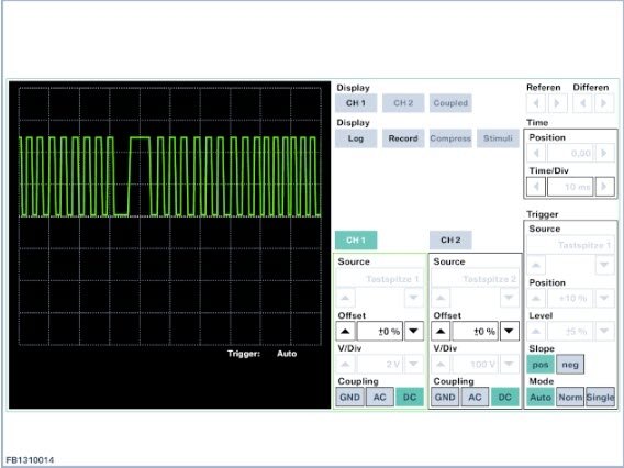

You would need a scope to watch the pattern of the signal when it runs across the tone ring.

More than likely the issue is with that tone ring! Inspect while someone else cranks the engine. I've attached an image of what the pattern should look like.
