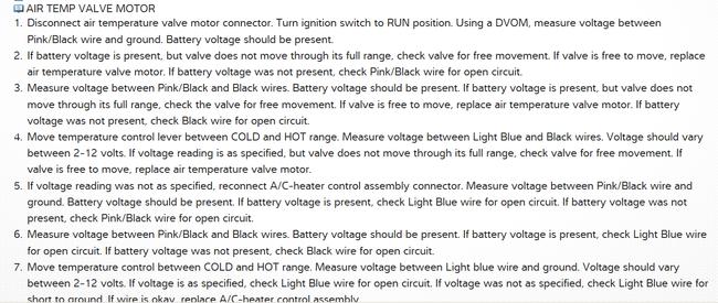

Trying to show my 16 year old how to work in his car. Its a 91 Buick Regal GS. The ac/heat barely blows out of the vents, but is coming out of all of them. This is not the dual temp type. The blower works great. The controls do no change the air flow. All vacuum actuators work fine. Disassebled the dash and watched each one cycle. However the electric blend door actuator was not working. Bought a new one and replaced it, but still not actuating. I did check the door with the actuator off, and it worked without a glitch. What powers the electric actuator? Are there any relays or fuses I may have missed? Is the electric actuator controlled at all by the vacuum manifold which powers the vacuum actuators.? Studied the chiltons, and everything I could find in every buick forums, gm forums etc. I now know waaaay more than I ever wanted to about blend door actuators, etc. But still no answer. We live in Wasilla, Alaska and it is getting cold out. At this point I'm tempted to remove the actuator and wire the blend door open, (although I dislike this kind of fix) just so he doesn't freeze on the way to school and work. Any info or help would be appreciated. I feel like I'm letting him down not being able to figure this out. Plus his car is being parked in my garage because of no heat, and I want my spot back. :) Thank you very much.

you actually don't have a blend motor you have what is called an air temp valve motor which power is sent through the light blue wire to it. That leads to the blower motor switch which powers both of the blower an d temp valve. it is controlled by the ecm so you either have a bad motor or connection and or maybe even the ecm . I'd have a pro search it out for you there also is a resistor in the wire that eh air temp motor connects to probably for reduced voltage. I'm sending along on how to check air temp motor.

I apologize. I'm still a bit confused. The wiring diagram that I have is for a 92 regal and does call it the air temp valve motor. Is this the same as a 91 without the automatic temperature control unit, just the manual one? When I bought the replacement part it was labeled Dorman blend door actuator. All the other info I read called it that also, including the heater breakdown diagram. I'm sure I'm just mixing terminology. I'm just trying to clear this up to be sure the tests you sent were the same for either one. Yes, the connector does have the light blue-black-pink/black wires on the connector. Thanks again.

what I sent is for a 91 buick regal
