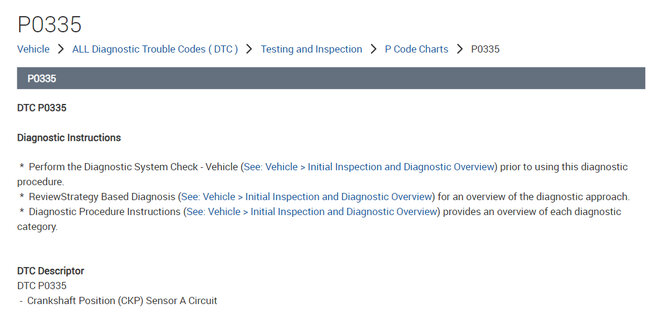

2 things. The plug or the gasket at the bottom of the map sensor was stuck and it went down inside of where it attaches to rather than coming out. I've read that that isn't an issue, is that correct? Could that still be causing the problem? My next question is P0335 is for the sensor itself. The crankshaft sensor. P0336 is for crankshaft performance. What should I do next? I need to fix this car. It seems every time I fix one thing another thing comes up.

What symptoms are you experiencing? As far as the MAP sensor grommet, I believe that would drop into the intake manifold. If that is the case, it could cause issues.

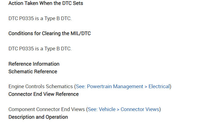

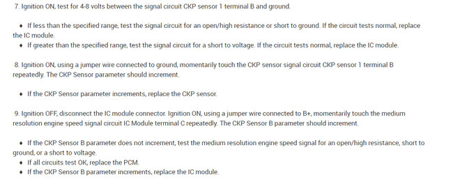

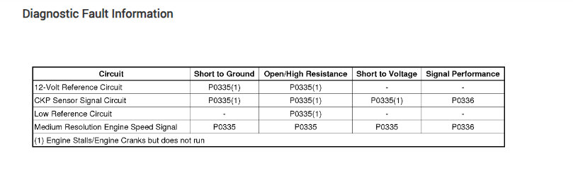

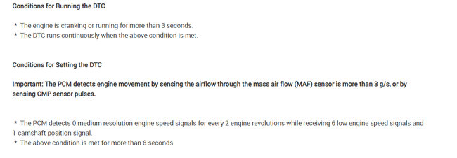

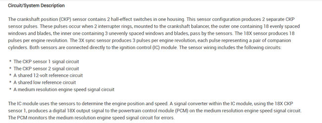

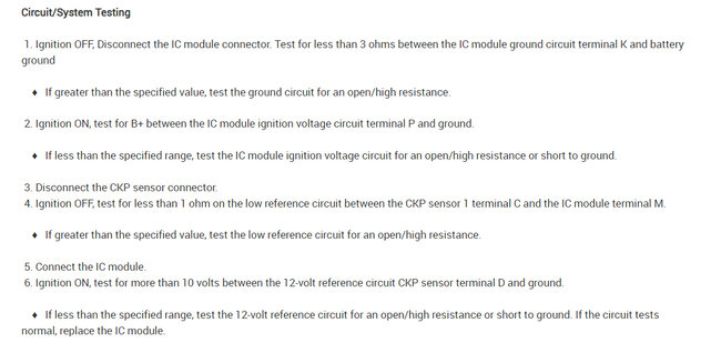

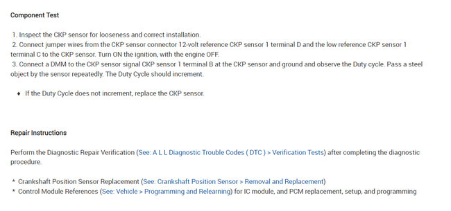

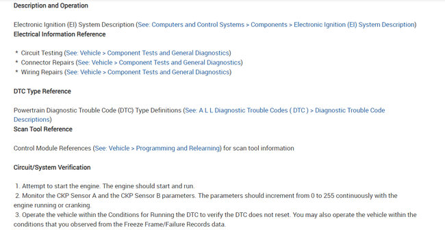

The two codes you have are related, as you mentioned. I feel the 136 is a result of the 135 code. I attached diagnostics below. Take a look through them and let me know if you are comfortable performing them.
