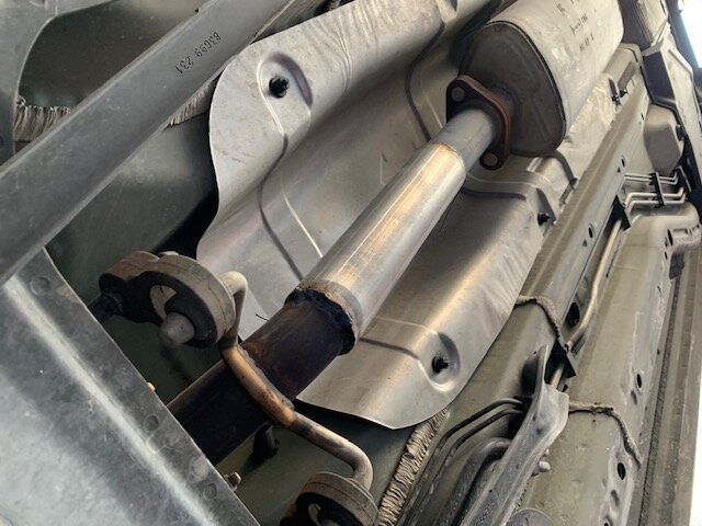

Do me a favor. Take a couple of how the straight pipe was installed and upload it for me to see. I will try to figure out how we can get it taken care of with a universal converter that is much less expensive, and I'll explain how to do it yourself. Maybe your son will help as well.

Hi Joe, I have not been in contact with the shop that did this, it was not a dealership. I wanted to go the day i found out what they did but my son advised me to take a few days, do some research, then take it from there. I will attach a photo of the straight pipe work and a pic of the invoice. The shop I took it to had a look at the invoice and said it should have a part number? My registration expired yesterday, but I was able to get a 10 day move permit from the DMV, so it buys me some time before I figure out my next steps. Thank you so much for your help so far. I am so angry and sad.

Wow!!! I would be livid!!! Did they charge $1,170.00 for the converter that doesn't even exist?
You know, I am questioning if they did it. The check engine light should have turned on almost immediately. If it took a year, that doesn't make sense.
I'm not sure, but it is possible that it was stolen, and someone did that, so it wasn't noticeable right away. I'm near Pittsburgh, and I can't tell you how many people have had them stolen.
However, it appears to be welded in place. Ugh! I wish I was there to see it.
Let me know if there is anything I can do to help.

I’m pretty sure if someone stole it, they wouldn’t have time, or the tools, to weld on a pipe. They would have to lift my car and no way they had time to do that without someone seeing them. Do you think the mechanic at the shop could rig it so the engine light wouldn’t turn on for long enough for them to be able to deny stealing it?

I agree about the welding. I thought it was but wasn't 100% sure looking at the pic. As far as the light is concerned, I'm not sure how they would have bypassed that to be off this long.

Hi Joe! I’m at work so this will be a quick message, I’ll get you details when I can. My son and I took my car to the place that stole my cat, and they are busted! Liars and thieves is what that are. So I’m going to another shop to replace my cat and I’m going after the other guys some how. I have many options but my main goal is to make them pay. Yay!
