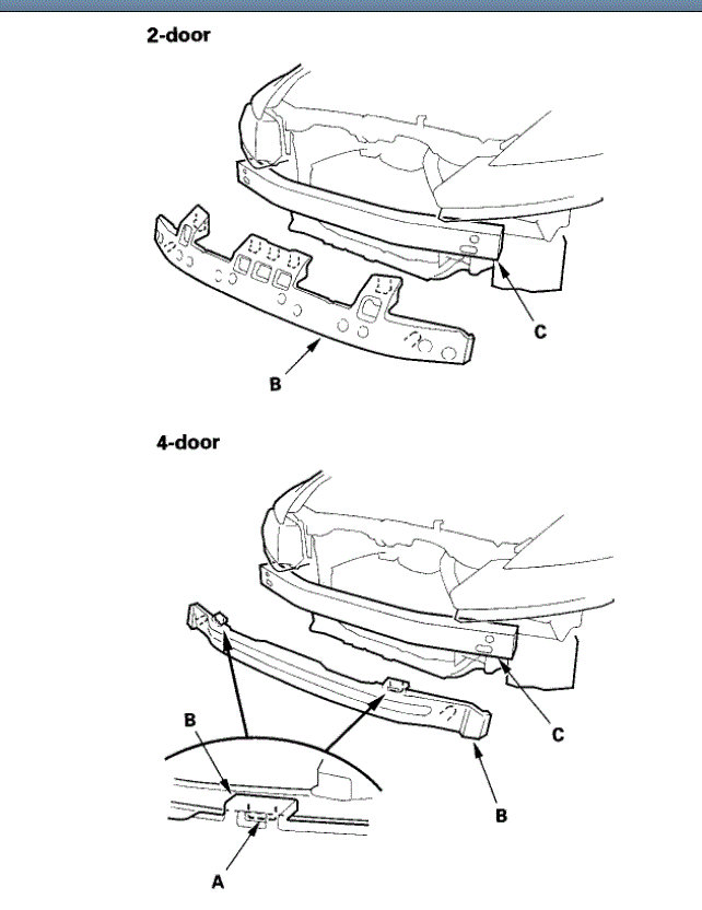

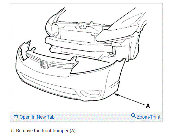

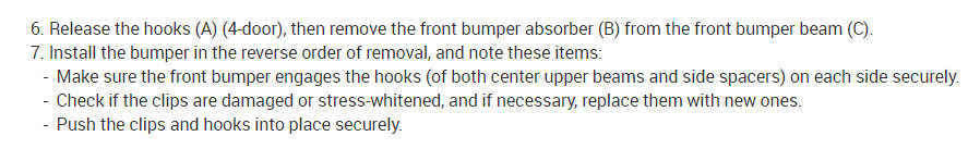

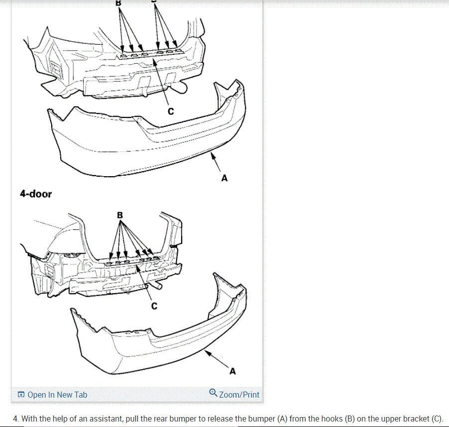

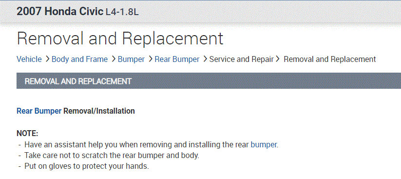

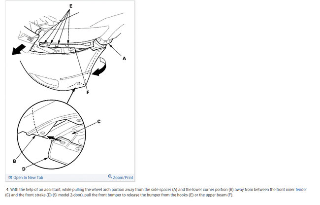

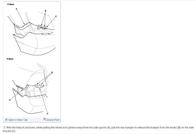

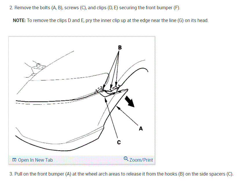

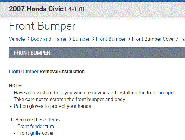

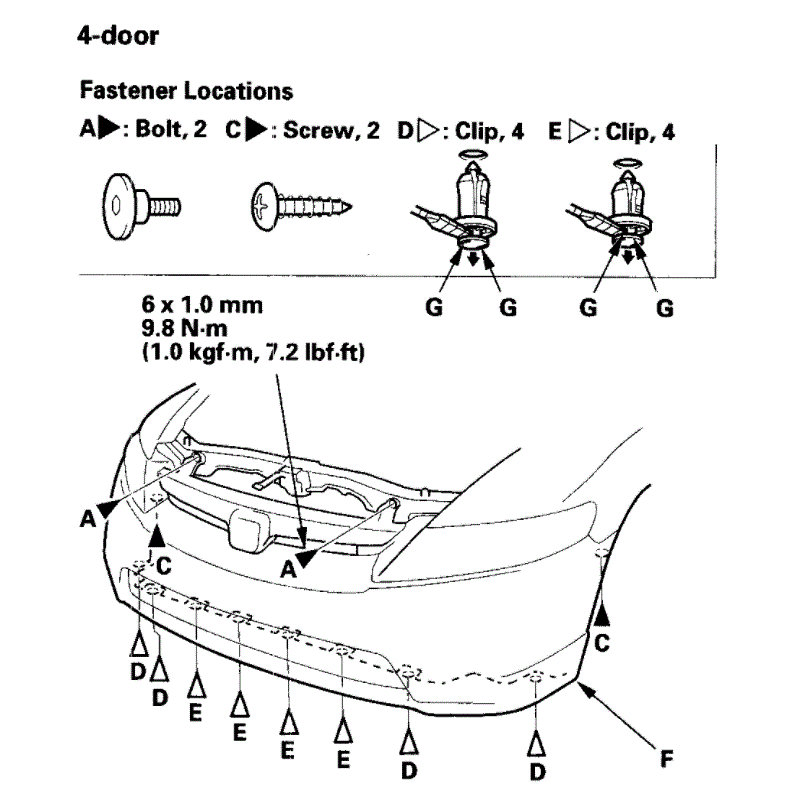

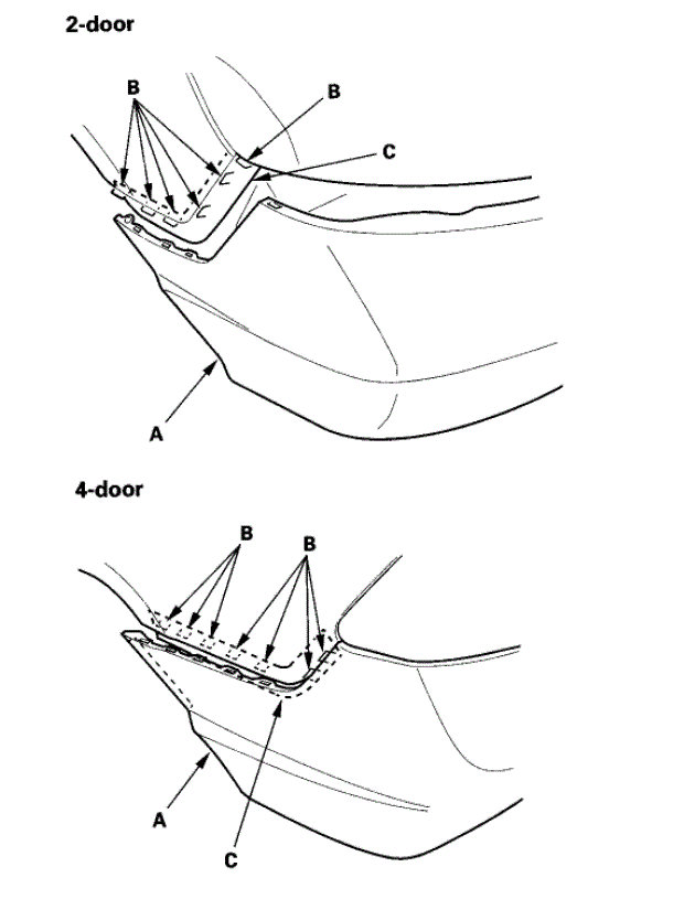

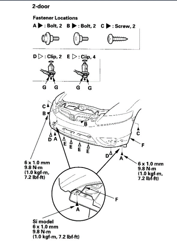

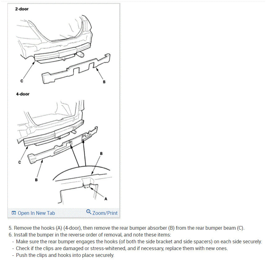

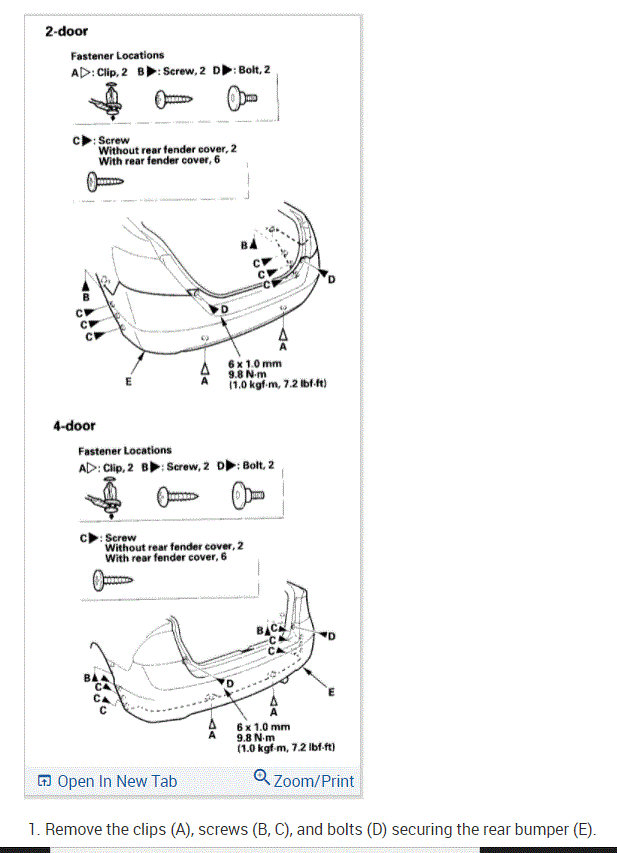

I attached the directions below for the removal and replacement of the front and rear covers.
