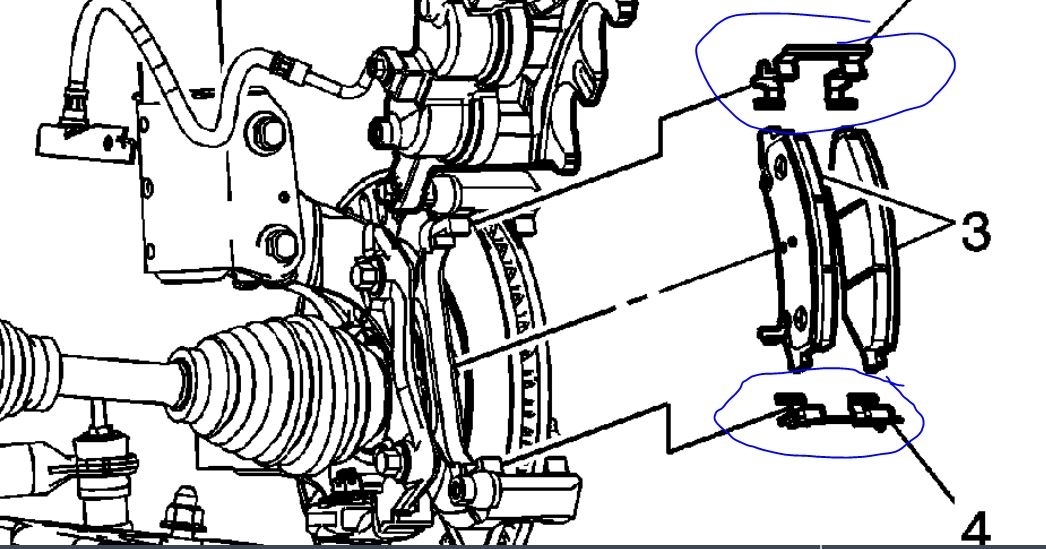

I replaced the front rotors and pads on my car and they have been squealing for a few months and when i apply pressure to the brakes they stop squealing. What should i do to fix this?

I bought some nice Duralast brakes and i only replaced the pads and rotors.
Mar 29, 2021 at 5:28 AM

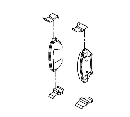

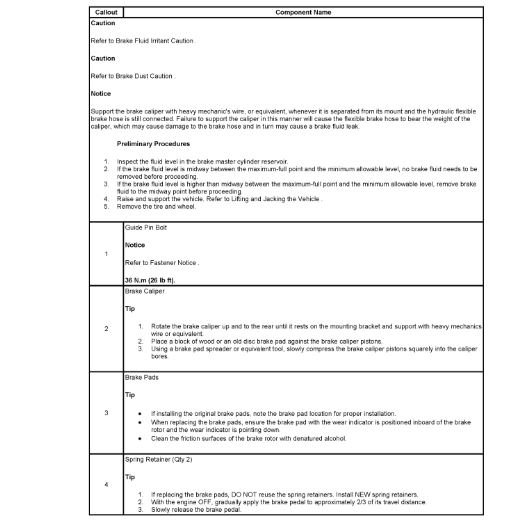

The hardware is mandatory to keep the pads stable.
I would get the hardware kit and install them on the pads.
1. Remove the disc brake caliper from the caliper mounting bracket.
2. Remove the disc brake pads from the caliper mounting bracket.
3. Inspect the disc brake pad mounting hardware for the following:
Missing mounting hardware
Excessive corrosion
Bent mounting tabs
Looseness at the caliper mounting bracket
Looseness at the disc brake pads
