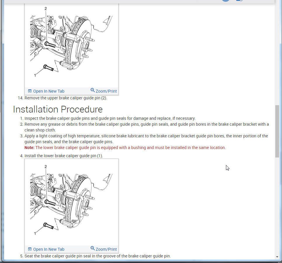

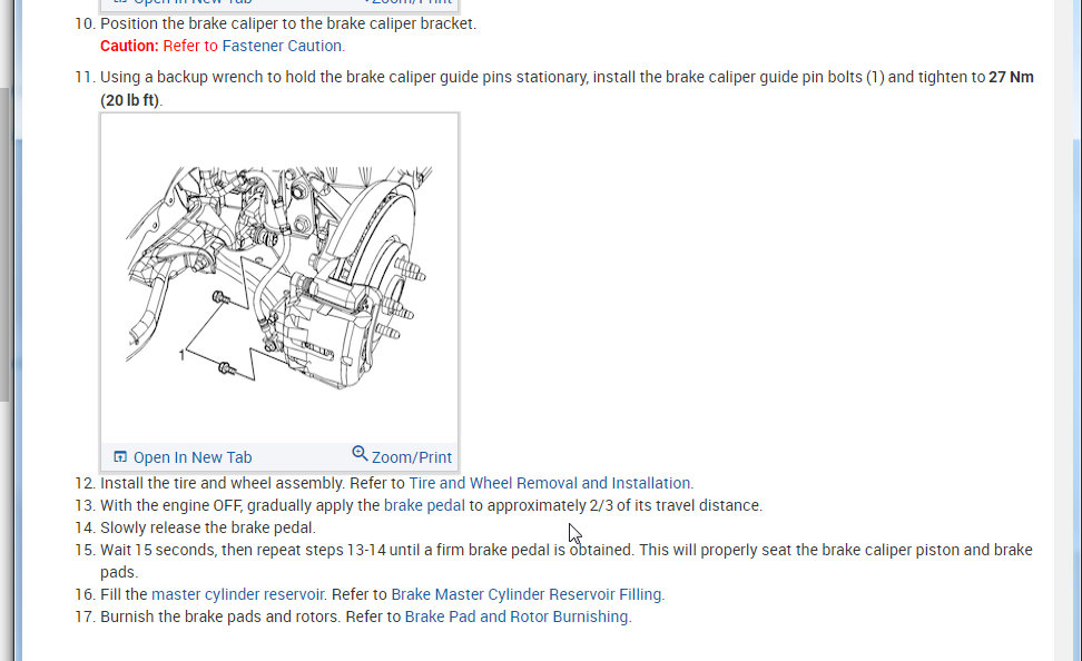

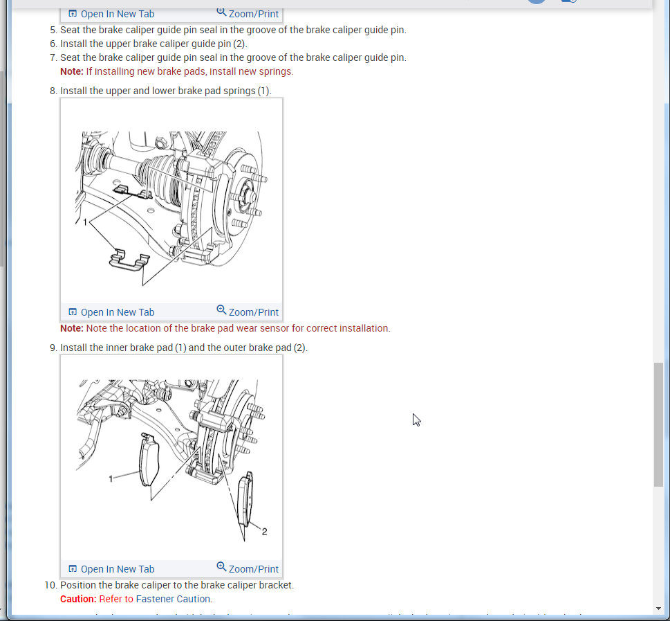

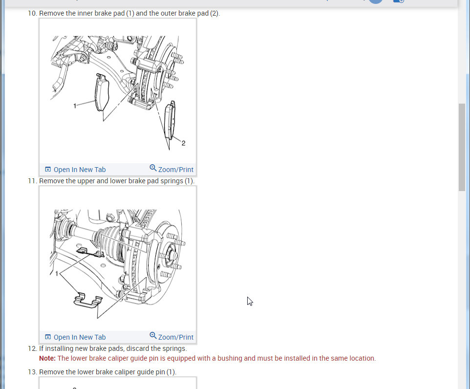

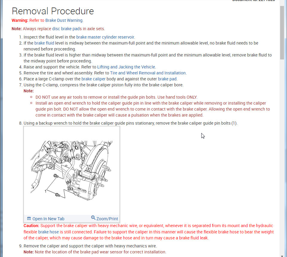

Here is a guide that will help with replacing them as I suspect they are going to need to be replaced:
Below is the process on how to replace the pads and rotors on this vehicle.
Let's run through this material and let us know if you have questions. Thanks
