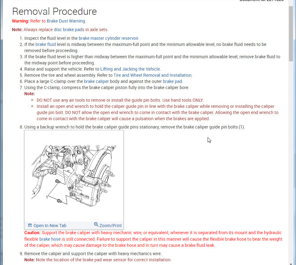

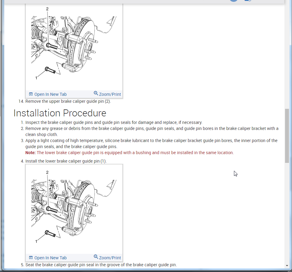

Just had brakes done when I apply light pressure around 20 mph I hear a rubbing as if the rotors not true. I opened the window and hear a definite rattling noise. On my way to get the parts can you help me?
Mar 27, 2019 at 12:39 PM

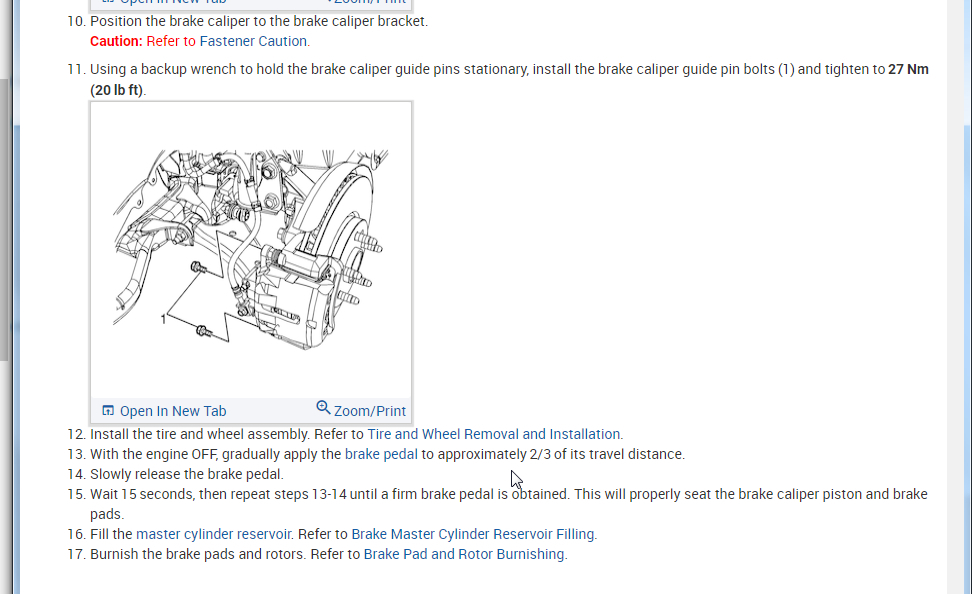

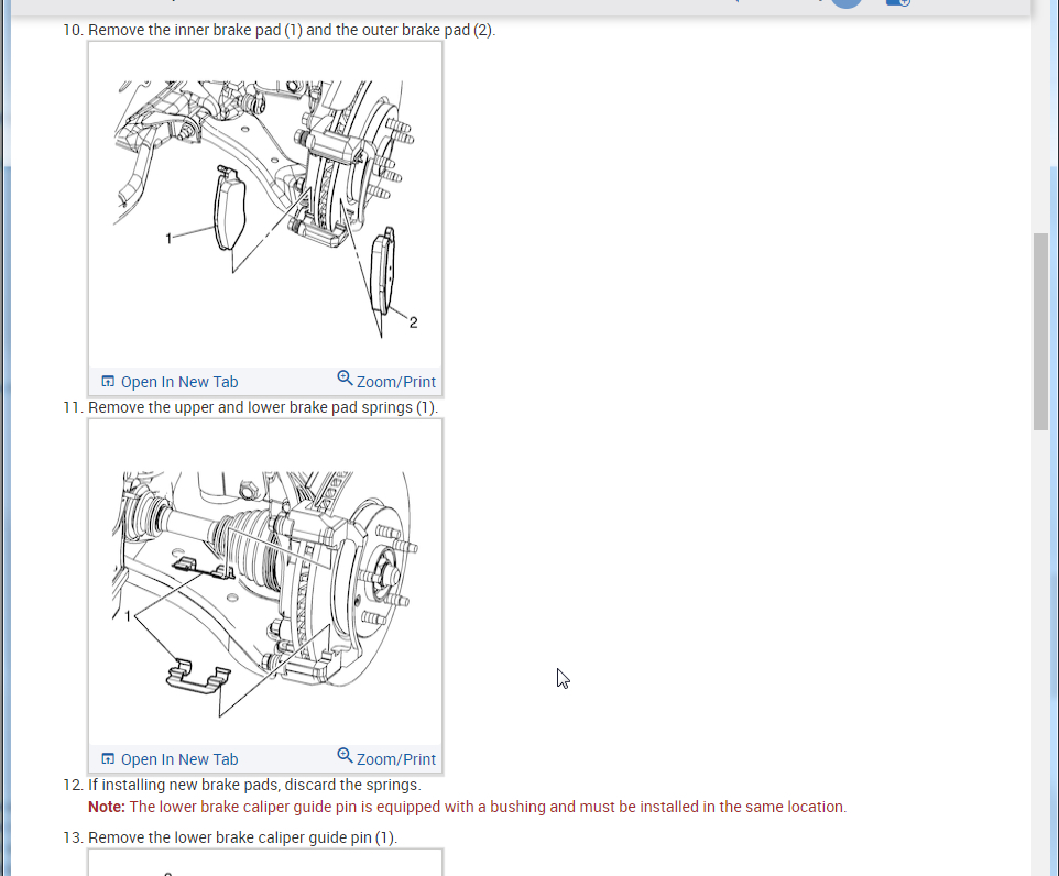

More then likely they just need to be replaced. I would suggest removing the wheels and inspecting the brakes.

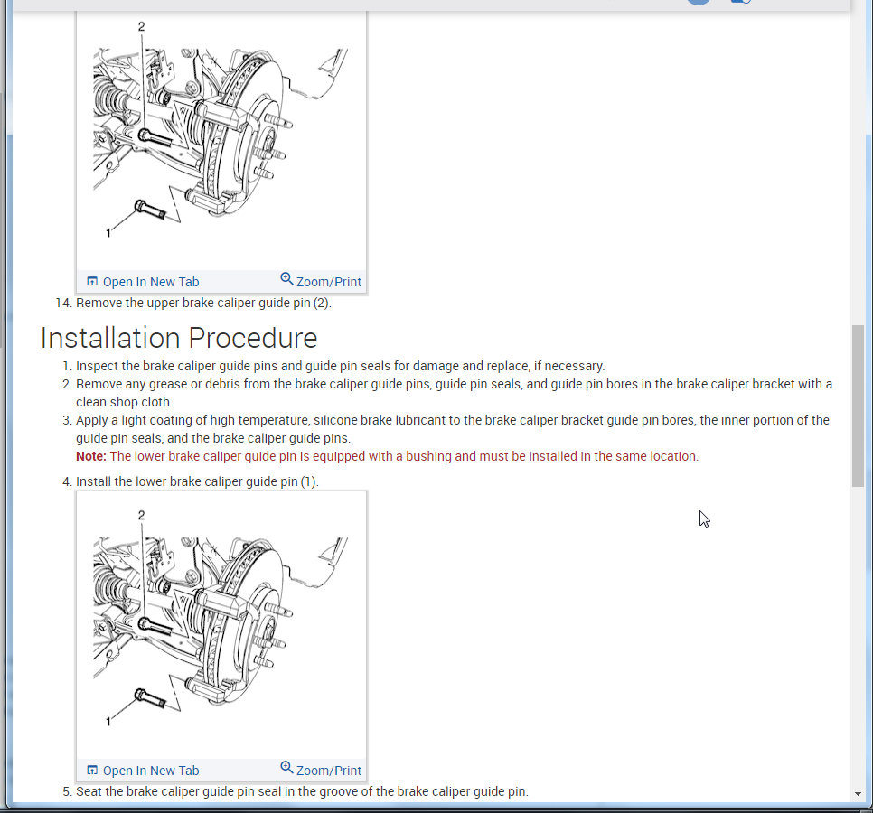

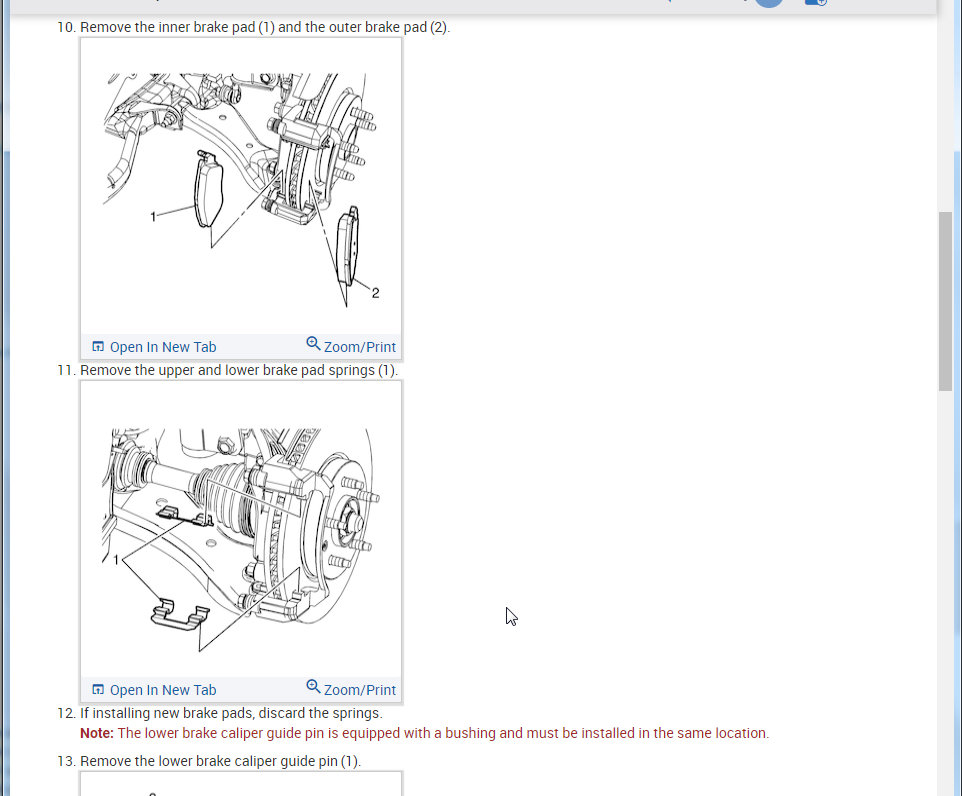

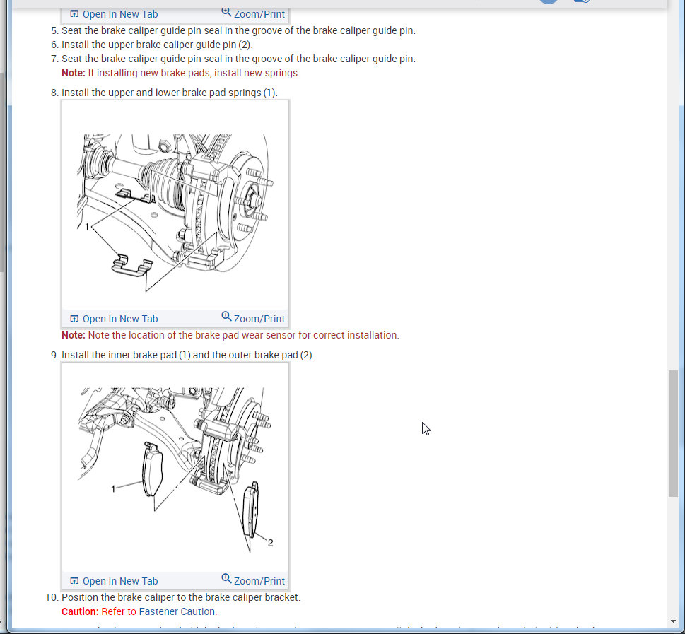

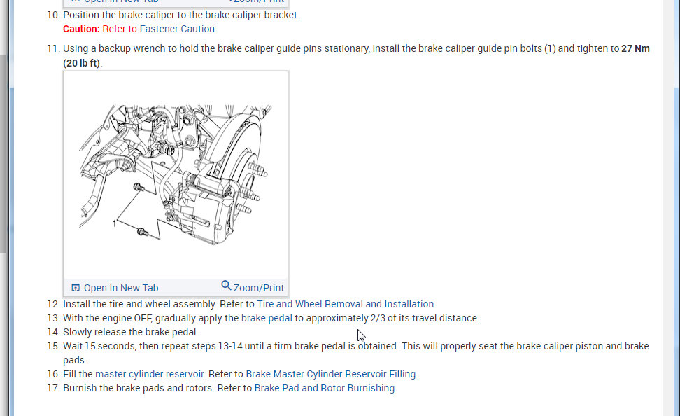

Here is a guide that will help with replacing them as I suspect they are going to need to be replaced:
Below is the process on how to replace the pads and rotors on this vehicle.
Let's run through this material and let us know if you have questions. Thanks
