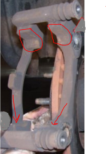

Very good to know. Certainly, something I hadn’t heard anywhere else before. I just recently had my brake lines and one of my calipers replaced when I ran into an issue with a seized caliper on my passenger side drive wheel. Terrified me because I thought immediately, I was having transmission issues and I know how expensive that work can be, and frankly my car isn’t worth sinking a ton of money into. Anyways, the shop mentioned how bad the degradation on my brake pads and rotors were, I can’t remember if I had ever taken a look at them in the ~6 years I’ve owned this car. But I’ve completed the first set of new rotors and pads, going to do the second set in the morning. I am curious though, when I placed in the back brake pad (or whichever one comes in direct contact with the caliper piston) the springy motion that I’ve seen other people achieve didn’t happen. I was able to put it in smoothly on the other side, but on that one side it seemed very stubborn and didn’t really move that well against its housing. I know some people use a small amount of grease in the channels, but I wasn’t sure if that was necessary.

Remove the caliper, pads that seem tight, and the hardware from the mount. Take a file and clean all corrosion off the mount where the pad will ultimately be seated. Once that is clean, I always put a thin coat of brake lube on the steel mount before installing the hardware. It slows the rusting process which will ultimately press against the hardware causing the brake pad to stick.
I attached a pic below showing the locations I'm referring to. Make sure the areas I indicated are clean and free of rust and corrosion.
I hope this helps.
See pic below.
