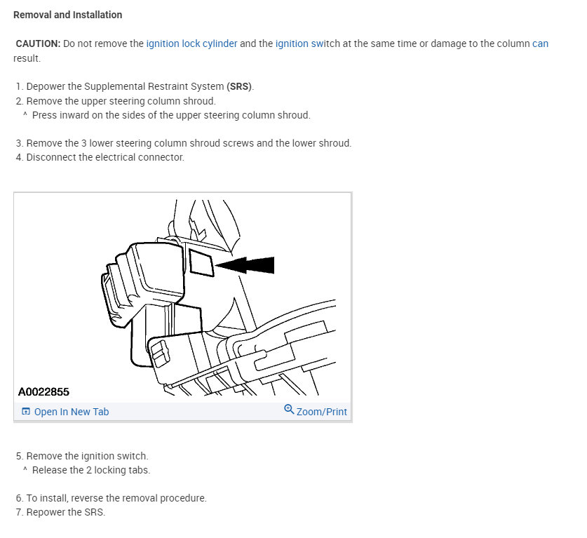

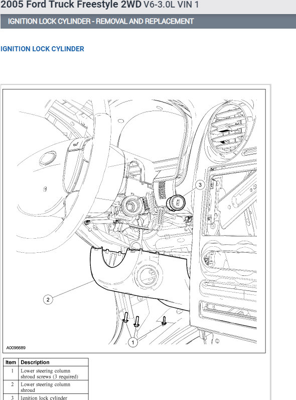

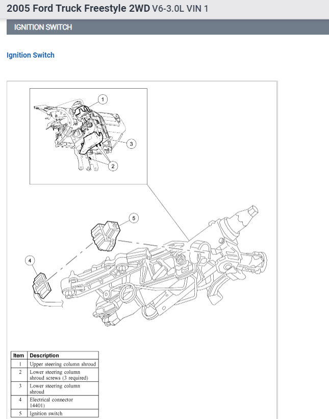

If you are not getting any clicks or any other noise while trying to start, it could be due to a bad ignition switch.
A worn-out ignition switch will be unable to make contact during the start and that can lead to no start and no noise.
Just to make sure, is your security light illuminated? A triggered security light will also prevent the vehicle from starting.
I have attached diagrams below for your reference.
Let me know of any questions.
