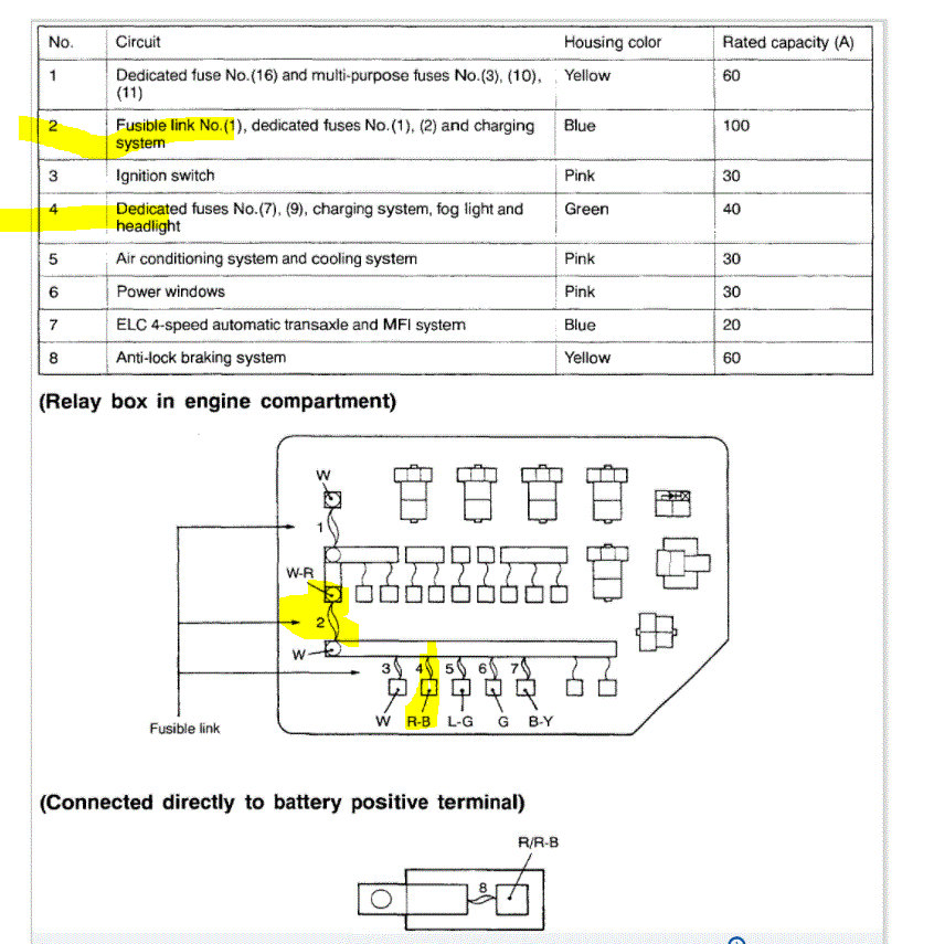

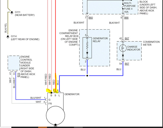

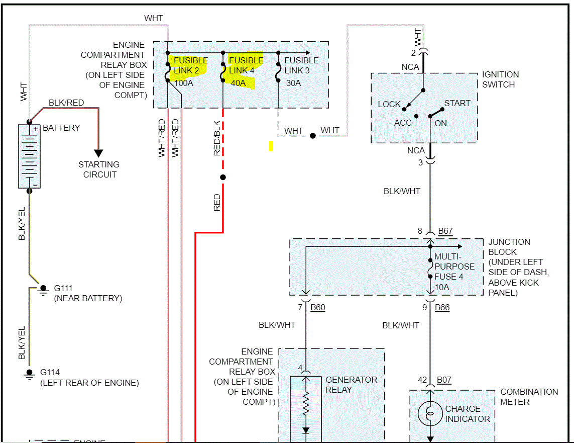

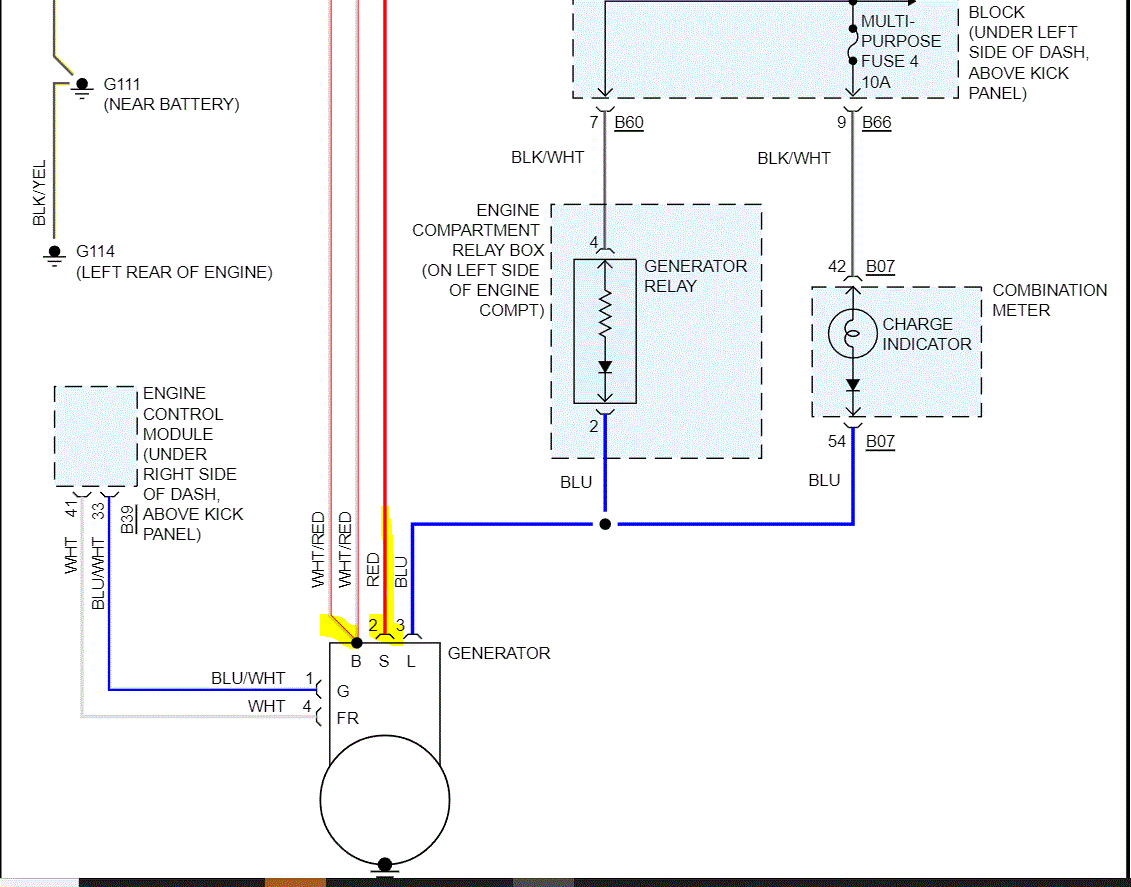

Replaced alternator. Replaced battery. Replaced both belts. But my car will not hold charge. If headlights are on battery drains quick. Lights dim. Car stalls at stops. SRS light comes on first then battery and check engine. Now heat stopped.

If you find it isn't charging, and it sounds like it isn't, then I need you to check for power at two points on the alternator itself.
If you look below, I attached the wiring schematic for the charging circuit. Note that both wires I'm having you check are power from fusible links. If one has failed and power can't reach the alternator, it won't charge.
The fusible links will be in the relay box in the engine compartment.
Check these and let me know what you find.
