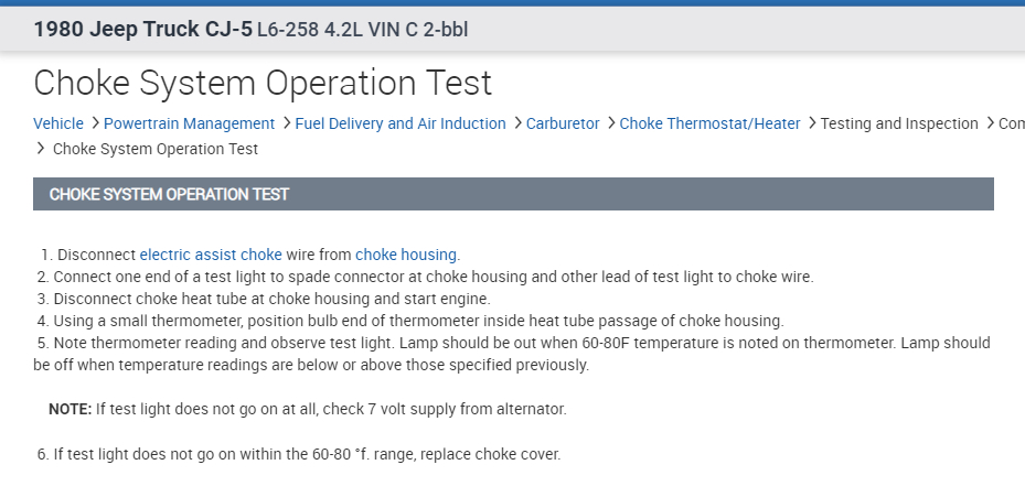

I am just wondering what should be done, preventively, to my new/old vehicle, if anything?
1980 JEEP CJ5
55,000 MILES • 4.2L • 6 CYL • 4WD • MANUAL
JB.LAMBERT
Brakes feel spongy, but not sure if that’s just “how they were”. If I don’t drive it every day, it won’t start in the first turn, but usually will on the 3rd. That’s all! Appreciate it!

Spongy brakes can be the result of a couple of things. Most commonly the rear drum brakes are out of adjustment, or the brake shoes are worn. I you look through this link, it explains how to replace rear brake shoes and drums. I'm not saying they need to be replaced, but the directions for adjusting them are incorporated in the directions.
https://www.2carpros.com/articles/how-to-replace-rear-brake-shoes-and-drums
What you described as far as starting is likely either the electric choke isn't working, out of adjustment, or if it sits long enough, the fuel in the float bowl can evaporate. If that happens, it takes some cranking for the mechanical fuel pump to refill the bowl.
If you want, I attached the directions below for testing the choke. Take a look through them and let me know if you are comfortable performing the directions. Also, we have a guy on here that knows these vehicles inside out. I'm hoping he jumps in if he has other ideas.

See pic below.
