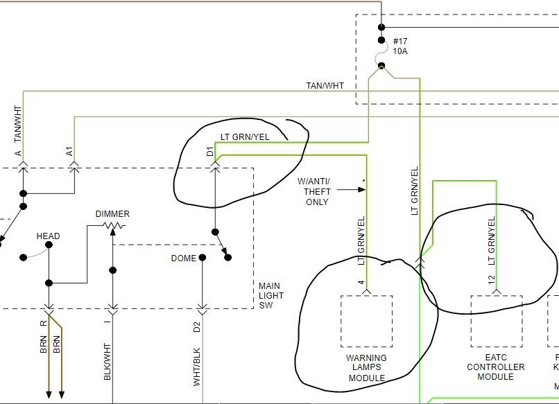

Thank you very much for your expert advice. I did the test light from neg post to the neg cable. The test light showed a bright light. I took out fuses one by one. The number 17 fuse under the dash was pulled and the test light went out. You said to check the components and it narrowed the problem to be passenger side power seat switch. I ordered one. If this doesn't solve the drain, I'll continue with the other components. You wouldn't happen to know of an electrical diagram for the number 17 fuse which involves: Anti-theft, Automatic temperature control, Courtesy lamps, Key-less entry, Memory seats, Power mirrors? My Haynes manual doesn't show anything. Thank you.
Jul 17, 2019 at 6:37 AM
Fuse 17 attached.
