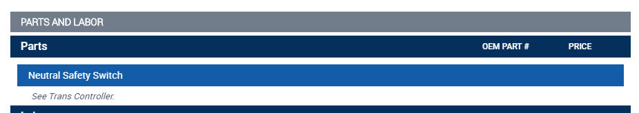

Just to keep this short and sweet. This is part of the transmission control module. Please see the parts list from AllData. Please let me know if you need information.

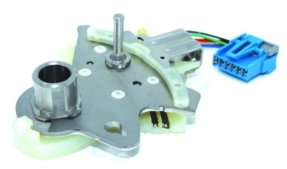

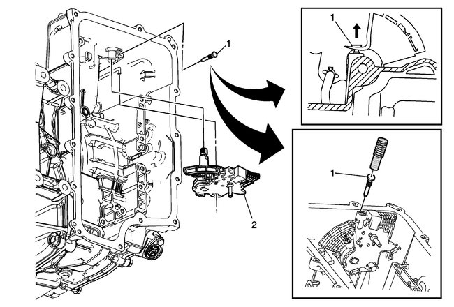

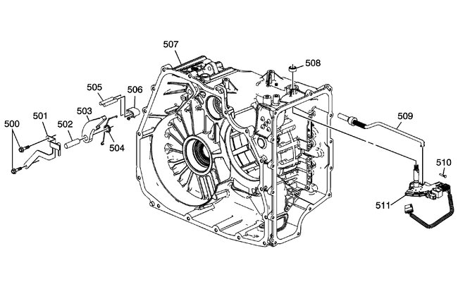

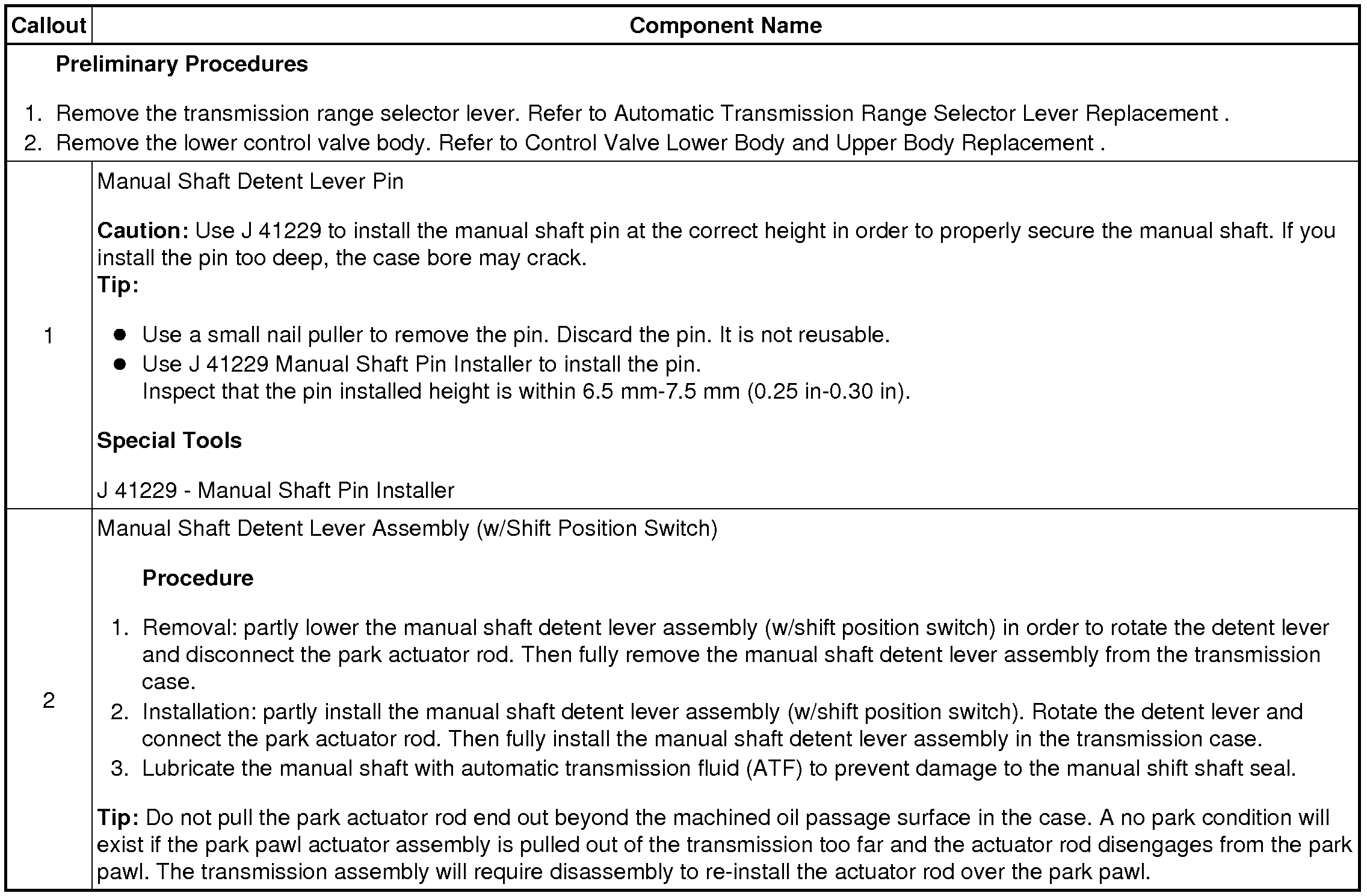

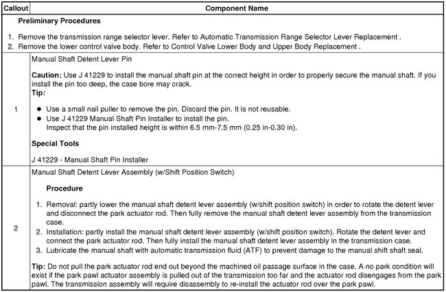

The neutral switch is part of the range sensor switch. It is inside the transmission behind the front cover on top of the valve body. However it would help to know what your problem is as the switches don't fail often. Car not starting in park and neutral or something else.
