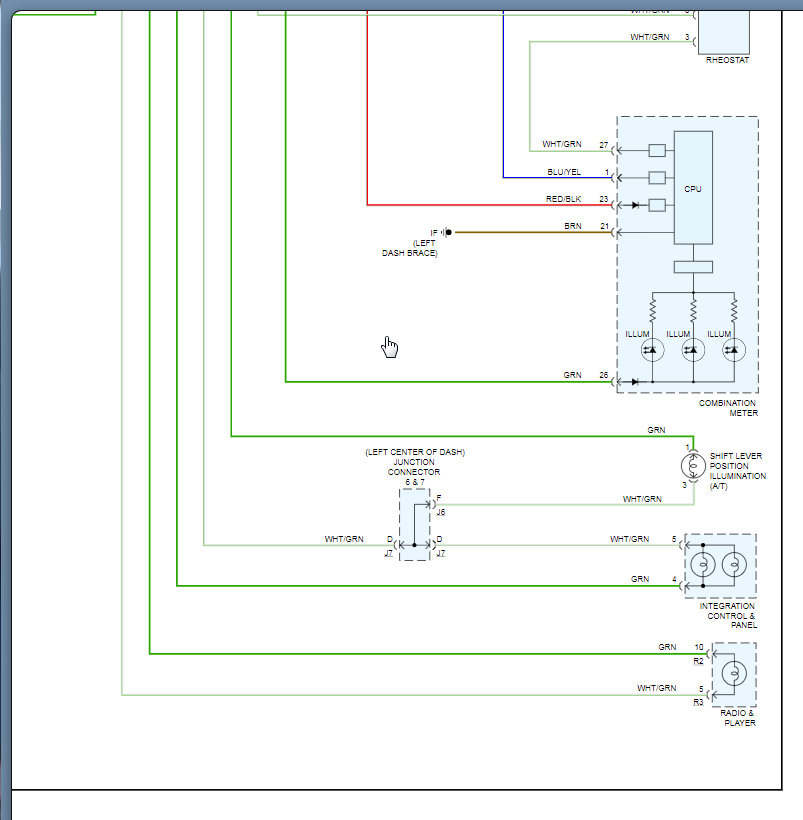

Only when the car warms up the Low gear light is dimly lit and car wont shift out from first to second when in drive...The PRND2L lights do not come on when driving only i already replaced the neutral safety switch and checked fluids which looks brand new the car drives like new when it's cold.
Dec 21, 2019 at 12:03 AM

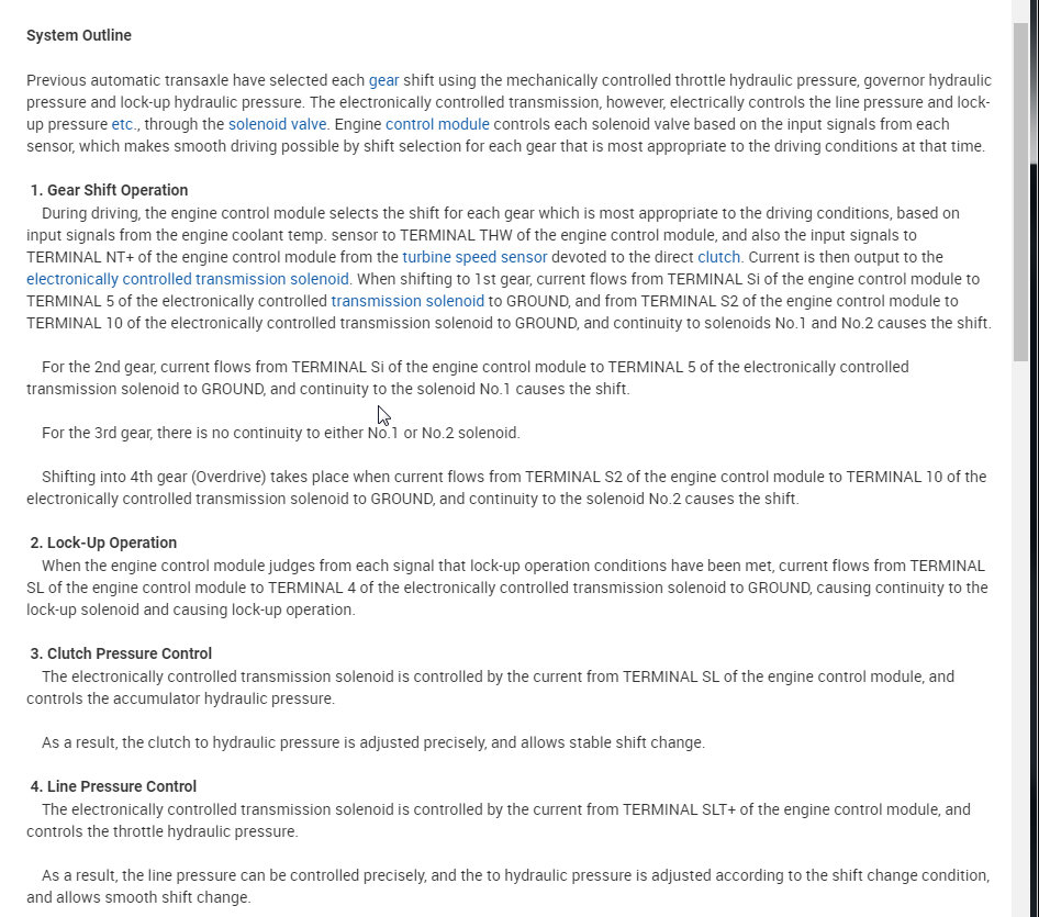

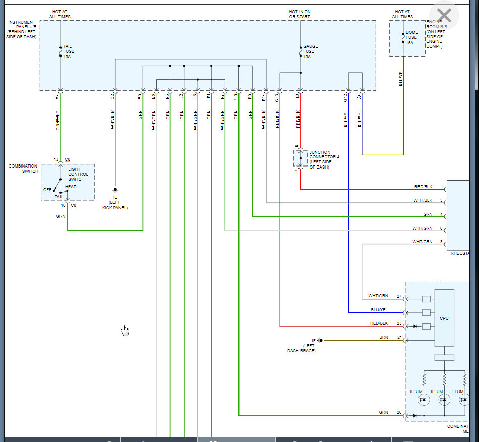

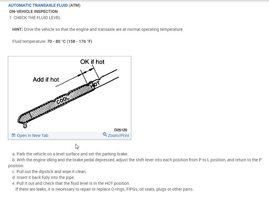

This does not sound like it is one issue. The shifter lights and not shifing are different issues. More than likely the lighting issue is just a bulb or wiring issue. However, the shifting is either a line pressure issue or transmission control issue. We need to start with checking the fluid.
I attached the needed info. Let me know what you find. If no issue is found then we need to scan for codes and see what it is telling us.

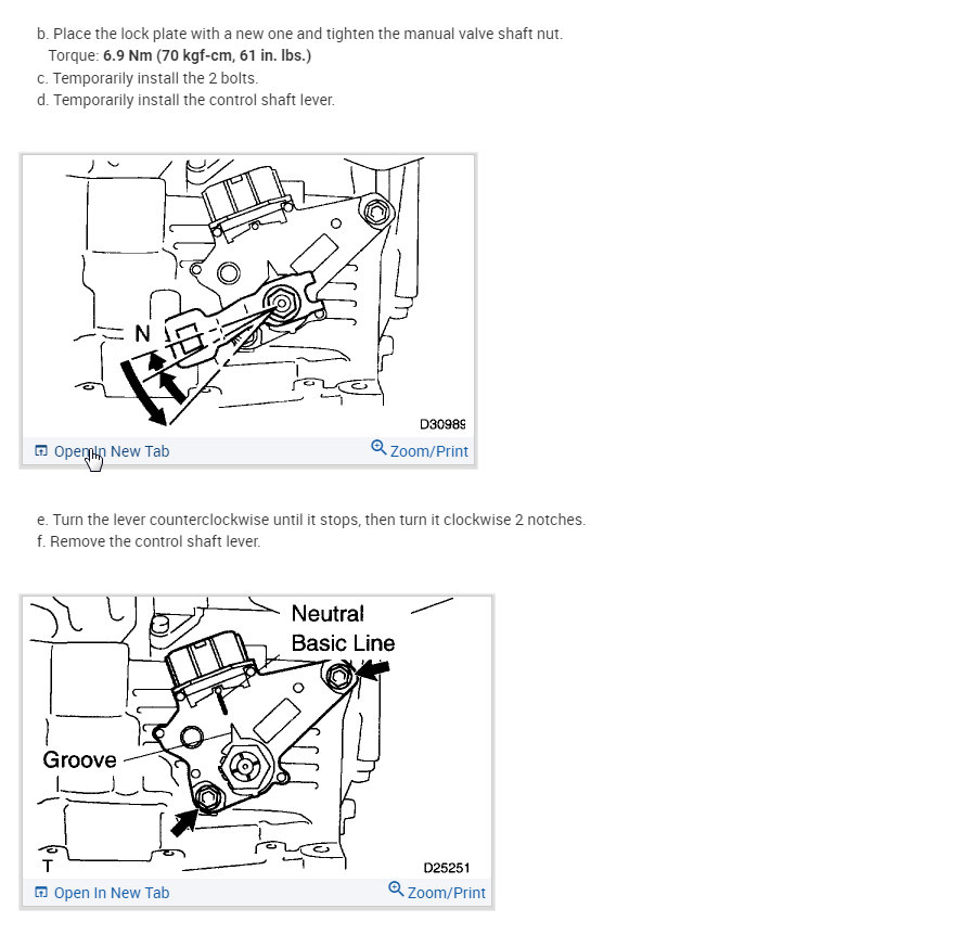

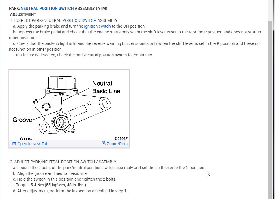

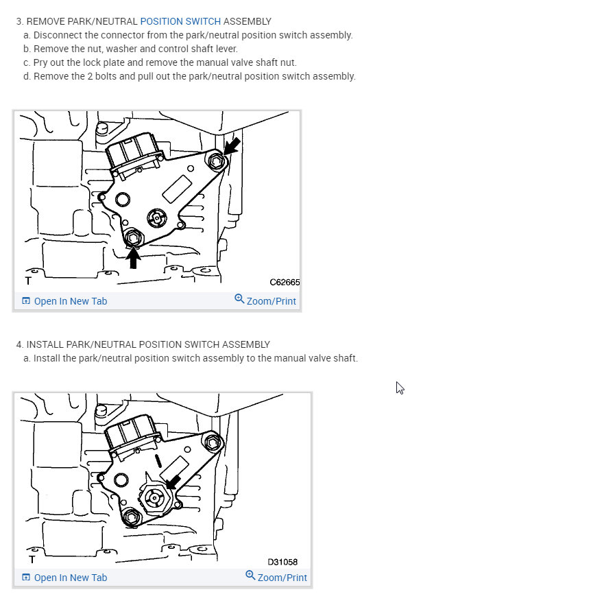

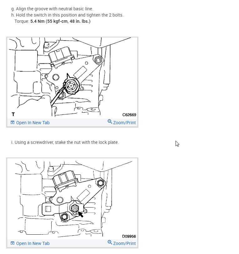

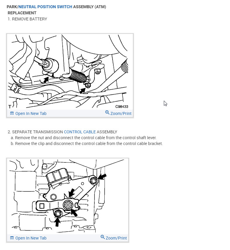

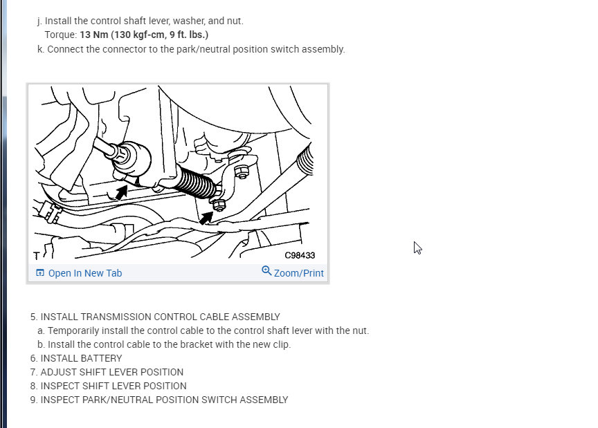

Okay. Did you use the locking plate when installing the park neutral switch? If not then you could be right that this is your issue. I don't think it is sending multiple signals. It is probably not sending the proper signal to tell it what gear it is in.
Here is the replacement procedure and the adjustment procedure. Run through this and let us know if there is any difference. Thanks
