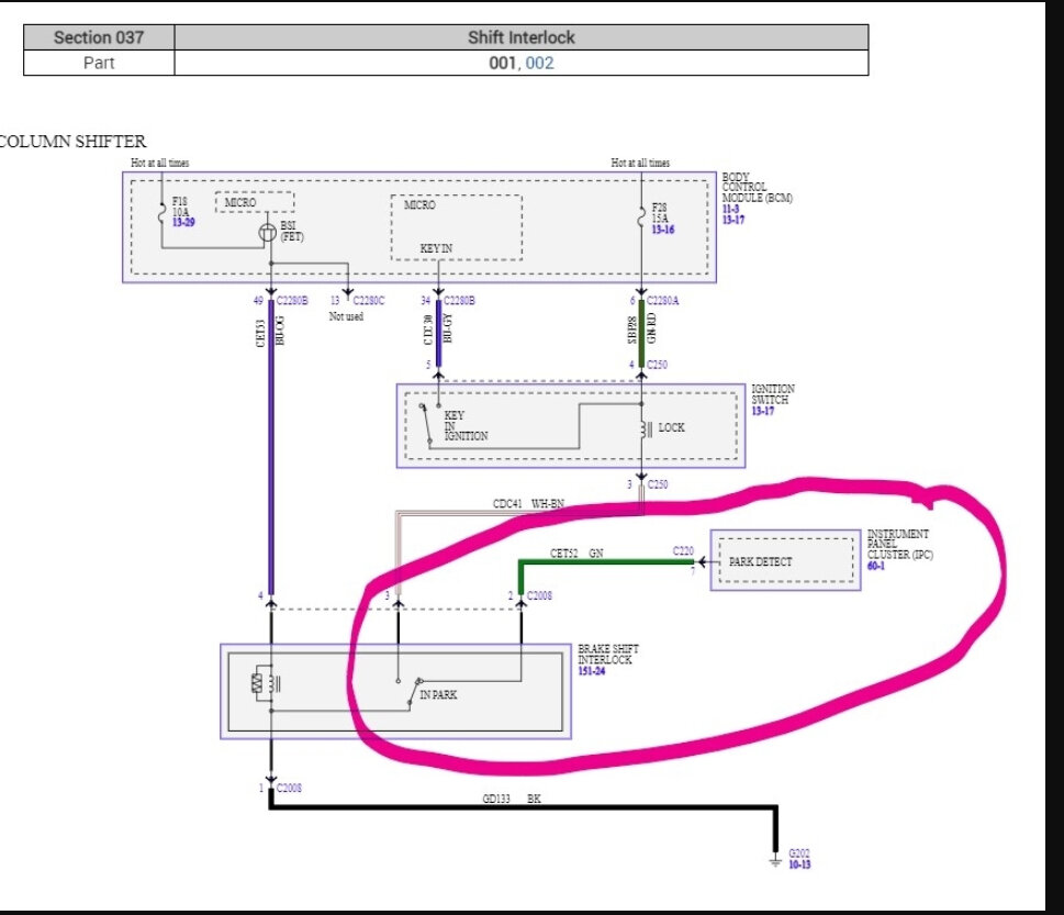

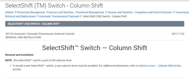

I cannot find my neutral safety switch on my truck listed above xlt. The code popping up shows neutral safety switch but where google shows its located, it is not there. I need help finding it.
Jan 21, 2023 at 10:58 AM
  • 55,808 POSTS

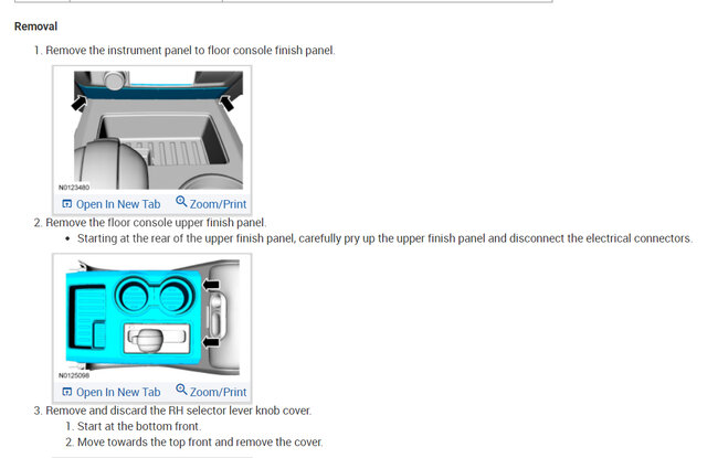

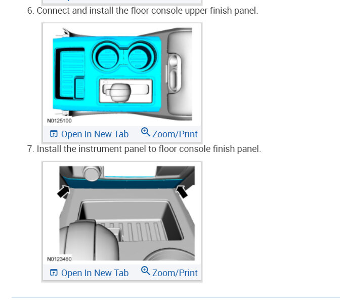

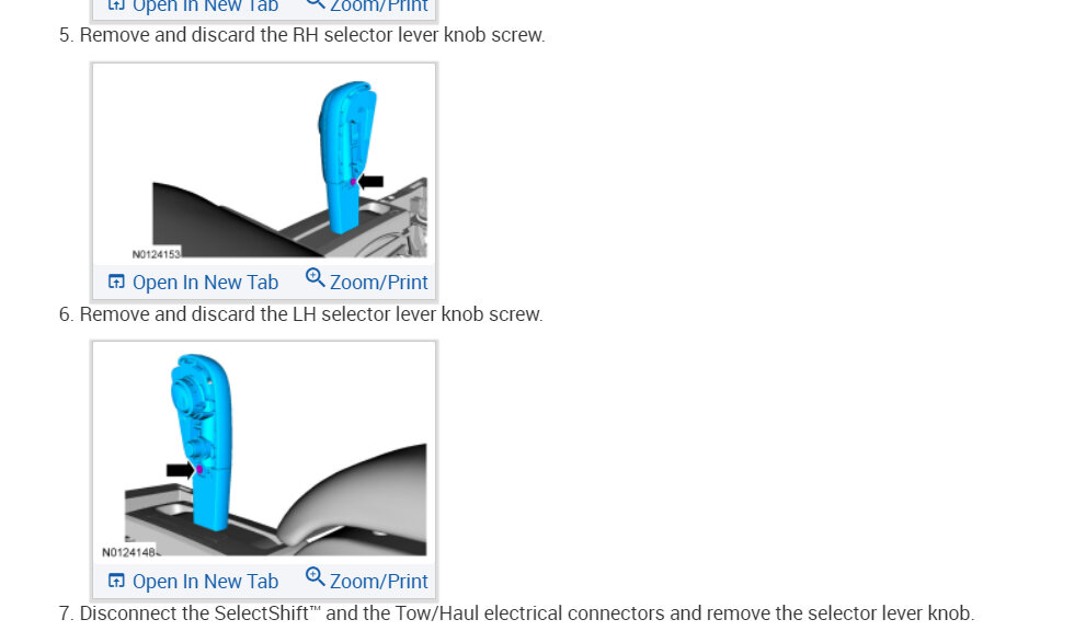

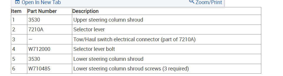

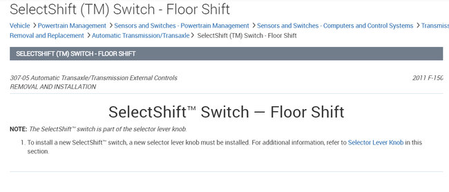

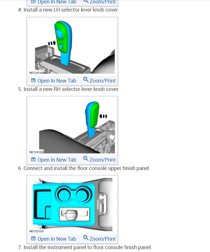

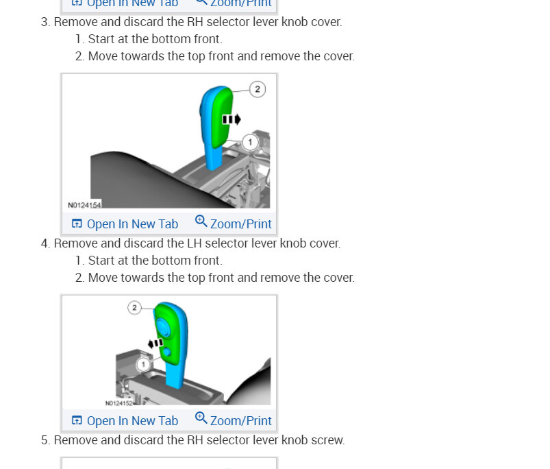

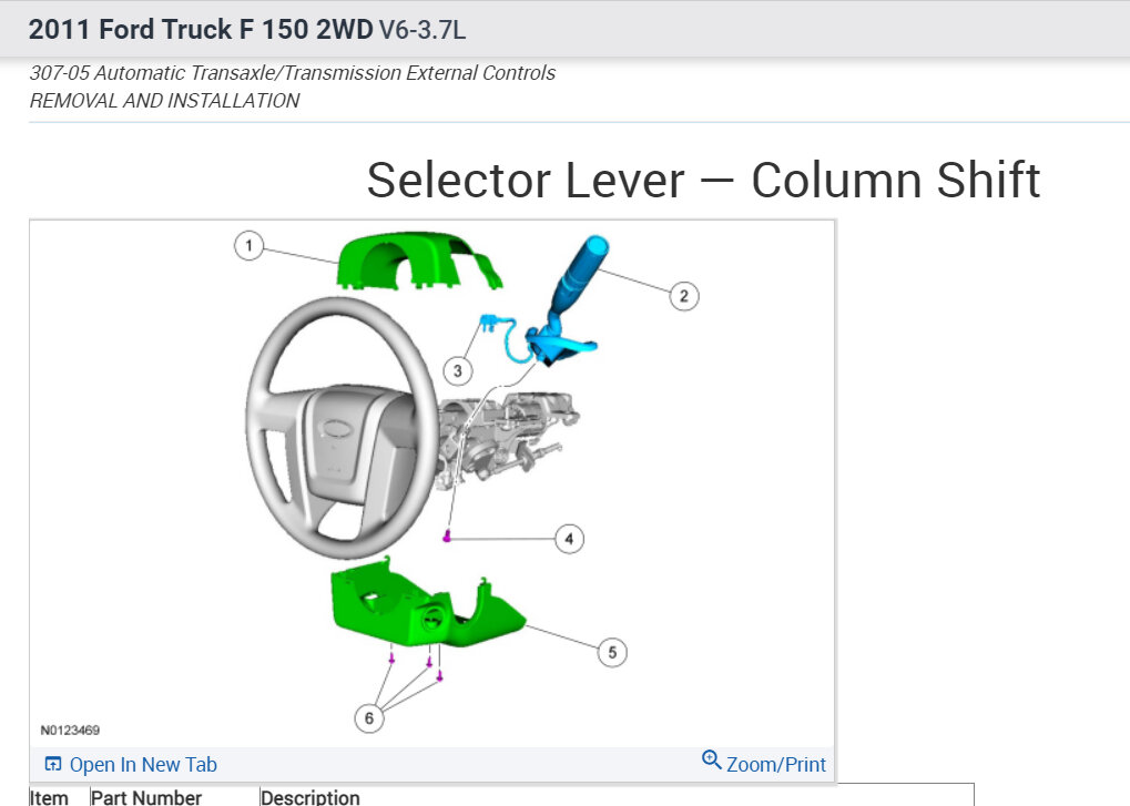

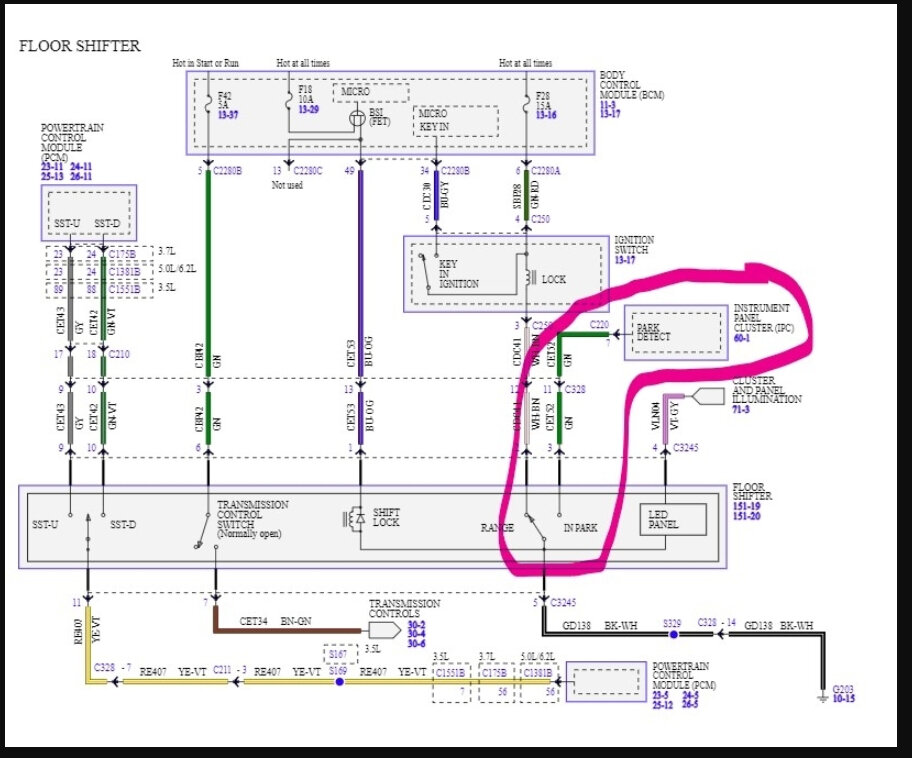

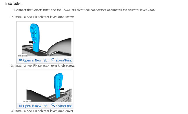

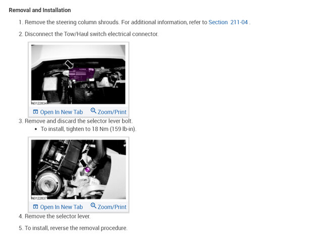

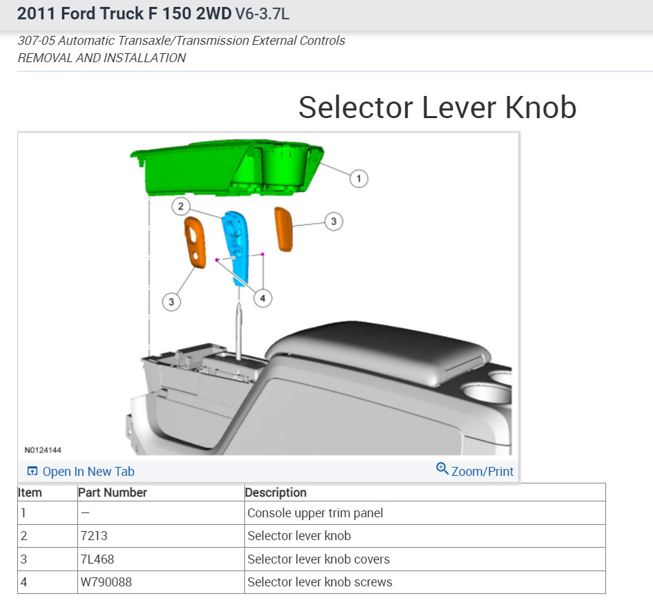

Yep, that's a good one alright, it says is the shift knob or column shift. I will put this to our other experts to see if they know what's going on. It is not on the left side of the transmission like a typical set up. Here is what they show in the images below. It looks like it is the BCM that controls the reverse light and starter operation.
Jan 22, 2023 at 5:31 AM
STEVE W.
  • 15,421 POSTS
Both floor and column shift the park switch is internal to the shifter and functions as the park and starter interlock switch. Because of the way they work you also cannot shift into neutral for a restart while moving either. If the switch fails you replace the shift lever module in either case.
