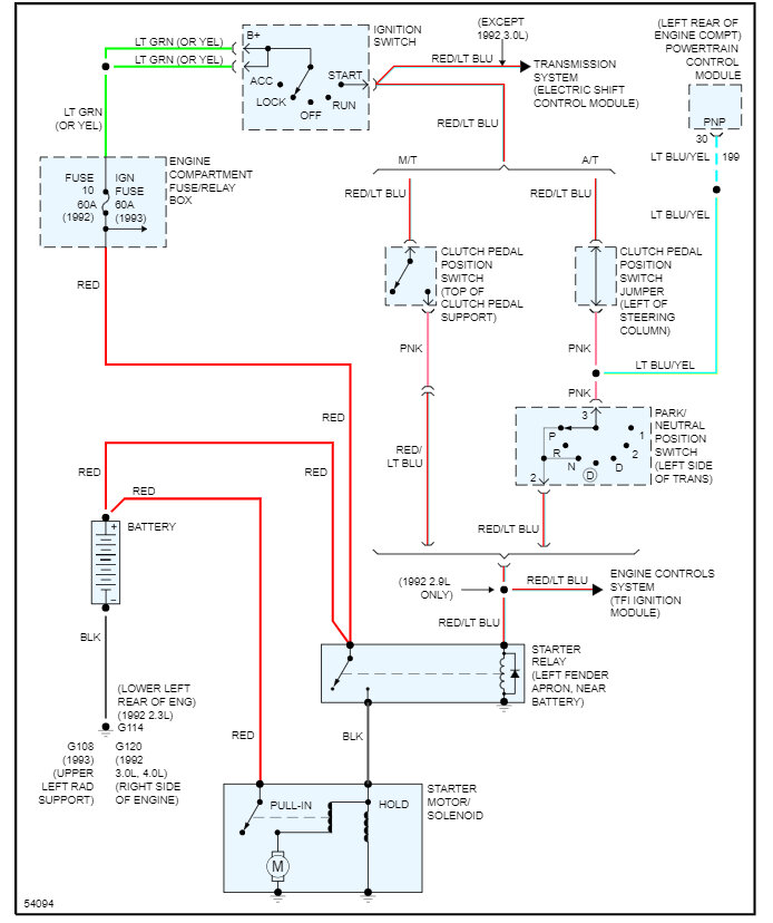

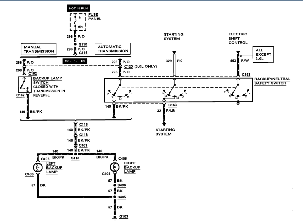

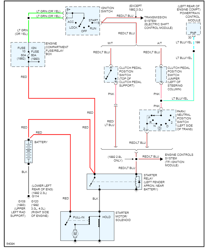

Need to know which wires under hood plug go to neutral safety switch.
Apr 9, 2023 at 4:02 AM
Experienced Mechanic
55,456 POSTS
Sure, here are the wiring diagrams and a guide to help you check the connections:
Check out the images (below). Please let us know if you need anything else to get the problem fixed.
