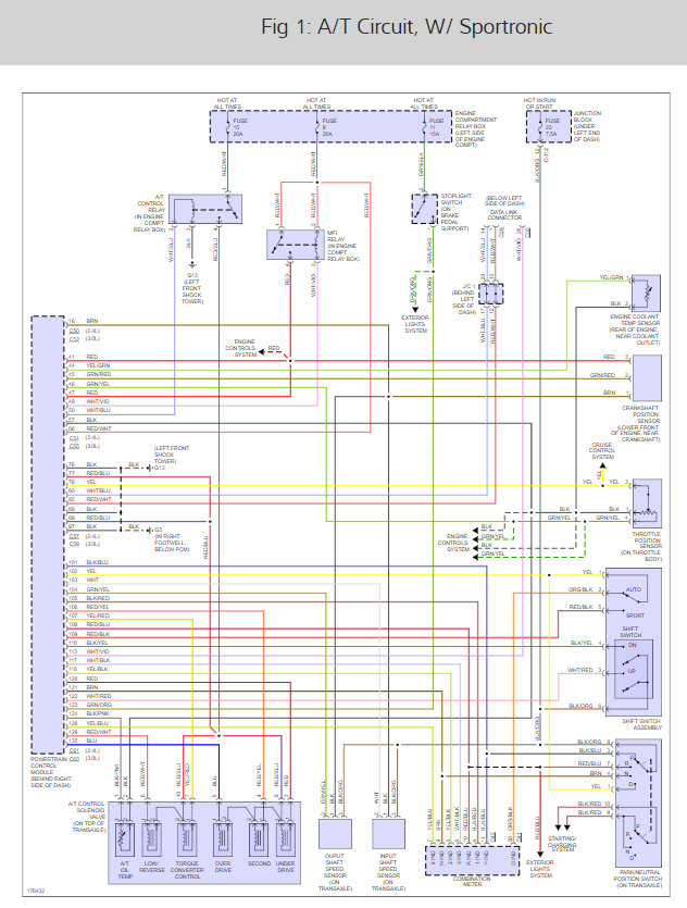

The wires got ripped out of plug on accident. Need to know where each wire goes.

Here is the transmission and gear selector range sensor wiring diagrams.
Image (Click to enlarge)
