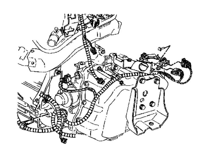

Good morning,
I attached the procedure for you for the replacement of the switch. It is on top of the transmission.

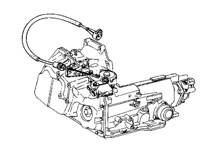

5. Remove the automatic transaxle range selector cable from the PNP switch.

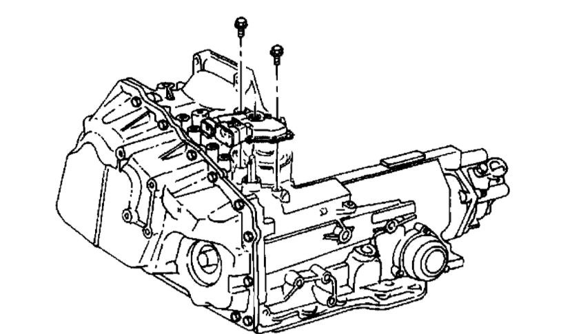

7. Remove the automatic transaxle range selector lever nut.
8. Remove the automatic transaxle range selector lever.
9. Remove the PNP switch bolts.
10. Remove the PNP switch.

2. Align the flats of the shift shaft to the flats in the PNP switch.
3. Install the PNP switch to the mounting boss.
4. Install the PNP switch bolts.
Tighten the bolts to 25 Nm (18 ft. lbs.).

8. Install the automatic transaxle range selector cable to the PNP switch.
