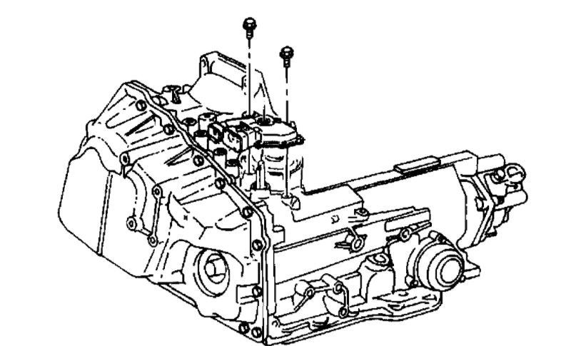

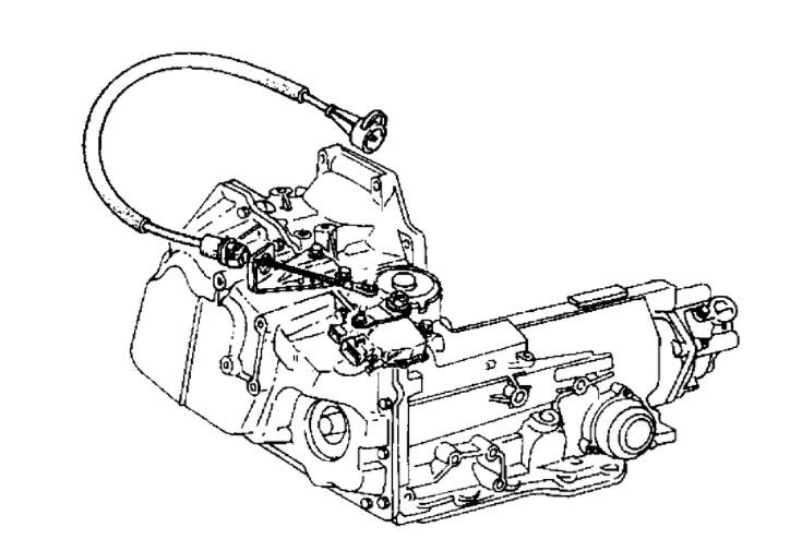

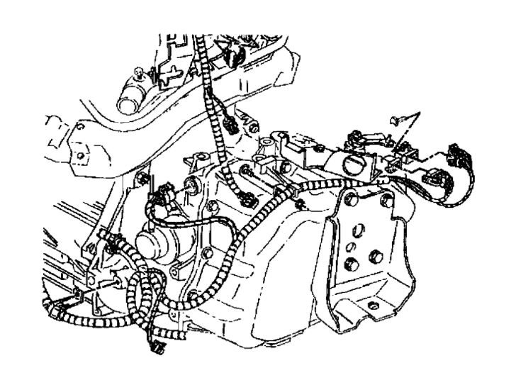

Good morning,
I attached the procedure for you for the replacement of the switch. It is on top of the transmission.
PNP Switch Replacement
Removal Procedure
1. Apply the parking brake.
2. Block the wheels.
3. Place the vehicle is the Neutral position.
4. Remove the air cleaner intake duct. Refer to Air Cleaner Intake Duct Replacement or Air Cleaner Assembly Replacement.
5. Remove the automatic transaxle range selector cable from the PNP switch.
6. Disconnect the PNP switch electrical connectors.
7. Remove the automatic transaxle range selector lever nut.
8. Remove the automatic transaxle range selector lever.
9. Remove the PNP switch bolts.
10. Remove the PNP switch.
Installation Procedure
1. Verify that the shift shaft in the Neutral position.
Important: DO NOT ROTATE A NEW PNP SWITCH. A new PNP switch is pinned in the Neutral position. If the bolt holes do not align with the mounting boss on the transaxle, verify that the shaft is in the Neutral position.
Adjust the PNP switch if the new switch has been rotated and the pin is broken or if using an old PNP switch.
2. Align the flats of the shift shaft to the flats in the PNP switch.
3. Install the PNP switch to the mounting boss.
4. Install the PNP switch bolts.
Tighten the bolts to 25 Nm (18 ft. lbs.).
