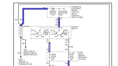

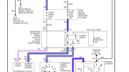

I just changed the neutral safty switch in my buick. it was brand new but it still will not start. it has a brand new starter also. is there anything else it could be i just spent 2 to 3 hours checking all connections. what else is there for me to test. oh and all the accessories come on so i do not think it is the ignition key. please help....

Hi ithigar, Welcome to 2carpros and TY for the donation Sounds like the engine will not crank-Battery and connections are okay if so-you have replace the N/P switch and the starter-what's left here now is the crank relay, fuses and the ignition switch-See starting system EWD
