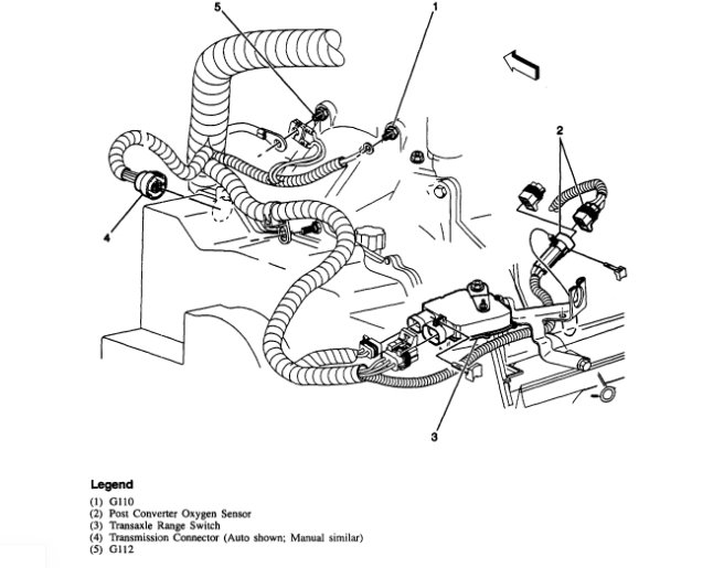

Having a problem removing neutral safety switch.

Remove the 15mm nut on the shift linkage and then the connectors for the neutral switch. Remove the attaching screws and lift it up and off.

Somewhat. How do you remove the mount on neutral safety switch?

Just remove the 2 attaching bolts. I attached a picture of the screw locations.

The shifter linkage mount binds the back bolt?

You must remove the shifter linkage first.
